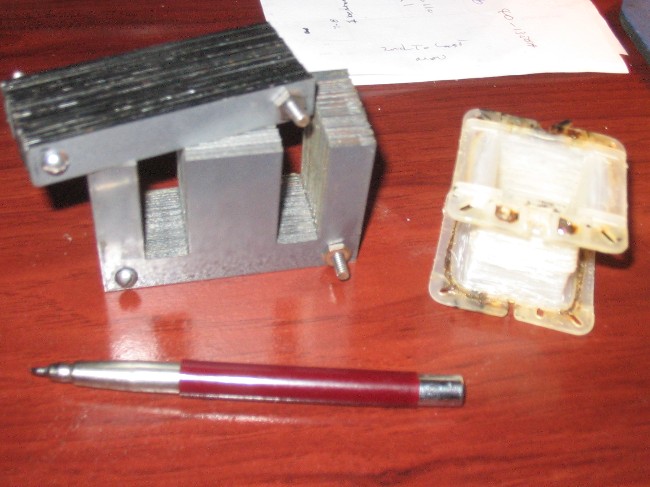

Without this info it is near impossible to design an amp I would say....I would like to build a one tube bedroom amp for my son to learn on.....I have gutted a burn't 220VAC-110VAC 100W TX for the core...bobbin is reusable so I can do the B+ with this....push comes to shove I can wind it as an isolation TX for appx. 189 VDC.
I've got to make all the gear from from stuff I can scrounge.....I will go to a TV repair shop shortly to see if a tech will sell me a torched tube set so I can accumulate some stuff.
