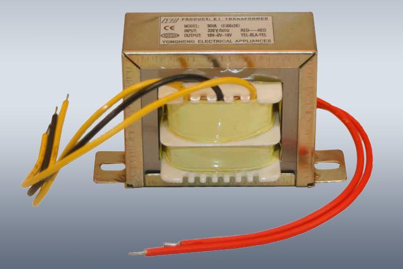

I have already a 12V mains transformer at hand that I would like to use initially.
I like EI type because I understand they have a better suppression of high Hz mains noise, the Achilles's heel of many single chip regulators.
I also see that many commercial high quality linear power supplies come with EI transformer.

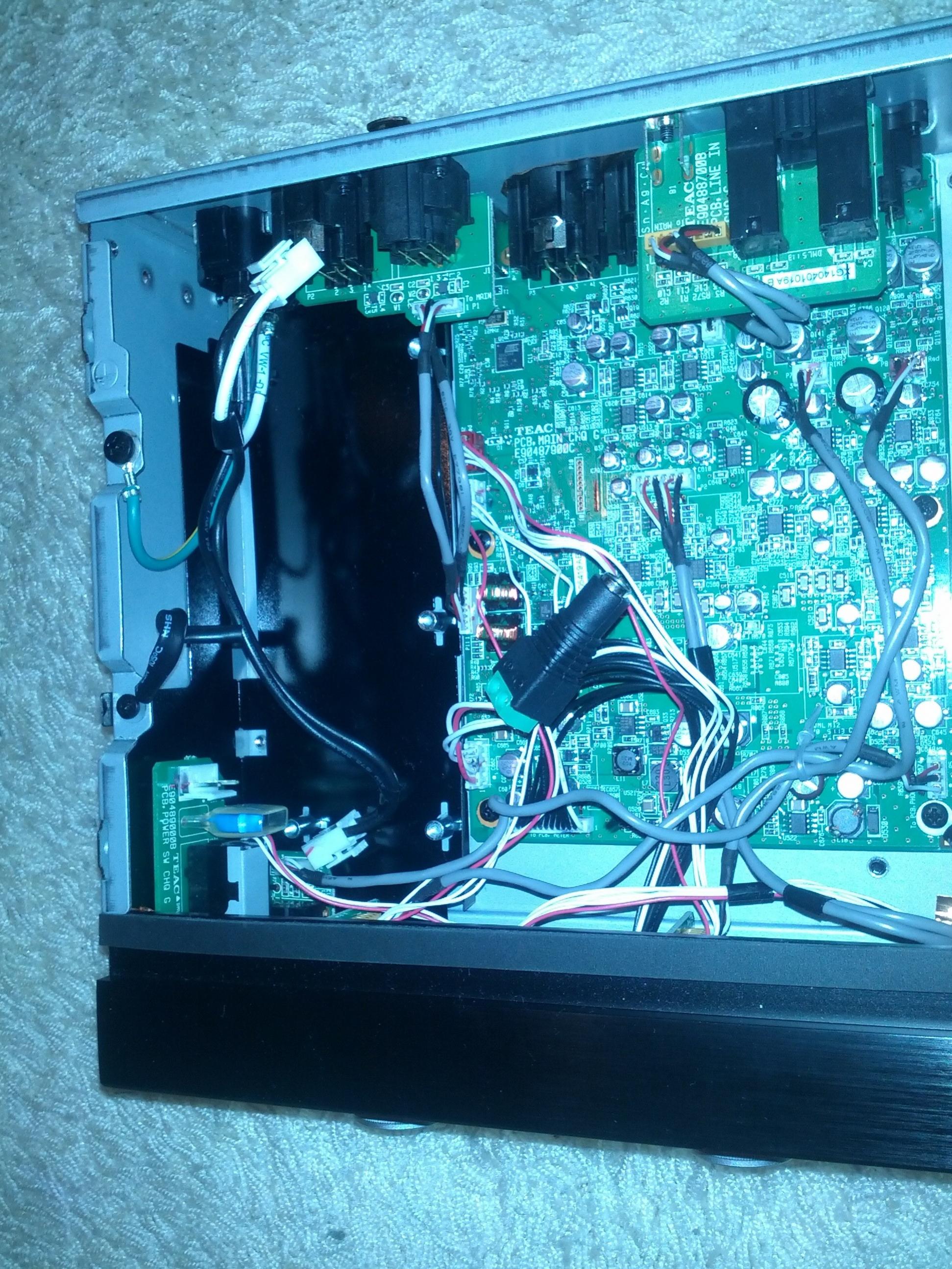

what DAC are you gonna feed ?
Hi !
it is not a diy unit but a commercial usb soundcard.

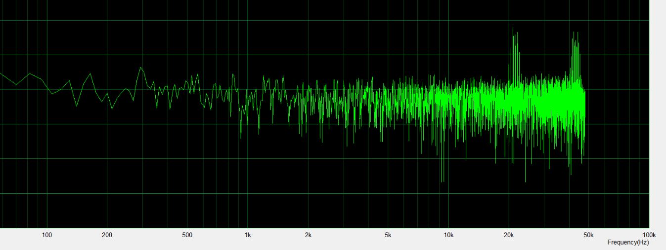

The noise issue has been highlighted by a review with some lab measurements.
The stock smps shows some noise issues (see picture)
Others have already replaced it with linear ones or better smps.
Main problem is that space inside is very tight (see picture)
So the idea is to use an external new psu.
Kind regards, gino

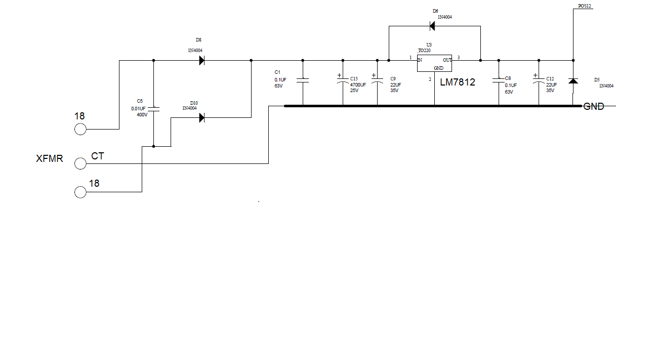

This may help...My assumption is that your xfmr is 18-0-18 (0 corresponds to the center tap). That voltage is probably a little high, but it would work fine given enough heatsink on the LM7812. You may have to go up a bit on the voltage rating for the 4700 uF cap, to 35 volts, to have more margin given an 18-0-18 transformer.

This may help... My assumption is that your xfmr is 18-0-18 (0 corresponds to the center tap)
Thanks again. I see you recommend the LM7812 as regulator ?
However i am very willing to buy a new transformer with a voltage better suited. I have already seen cheap 12VAC on ebay.
I see it as an investment. I am going to use it for some time.
Regards, gino
7812's do just fine. Some people like fancier stuff, s a perfectly reasonable way to get going.
The transformer will be ok...It's hard to say what really comes out of it without a good model. Heck...start with that one...you can measure the bulk DC at some point and pick a bit lower transformer voltage, maybe 14-0-14.
You just need to make sure there's enough heatsink on the 7812.

Thanks a lot again. Fixed voltage regulators are indeed very convenient.
One thing i have discovered is that many circuits have indeed a very good PSRR
so maybe extreme sophisticated power supplies are not always needed.
