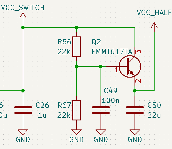

I'm looking for a simple schematic for a voltage regulator which regulates to half of input voltage. It should be small and using less idle current.
A simple schemtic would be
But the problem is that if the current on VCC_HALF is changing then there will be a voltage drop since the transistor does not regulate well and there is still some voltage drop due to Vbe voltage.
Other possibility would be to use an OPAMP but designing a voltage regulator with an OPAMP may not that easy since for capacitive loads it may become unstable.
Does someone know other possibilities how to regulate to half of input voltage or a version with an OPAMP which can handle some uF of capacitive loads.

Lower the two 22k resistors to under 10k, add two diodes (1N4148) in series with R67 and make Q2 a Darlington (TO126/TO220 case style).
Plus Nigel's advise.
All excellent points, dreamth, PRR, Citizen124032, Osvaldo, and Nigel. But 'what voltages', me wonders? The rail-splitters are plenty easy to implement, and both Source and Sink well. But we need to know voltages, and current requirements, before reasonably sensible solutions can be offered.
Also, the FMMT617 may not be the best choice if you keep this circuit. Like a lot of Zetex products, the current gain is excellent. But low Vce(sat) values sometimes sacrifice absolute current gain for the better Early gain values.

The base of that transistor will need more current as emitter current increases too, dragging down the flimsy voltage divider.and there is still some voltage drop due to Vbe voltage.

So decreasing the 22k will make regulation better but increases quiescent current. I played with Darlington in spice simulation but this will not help much also changing the npn transistor to other types will not give much improvement. The offset should be less then 100mV when current changes. Adding diods in series I need to check. Are there alternatives to the TLE2426, seems to be a quite old device?

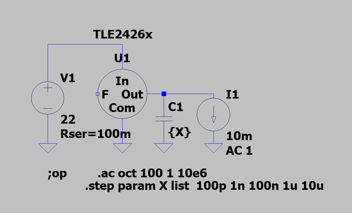

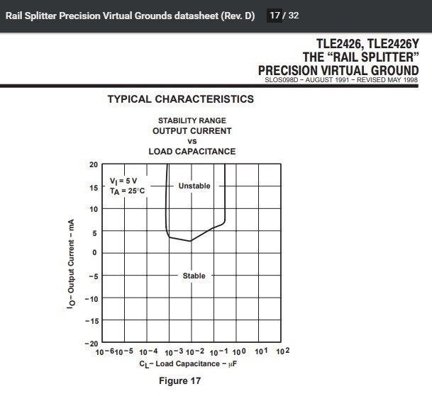

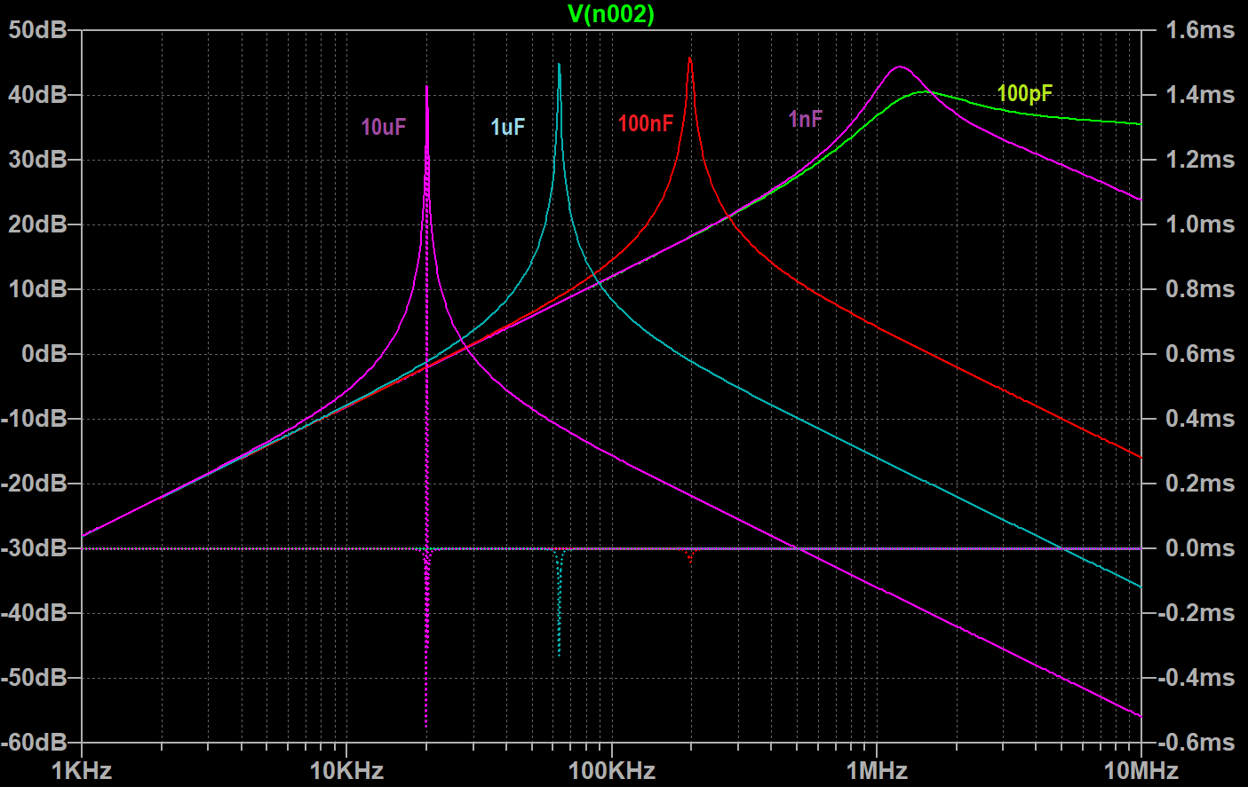

There is one teeny thing that sometimes crosses up new TLE2426 users -- there's a relationship between load current and load capacitance that needs to be respected.
Regards
Regards
Indeed!There is one teeny thing that sometimes crosses up new TLE2426 users -- there's a relationship between load current and load capacitance that needs to be respected.
Regards
Thanks for that, I have already seen this. With two 4.7uF capacitor to GND and VCC should set it out of the unstable region.There is one teeny thing that sometimes crosses up new TLE2426 users
