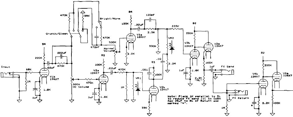

I decided to go with a tube pre and SS power section. After scouring through countless articles and schematics, I found this interesting circuit for the Soldano SLO.
The question is, what exactly are VR1 and VR2? Those parts of the circuit are mentioned in the commentary (second link), but it is unclear to me. I do not know if there is a regulation circuit somewhere, or the LED is just symbolic of what the writer is talking about.

The leds are housed along with a cadmium cell that changes resistance with the amount of light. Good for isolation or a simple way to control resistance by some other means.

You can always wire in a pot of the same value and adjust it manually. What controls the leds?

VR1 & 2 are used to switch the overdrive circuit in and out of circuit. When the footswitch is pressed, it lights up the led's in the VR1 & 2.
The two LDRs - VR1,2 - have a high resistance when dark, and they go to a low resistance when lit up by the LEDs. One of them thus shunts the signal to ground when lit, while the other completes a signal path in the other channel. The two LEDs are probably wired in series to operate together. So when they are darl, that one shunt disappears, and the signal path above opens. SO light or dark alternates channels. YOu could replace them with a pair of relay contacts, I suppose.

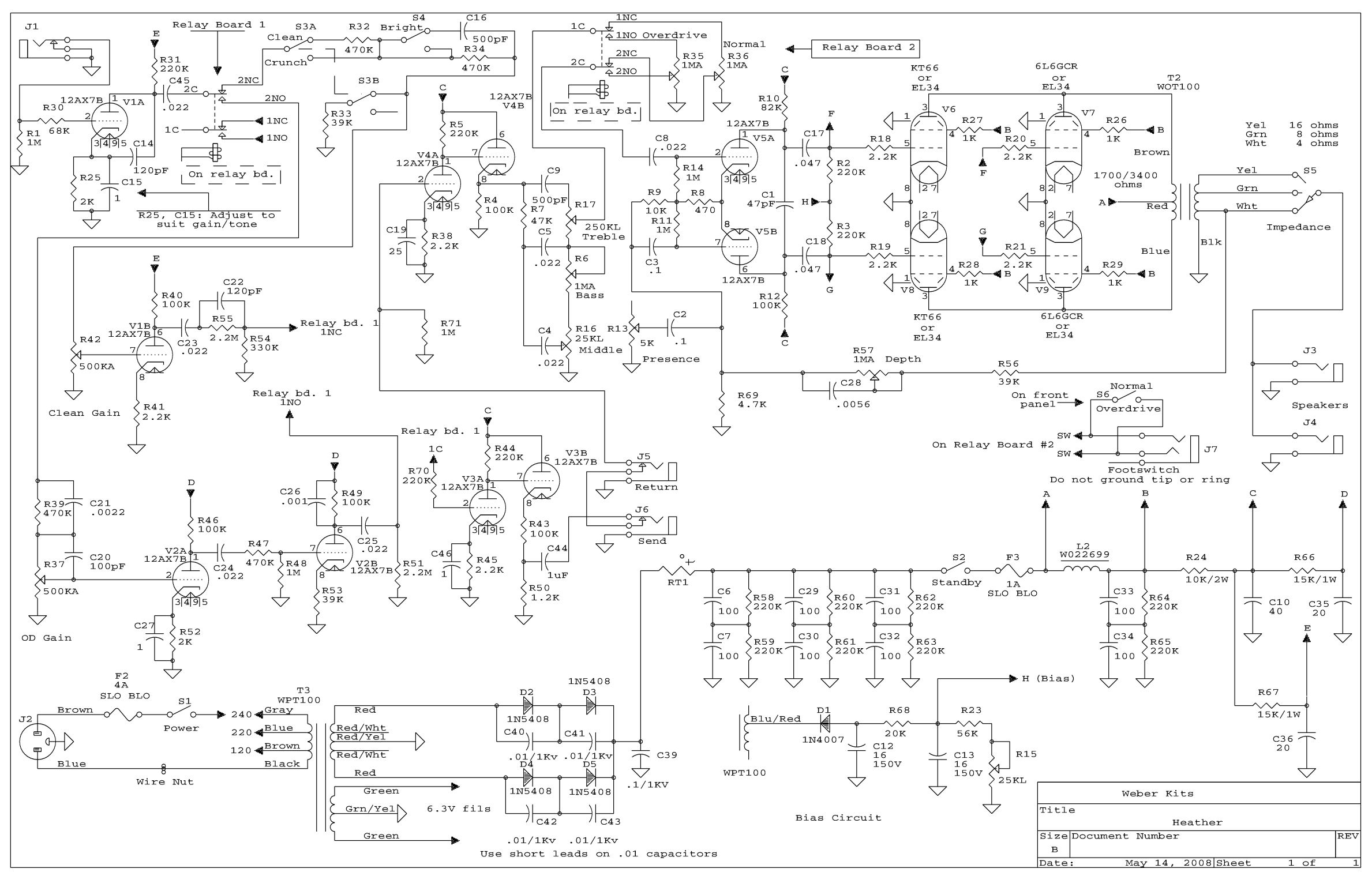

Thanks. When I checked the price of those LDRs, I sought an alternative. I found essentially the same circuit that uses relays. This is better for me since they can be easily replaced with digital switches, if desired, somewhere down the line. Plus the circuit is easier for me to understand.
But I am not given the HV output number. I have seen several lead amp designs ranging from 300-480v., which I find shocking. What the heck, here it is. Maybe someone could ballpark it.
