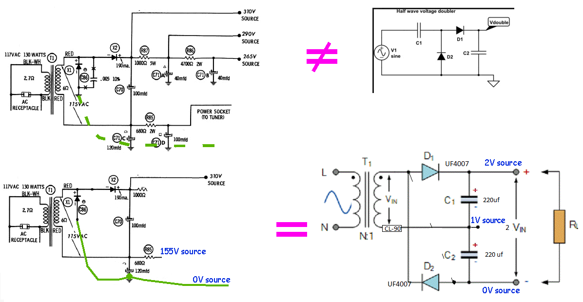

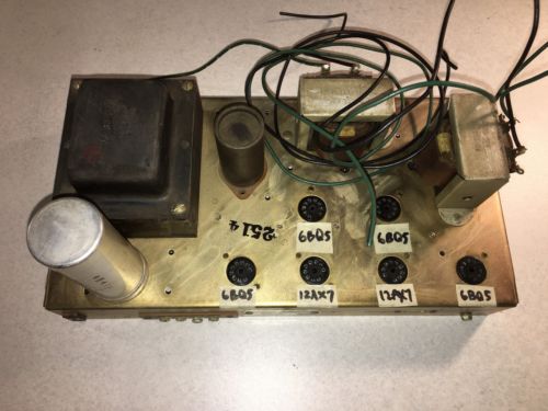

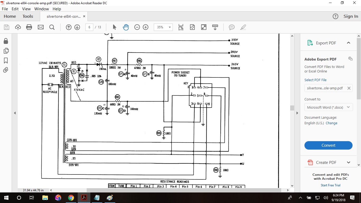

I've got several tube amp builds under my belt and feel I understand the electronics behind them pretty well, but I'm encountering some circuitry I haven't seen before in the power supply of a vintage console amp I'm rebuilding. I've attached a picture of the power supply schemtic.
1. Practically speaking, the most important thing is understanding the grounding of the bottom leg of the PT secondary. I'm not using the output power socket for the tuner, so can I just omit R85, C71, and that's it. Does the circuit complete via C71 to ground with the 310 volts generated at the first stage? All of the circuts I've worked with have grounded 1 leg of the PT directly. Or do I need to rework that slightly? Perhaps just connect the + side of C71 to the - side of C70 floating, and ground both the negative side of C71 and the PT secondary bottom leg to the chassis?
The rest is theoretical, but I'd greatly appreciate an explanation.
2. Is the 310 volts achieved from the 115v secondary via diodes X1 and X2 and C86? I've researched half wave voltage doublers extensively, but could not find an example where the capacitor was in parallel with a diode to ground. They all look like the attached version, whose operation I do understand.
Thanks!
Joe

You will improve performance by converting to the "full wave" doubler set up. Both transformer efficiency and ripple frequency are implicated. While not truly full wave, the so called full wave doubler does utilize the entire AC waveform and the ripple freq. is 2X the power line freq. OTOH, the 1/2 wave doubler exhibits a ripple freq. = to the power line freq.
Getting rid of unused stuff makes sense to me.
C86 is a snubber (switching noise suppressor). Replace the OEM diodes with much quieter UF4007s. A high WVDC 0.01 μF. cap. connecting the junction of the UF4007s and power trafo to ground will eliminate most of whatever switching noise is produced. Inserting a CL-90 inrush current limiter in the line connecting the power trafo to the center of the doubler stack simultaneously deals with today's higher average AC mains voltage, while allowing for a safe increase in the doubler stack cap. value to 220 μF.
Phase the 2 filament windings up and connect them in parallel. It may be necessary to add some resistance here, in order to deal with today's higher average line voltages. 6.3 VAC +5%/-10% rarely gives you grief.

....understanding the grounding of the bottom leg of the PT secondary. I'm not using the output power socket for the tuner, so can I just omit R85, C71, and that's it. ...
No!
There are two "doublers". The snip you posted is NOT equivalent to what is in your amp. It is already the "full wave" form you have been recommended. C71 is vital.
If you do not need the half-voltage feed for tuner, just snip R85 onward. You probably do need something like the R87 R86 chain for whatever you are building.
Without the tuner load, C70 C71 "should be equal", for penny economy and elegance. If these caps are good, let them stay 100 and 120. Since these caps are surely quite old, use new 220u both places.
I see no real reason to add surge limiting. It has worked this way since 1961. There is 9 Ohms in the PT, the peak surge is 13 Amps, which is not the least strain on wiring or PT. A more complete study says 8A peak first cycle, 2A peak by the 3rd cycle, falling to 1.6A peak 0.6A RMS. It surge-starts easier than a 100W incandescent lamp.

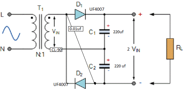

So end result should look like the attached modded doubler mock-up?
Joe
Don't forget to ground the negative end of the doubler stack. Of the original PSU, only R87, C71A, R86, and C71B are retained. Increasing C71A and C71B to 68 μF. rates to be a good idea.
Finally, add a proper, 3 wire, safety grounded, power cable and primary side fusing.
Leave the 0.005u there. I omitted it for clarity. I suspect it is more to do with the radio function than anything else. It has no big effect on making DC. As long as it does not short, it does no harm.

There is one other thing that separates this from my builds so far, the lack of a center tap on the heater winding. Is that worth adding (100 ohm resistors on each leg) and, if so, maybe connect it to the cathode voltage on one of the power tubes (assuming it wouldn't create an imbalance between the channels)? My other hi-fi build is a vintage Mullard 3-3 circuit (single ended mono) and they were adamant about this strategy as a way to keep noise to a minimum. Insights always appreciated.

If you take the "full wave" doubler path, 2X of this cap. will make an excellent doubler stack. This part will serve well to snub the UF4007s. You can take advantage of the existing holes in the chassis to clamp mount snap in 'lytics.
"Synthesizing", via 2X resistors, a CT for the phased up filament windings is a good way of killing 2 birds with 1 stone. You create a grounding point and (by adjusting the resistance value) compensate for today's higher average AC mains voltage.

Snap in parts for the doubler stack are fine. As a belt and suspenders thing, put some additional insulating material between the doubler caps. and the mounting clamps. Neither end of the doubler stack's upper cap. is at ground potential.
IMO, you don't need voltage equalizing resistors across the doubler stack. A little extra B+, if present, will not be troublesome. Filament (heater) voltage is another matter. Keeping it within -10%/+5% of nominal makes for "a warm, fuzzy, feeling".
The stacked B+ caps do not need equalizing; the rectifier "forces" them to be the same.
(A little off if you suck tuner from mid-point, but not much, and you say you won't.)
One of the heater windings *has* two 100r resistors to ground. Just not drawn clearly. (The whole thing is obviously SAMS, where neat detailing trumped easy understanding.) Unless you have a seriously sick heater, 2*100r is just as good as a CT.
