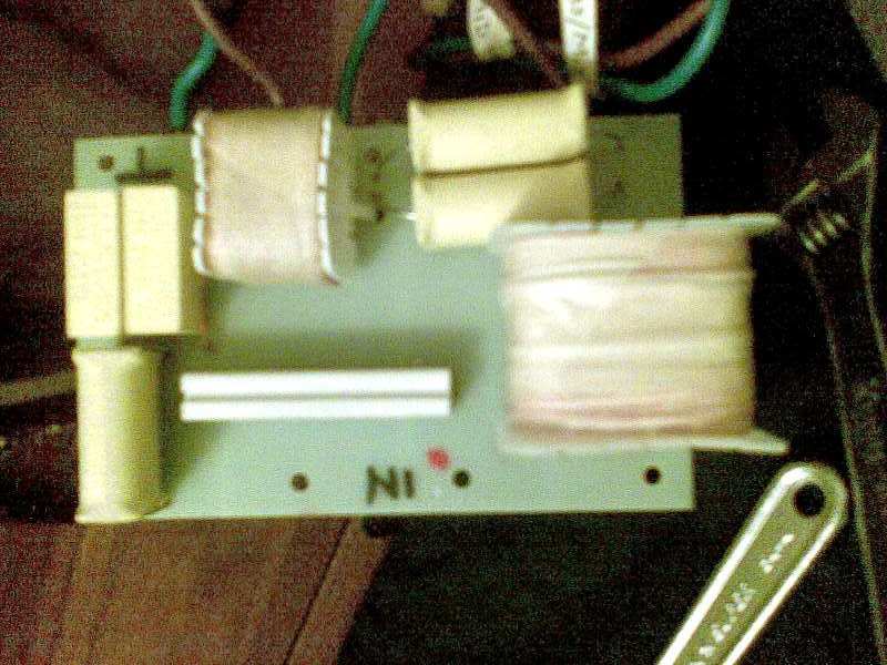

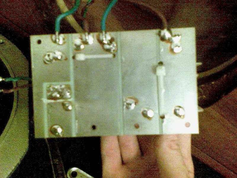

Here is a picture of the crossover, cant seem to work out the schematic 😕
The bottom shows the connections (rotated and flipped) 😱
I believe that it shows the tweeter out of phase? so should it be wired at the tweeter in or out of phase?

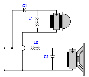

Hi Rob. It's a type 2Way 2nd order xover with a resistor before C1 on tweeter. I don't know what is after C1 (box/rele? look alike, can't see). The phase is very much related with distance in the front baffle between drivers and xover frequency. It can be one or the other. Sometime ago we were checking this same problem in another manufacturer (ATC?) with both connections or different setups.

C1 = 2u2 (2.2uf??)
L1/L2 = not marked
C2 = 2x 2u2 (2.2uf??)
R = 2r2 (2.2 Ohms??)
After C1 it goes to the coil and 2x 3.3uf capacitors.
On the crossover, the right hand side is the mid/bass and the left is the tweeter

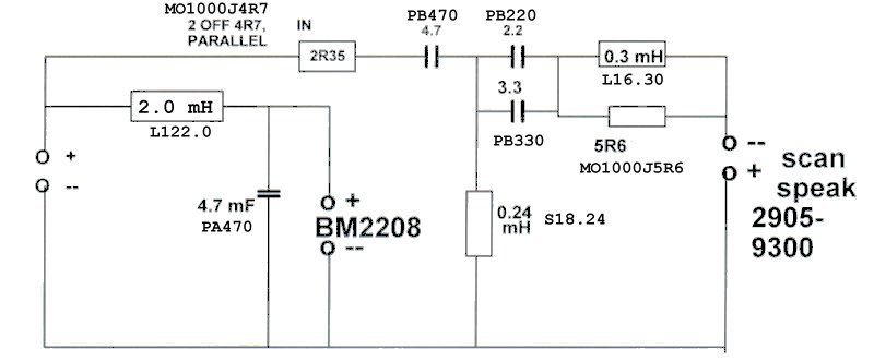

We have:
Volt BM220.8 (Volt BM220 'DS' version is used, is it the same/similar?).
Scan Speak D2905/9300 https://www.madisound.com/store/product_info.php?products_id=910
You go to this xover that is used with similar drivers

Yes, i had seen both the Solen HSM kit and the old Wilmslow Audio HSM kit use both the SS 9205/9300 and the Volt BM220.8, they are also 3rd order on the tweeter and 2nd order on the bass, and both around 33L cabinet design as well. I have fired off an email asking if they know of the differences between the older BM220'DS' and the newer BM220.8 and if the crossover design would be suitable.
