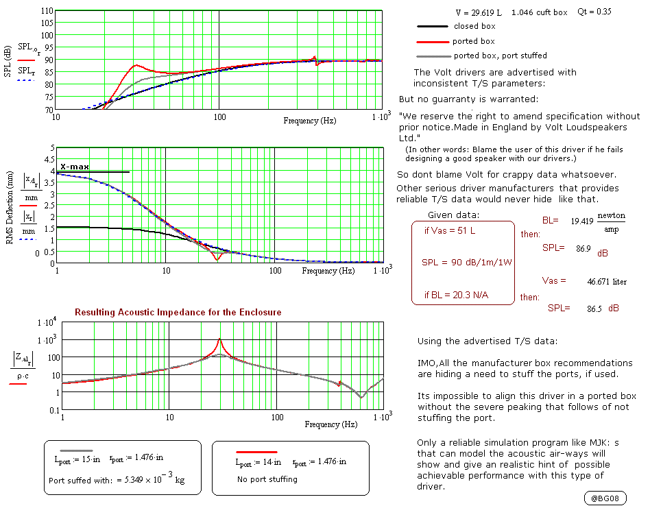

Ok i want an enclosure for two Volt B2500.1's link to specs
A sealed doesn't really give enough low freq response. I've had a play with TL's and its seemingly impossible to do one for two drivers. (without having them side by side).
I've ben playing with winisd to get a ported design. Now i'd like to steer away from the trates of typical ported "boom" boxs and have minimal group delay, port noise and excursion whilst retaining a fairly flat freq response.
The two boxes i have come up with are:
Yellow = Sealed
Red = 1.046 cuft tuned to 29.5 Hz
Blue = 1.343 cuft tuned to 34.75 Hz
Now the freq response of the blue is slightly better. But the red one has better group delay, port velocity and cone excursion.
My only worries are that these are way different to the suggested enclosures. Do they seem alright to you guys, and would you suggest anything different?

I would go with the red curve. Don't worry, your design is not actually off the manufacturers mark, see they specify designs from 20 litres to 70 litres. Yours simply falls inbetween the three alignments they chose to present.

...My only worries are that these are way different to the suggested enclosures...
Maybe there are more serious reasons behind other suggestions than to be close to the manufacturers incomplete recommendations.
Says who?
Me and many others have been satisfied that choosing a point along the line and then using it as the acoustic mean to place the drivers vertically above/below since it seems reasonable that they would average out 'good enough' and IIRC MJK proved it mathematically awhile back for the skeptics. After all, what's the difference between two separate sources or one oblong one WRT pipe action?
Just so we're clear, this doesn't apply to drivers positioned as you originally considered, only to drivers closely coupled, i.e. butted up against each other.
