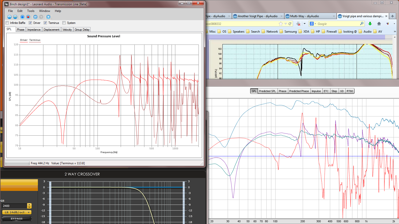

I changed the driver to a OEM driver with a light paper cone (12 grams) as the effect of resonances shows up more the lighter the cone is.
I tried felt damping using two pieces of felt 170x390x10mm. They were placed across the pipe at either as indicated by the blue line separating A and B compartments or the B and C dito.
Lets start with the pipe output
1. No felt = black line
2. Both at AB= Blue
3. One at AB one at BC = Green
4. Both at CB= Orange
Results
2. Both at AB= Blue, least effective for the 130 Hz peak and the peaks above 250 Hz, but most effective for the 200 Hz peak
3. One at AB one at BC = Green (intermediate effect of 2 and 4)
4. Both at CB= Orange, the most effective at 130 Hz and above 250 Hz but the least effective at 200 Hz. Note the reduced cone output below 50 Hz.
Below the pipe fundamental the opening is shortening the driver felt curtains before the driver does nothing (1 and 2). Felt between the cone and the pipe opening add some resistive damping to the flapping of the cone ( 3 and 4).
The pipe results suggest that damping between the closed and and the driver is most effective for the 200 Hz peak but does very little for the higher harmonics as well as the 130 Hz peak.
Lets turn to the nearfield response at the fundamental
1. All felt dampings reduce the fundamental dip by 4-5 dB, there is no free lunch.
2. At 30 Hz two layers of felt behind the cone (orange) reduce the cone output by 2 dB. This is consistent with the pipe results.
Lastly nearfield response of harmonics (note the change in scale)
Blue (two layers of felt before the driver in the pipe at AB) is the best in supressing the 200 Hz peak and two layers behind the driver at BC the worst. While the latter showed far better damping of the 130 Hz peak and the higher harmonics in pipe output there is no real difference in near field response. The black line of the undamped pipe show som peaks and dips 250-400Hz but either felt combination will supress this effect.
My conclusion would be to concentrate on damping material between the driver and the closed end. With that set try out some final tweeking with material between the driver and open end.

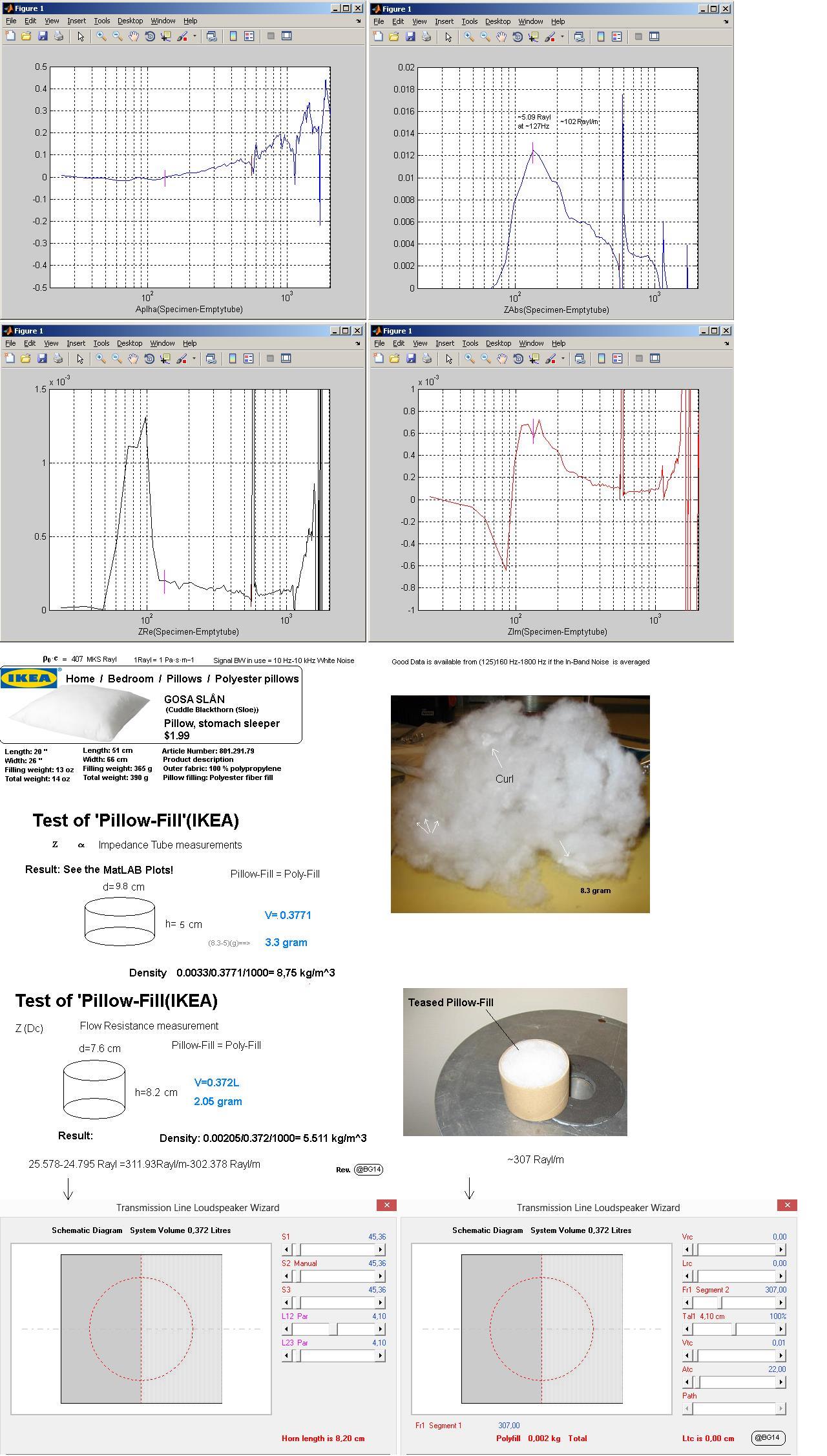

I tried 100grams of BAF in the closed end of the pipe.
Black trace=No damping at all (exept the felt as indicated in previous posts).
Brown= stuffing crammed into the first 20 cm of the pipe
Red= distributet up to 40 cm from closed end.
Yellow= spread evenly along the dividning board all the way up to the upper edge of the internal baffle, about 60 cm from the closed end.
Maximal damping should occur with damping material at the velociy maxima of the resonances so for the 5th harmonic about 35-40 cm from the closed end and the other ones closer that that. Lets start with pipe output:
The undamped pipe has severe peak and dips from 100 to 500 Hz (black)
The 20cm stuffing (Brown) helps in evening out the peaks and dips.
The 40 cm variant (Red) looks even better.
Then the 60 cm (yellow) is much worse?
How about the influcence at the fundamental resonance?
Here the 20 and 40 cm stuffing reduce the fundamental by 2 dB but the 60 cm by about 5 dB.
Then turning to harmonics
Here the differences are less clearcut. The 40 and 20 cm looks very similar and the 60 cm looks worse again but not by such a large margin.The huge 3rd harmoic at 130 Hz does little to the driver due to its location. The 200 Hz peak is the major influence and to a lesser degree the 300 and 400 Hz peaks.
The results are not what I expected perhaps it is not damping per se that is important but causing phase shifts that moves velocity minima away from the position of the driver?
With all resonances having pressure maxima/velocity minima at the very end of the closed end of the pipe, why have any damping material there at all? Should it not start 10-15 cm out from the start the ninth harmonic shuould have its first veolocity maxima about 20cm from the end and the lower harmonics even further out...
