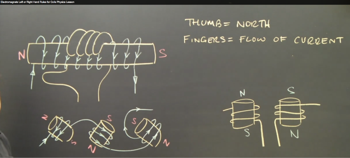

I am rebuilding two 15" subs, I have already rewound both voice coils; one SVC and the other a Dual VC, I am nearly ready to connect them to the terminals. This may sound a bit fundamental as I am new to this but which end of the voice coil wire should be your positive (+), and which is your negative (-) or does it matter? I assume the first layer wound would be the negative and outer the positive, because its closest to the magnet, and also the DVC is wired (1st coil 1st layer, 2nd coil 1st layer, 1st coil 2nd layer and 2nd coil 2nd layer) wound in interleave. Please verify this if possible!
Just my thought: it doesn't matter because it's AC.
That said, normally you want the cone to move outward when there is a positive Voltage.
Meaning when you put a battery + to + and - to -, the cone should move outwards to be in phase with other drivers.
Impossible to answer without knowing the direction of winding.
Drop the coil in the gap, apply some DC current (1.5 volt battery should do) and see which way it goes.
Normal convention is positive voltage to the + terminal makes the coil go away from the magnet structure.
Thank you for the input! To answer: the direction of the winding, I wound it exactly as it was originally factory wound; first coil in one direction and second coil in opposite direction, it seems to make sense to me, but it was very difficult to wind them inside one another as I only used a drill for spooling with a fabricated steel pipe as a spigot; after winding the first layer, I put the wire bobbin inside the pipe while I started the second coil first layer and so on, I think next time I will just completely wind the coil 1 and then wind coil 2 both layers on top of 1. My guess is that if I wind them interleaved as I first said, the coils amplify one another much stronger. Well maybe?
this is the problem.
Both coils are wound in the same direction. But the helix is in the opposite direction.
Dear 1977
This will also depend on the direction of magnetizing of the motor structure carried out by the manufacturer of your driver . Once the permanent magnetizing direction is known the B of your coil and resulting direction of coil magnetizing can be considered .
In this case the best is to carry out the battery test as suggested by everyone earlier . For your reference any regular polyester insulated magnet wire below 36 swg will not burn with a 9 v battery .
The permanent magnetizing direction and the subsequent connecting of inner or outer layer to +ve or -ve terminal will not have any effect on the wave produced , as long as the above polarity test is followed .
