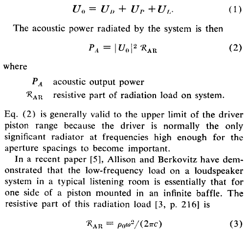

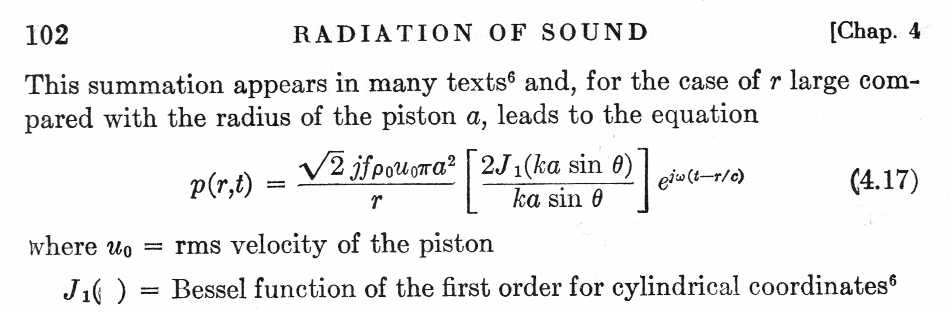

I'm modeling the SPL response. I don't follow what you're saying about there being a difference. When making the low-frequency approximation of the T/S analysis, they have the same frequency dependence.
I've attached captures from Small's "Direct Radiator Loudspeaker System Analysis", and Equation 4.17 of Beranek.
In the former, Small shows the relationship between volume velocity at the piston's surface and radiated power. This leads to the result that the radiated power is proportional to |G(j*omega)|2, where G(s) is the system transfer function.
Looking at the equation from Beranek, I assume theta = 0 for the on-axis pressure, and set r = 1 meter. The quantity in square brackets involving J1(ka sin(theta)) goes to 1 as theta goes to 0. Then you find the on-axis pressure is proportional to G(s).

I was originally refeering to karagiosis's post. It seems like you're getting the results you are expecting, so that's good.
