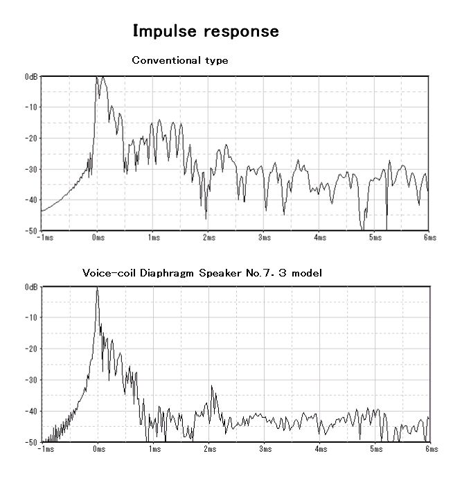

Funny how one search leads to another line of interest... I turned up this concept for driver design:
http://www.geocities.jp/adsshp/indexE.html
It looks like a lot of effort has gone in to R&D. Its an interesting idea, if a bit demanding in the magnet department.

Flat Coil ...
Unfortunately, it looks like a single-ended electrostat, meaning it will not have the balanced forces acting in it that will cancel even harmonics ... And will suffer from inverse square law non-linearity ...
since its motor structure relys on magnetic forces, it should be rather seen as a ´coiled ribbon speaker´, instead of a single-ended ESL.
But as toroid says it will be quite nonlinear because the coil is placed within the highly nonlinear strayfield of the magnets.
jauu
Calvin
ps. besides, the negative claims about ESLs on the website are false.

I think they used a PVF (poly vinylidene fluoride) film, which is "poled" by applying a strong electric field while it is solidfying.
This is a vague memory of reading some description of the Pioneer technology 30 years ago or so.
David:-
I noted the Gallo design already, designated CDT I believe. It seems to have a very good reputation. Tricky to DIY though, without access to the piezo film material and vacuum coating equipment.
torroid88
Good point about the non uniformity of the drive in the voice coil design, that could be a problem. It's a frequent criticism of some Magnepan designs, though I still love these speakers.

On the subject of 360° dispersion I also recently saw this Elac driver:
