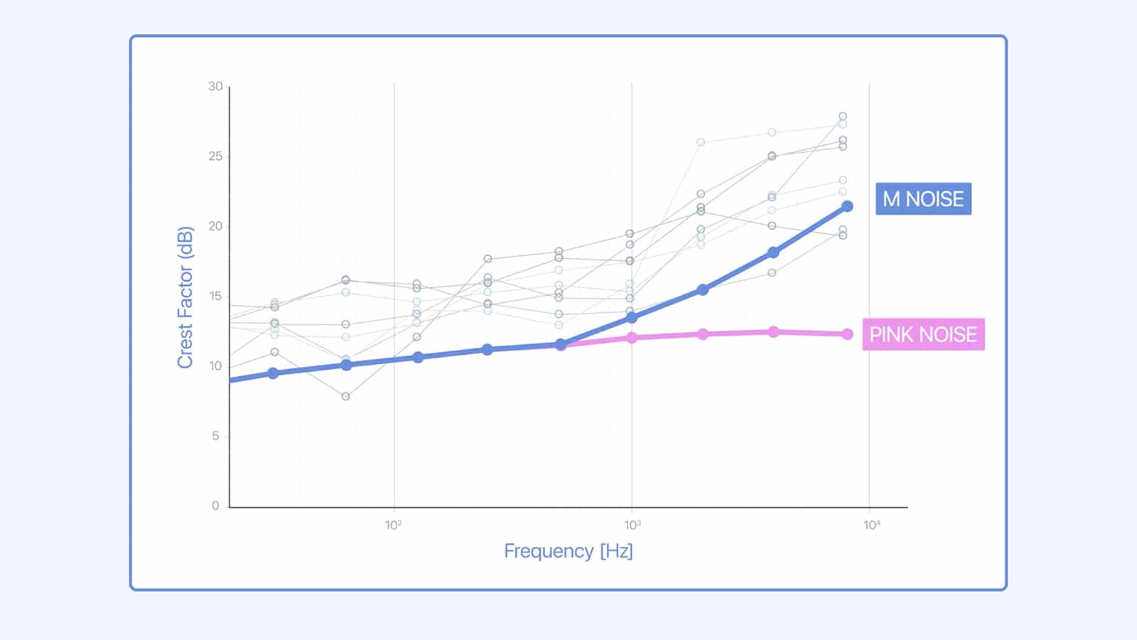

Does anyone know what the duty cycle of the pink noise is?
Around 12dB crest factor.
What is the duty cycle of normal music?
Obviously, there is a wide variance in what may be considered "normal" music, but Meyer Sound determined it to be similar to pink noise at frequencies below 500 Hz, but with music exhibiting a steadily rising crest factor at higher frequencies, approaching 20dB ~20kHz.
They developed "M Noise" (Music Noise), a mathematically derived test signal that effectively emulates the dynamic characteristics of music:
Can someone please explain this to me or point me towards a reading that can?
https://meyersound.com/news/m-noise-test-signal/
I see the pink noise options drops the wattage every component sees by a factor of about 25. This insinuates a duty cycle of about 5%. Is this about the duty cycle components see?
Sine wave has a crest factor of 3dB, about 9dB less than pink noise, closer to a 10% ratio.
I used pink noise for the source while developing a crossover ~3.5kHz, and felt the attenuation resistor for heating with my finger.
While playing music at around the same SPL, a track that had a prominent hi-hat cymbal line made the resistor heat up noticeably compared to the pink noise, demonstrating how dynamics make a difference, and how "averages" don't cover the exceptions.
