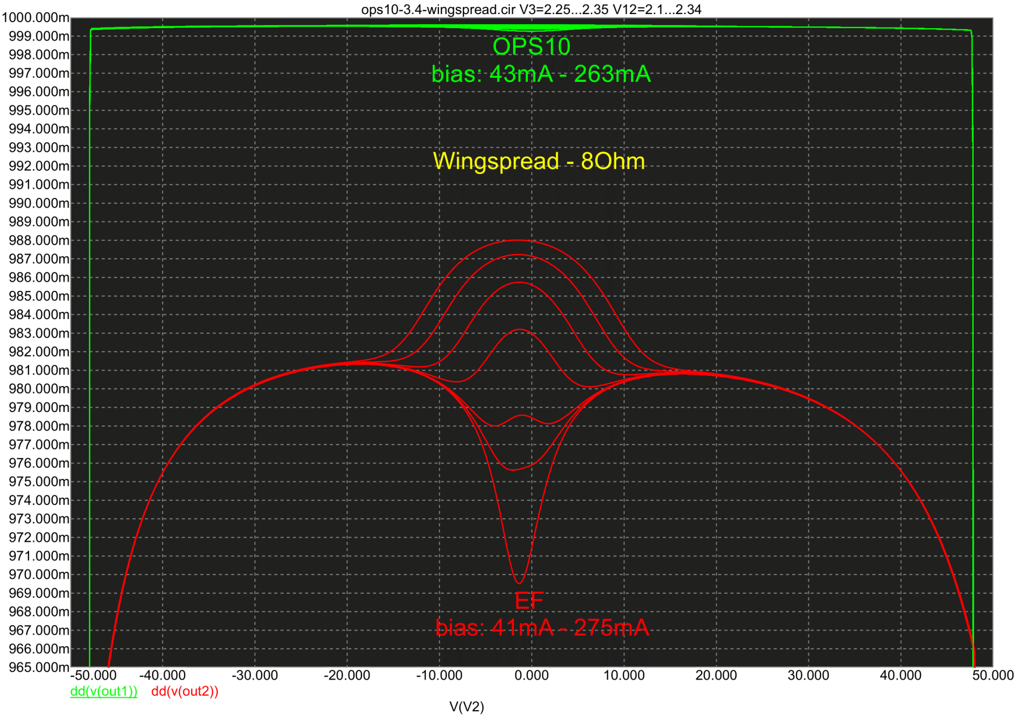

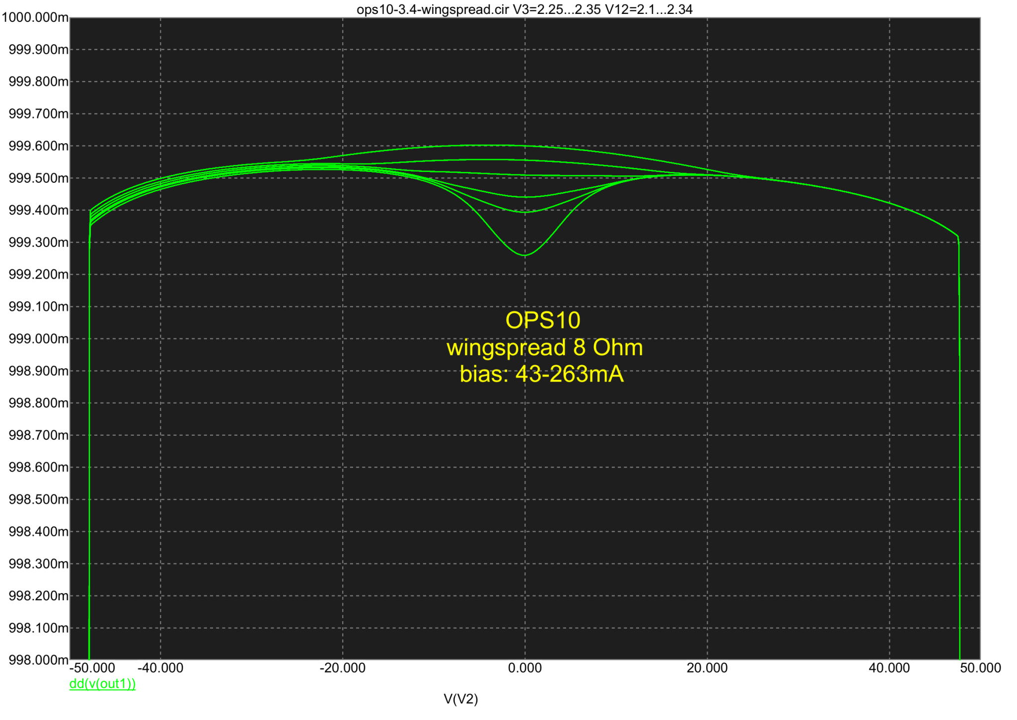

To clarify the OPS10 characteristics compared to a standard EF output stage, the wingspread is perhaps the most suitable.
The following image shows the combined wingspread of the OPS10 and standard EF.
To make the OPS10 wingspread more apparent, the scale has been adjusted in the subsequent image.

There might be a confusion there: the original Visch principle was quite different (and unusable practically).
This is different (and looks better).
