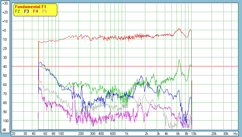

Impressive nonlinear distortion up to 1.5 kHz. But high 3rd order distortion in the upper midrange doesn't look so good. Considering price, I'd choose the TB W4-1337.
... high 3rd order distortion in the upper midrange doesn't look so good.
Think of it as a feature, and why it can sound so "detailed", and had several rave reviews.
Crossed at 1Khz, there's probably nothing to write home about.
Wait a minute... the distortion appears to stay well below 1% all the up to 5kHz, at which point the 2nd, 3rd and 4th harmonics represent 10kHz, 15kHz and 20kHz respectively.

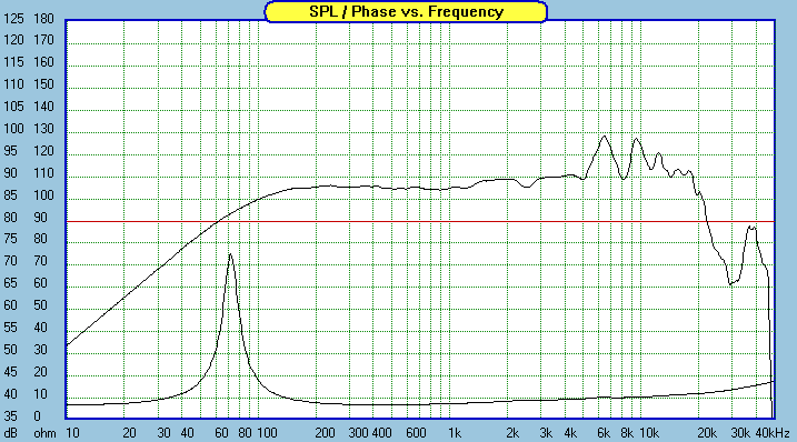

I would rate this driver above the TangBand W4 1337SA in the non-linear distortion department. This is probably the result of a better motor system.
On the other hand, what I was alluding to was that the cone's behaviour between 5-15Khz has prevented it from being a complete all rounder.
Compared to the HD below 1Khz, there is a slight jump up in distortion between 1-3Khz. This is probably related to the stiff cone break amplifying the HD components, and is not unlike some other metal cones like the SEAS Excel series. I have always suspected that drivers with this kind of harmonic distortion profile can sound "detailed", but sometimes "unforgiving"...
Now IIRC, Dennis Murphy said that this driver is great, but is a bit of a pain to work with. It's not god-sent midrange driver that many of us were hoping for. And from the FR measurements, I can see why- it would need a LOT of work to tame those double or triple peaks at 6-10Khz.
Once that's taken care of, I suspect it would make a great midrange driver.

"Just got done testing the Ti-100's. Not too bad. Excellent midrange non-linear distortion performance, changing to average as frequency goes higher. Relatively sensitive also. The best use for these would probably with a large format tweeter crossed low, around 1600hz maybe. You could cross higher depending on how much that 3rd order HD bothers you."
