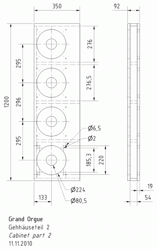

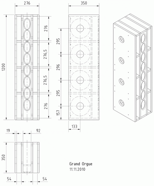

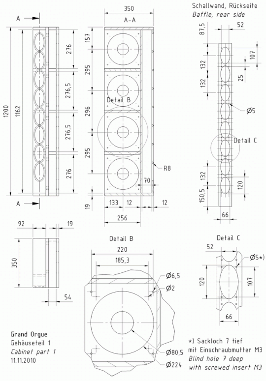

Can I build the Grand Orgue as standalone subwoofer by removing those full range mid and high section? So which part should I remove based on the attached drawing?

You’d not remove anything, just don’t make the holes for the array of widebanders. But for a budget of about 300 euro’s for the 8 woofers there will definitely be other options for a nice sub build.

It requires some equalization to function properly. No problem for a cheap DSP or amplifier with built-in DSP.

The plan I found online, hopefully free of mistake.
