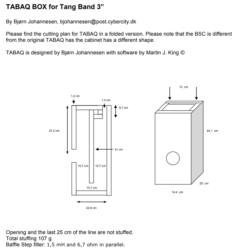

I have these playing in Cyburgs Needles quite nicely. As you are looking for computer speakers I'd look into Cyburgs Brick or Folded TABAQ if they're not too big for you.
Attaching the plans for TABAQ. Couldn't find the Brick plans quickly, but they should be findable.
