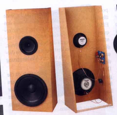

From what I can gather Bob's going to bail on the Visaton OB build. Dave's got a nice setup going but after (an attempt at) reading the recommended build on the Visaton site I'm having trouble visualizing the baffle using the B200 and the BSG40. Can someone help my feeble mind?

Thanks joensd, that's exactly what I needed. I got confused in the translation on how the side wings were done. It's hard to believe that an 8" driver doesn't need a helper tweeter. How are the highs?
I haven´t build it but the fr shows quite a few resonances and a SPL-loss from 15k on.How are the highs?
Have a look at the B200 on it´s own in the SOLO100 .
Basically only the low frquency part in the fr of the B200/BGS40-combination looks different.
Strange that the Solo100 appears to play even deeper.

I hope this translation is better than babelfish 🙂
The SOLO 20 should be placed in a bookshelf and has an inner volume of 20 l. f3 is 80 Hz, making a subwoofer necessary. Dimensions of the enclosure go without saying if you try to put the B200 into a 20l box. A sealed volume has proved to be favorable. Because of the high Qtc in the small volume there will be a notch at 100Hz. This is compensates by 470µF in series. To make this HP workable, an impedance peak at 90 Hz is compensated by a 22 mH coil in series with a 150 µF capazitor. Together with the acoustic roll-off we get a summed roll-off with 18 dB/oct. The 22 mH coil has to have a resistance of 5,5-6 Ohm. If necessary add the appropriate value with a resistor.
Stuffing is, as with all sealed boxes, not critical. Use 2 bags of damping wool per box.
As with all SOLOS, the frequency responce above 500 Hz has to be compensated. The SOLO 20 doesn´t need much correction there because the high f3 allows for an efficiency of 90 dB/2,83 V/m.
