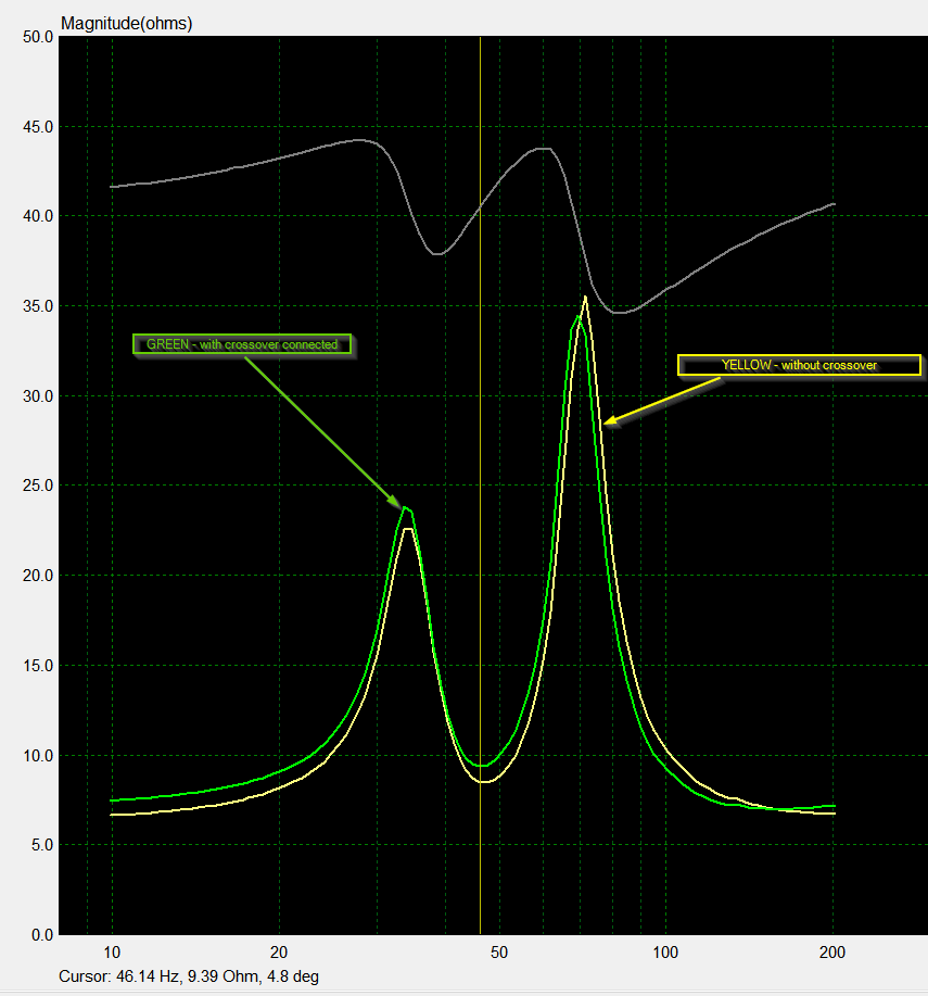

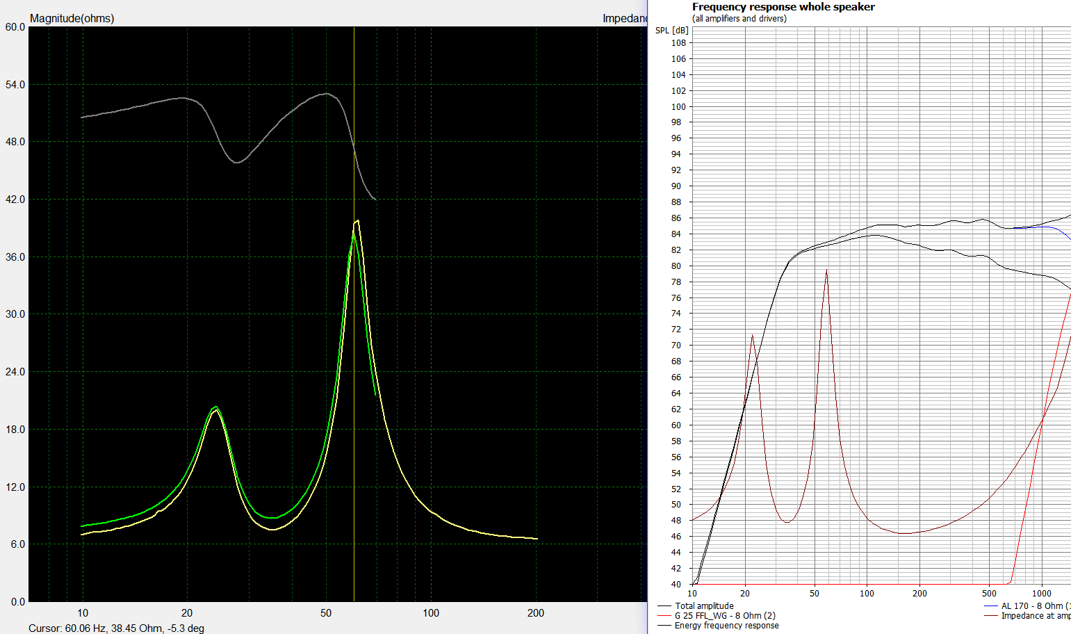

Hello all,

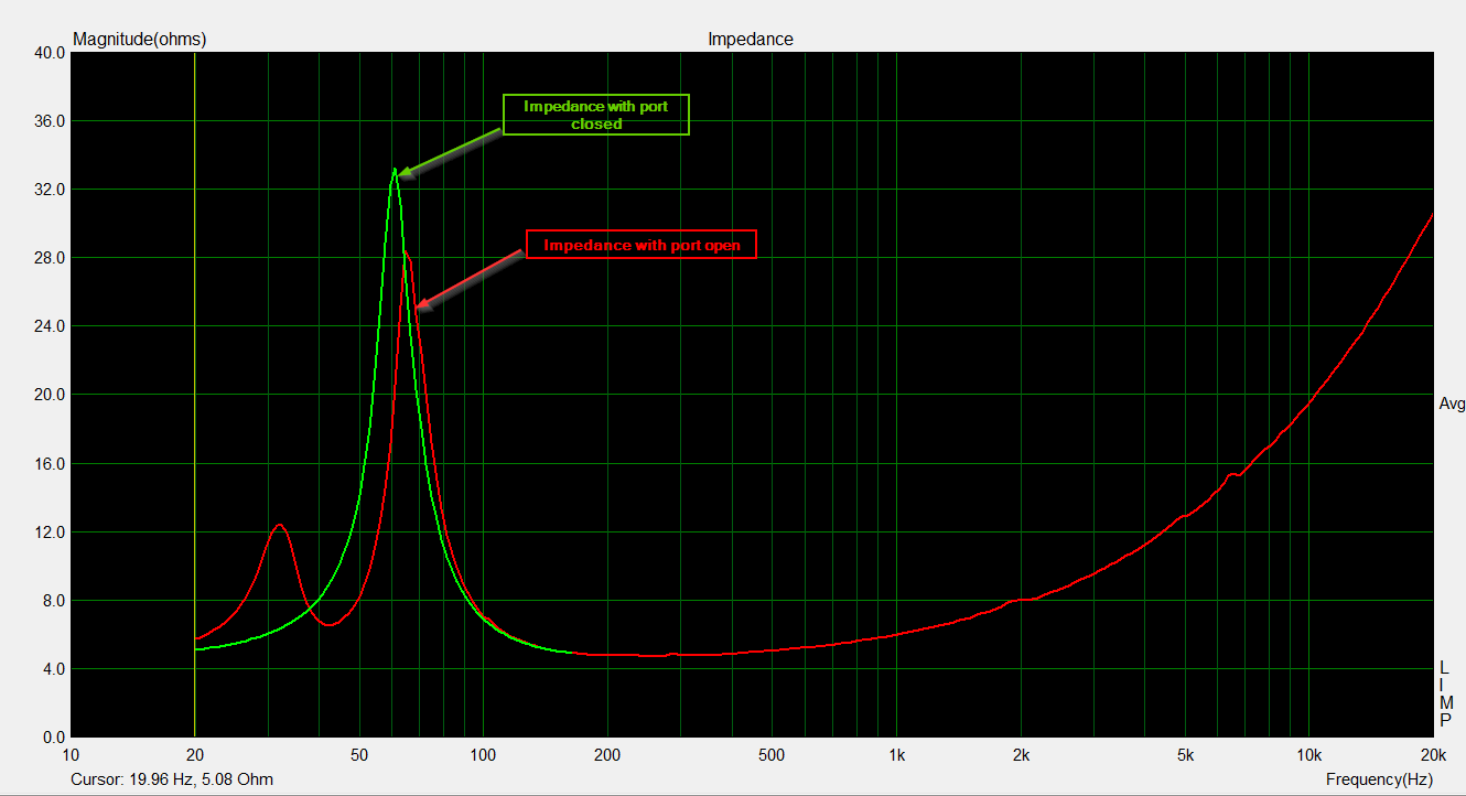

I've started a new 2 way project with a combination of Visaton AL170 and G25FFL+WG148. It's going to be a bass reflex system again.
I've made some near field measurements with ARTA, and they looked quite strange, in a sense that I was not able to see the effect of the port.
Therefore, I've taken some impedance measurements for the woofer alone, without crossover, to see where the port could have an effect.
I've attached the impedance measurements for the cases when the port was left open and was closed. What is even more strange is that the measured values are off by around 10 Hz more than I have simulated with Boxsim.
I have not given the box volume on purpose, so that we avoid subjective opinion.
Could you please give me some hints, what it might be wrong?

imho the two peaks of the red impedance plot should look similarly (equal height).......
the resonant frequency is in the midpoint between the two peaks.
your port is too short or the diameter is too large ?

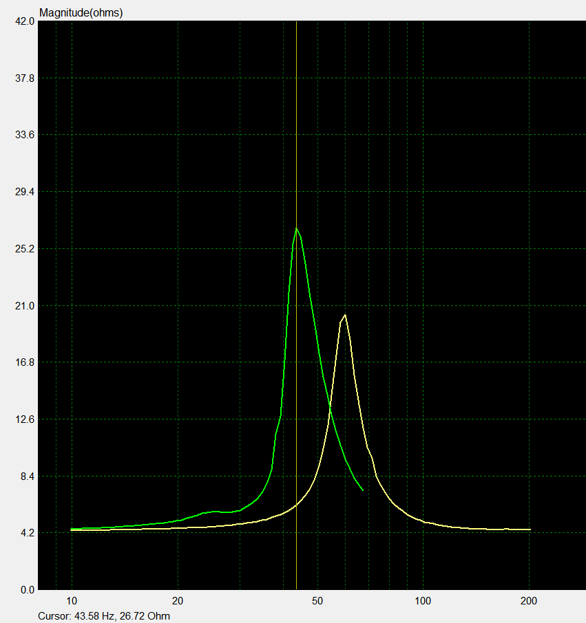

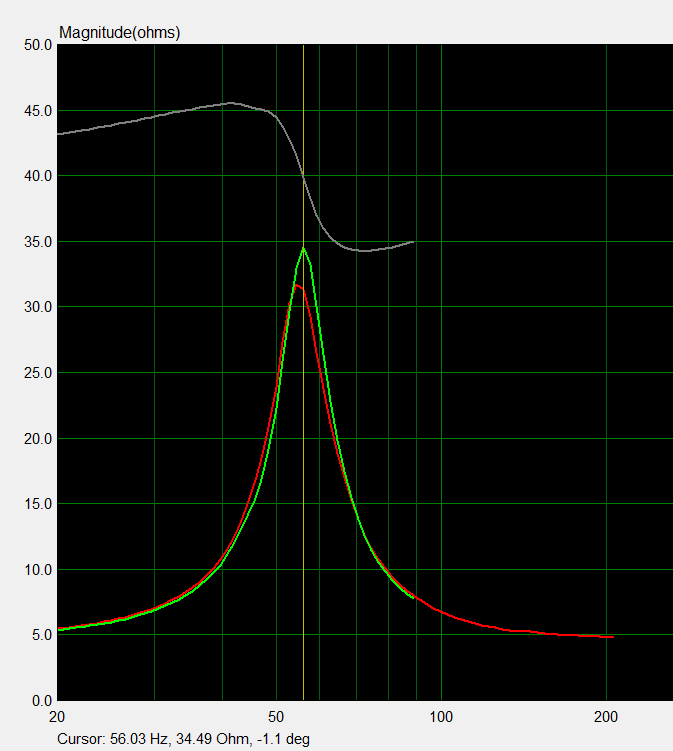

I've did some impedance measurement of both AL170's, in free air. I found that the highest impedance (actually at the natural resonance frequency) is at around 56Hz. I was expecting to be something like 38Hz.
The speakers are brand new, they were never played loud, therefore I think that maybe I'd need to break them in for a couple of weeks before moving forward.
Attached are the measurements, green is one of them, red the other one.
What do you think?
What do you think?
yes, the drivers - measured by german speaker magazines - had a break in .........24 hours sinus signals or sowhat.
I've received an interesting feedback on this from the creator of Boxsim, UweG: "In general it is known that new drivers have stiffer suspensions compared to used ones and additionally Thiele/Small parameters depend on the voltage level where they are measured. If you measured with only some mV (e.g. without a power amp) you may get higher fs than at 1 Volt or even 2.83V."
He's right, I was testing with headphone out of my soundcard...
Therefore, I've built the ARTA measuring box tonight, I'll use the power amp to have a much higher level. Tomorrow, measurement day again

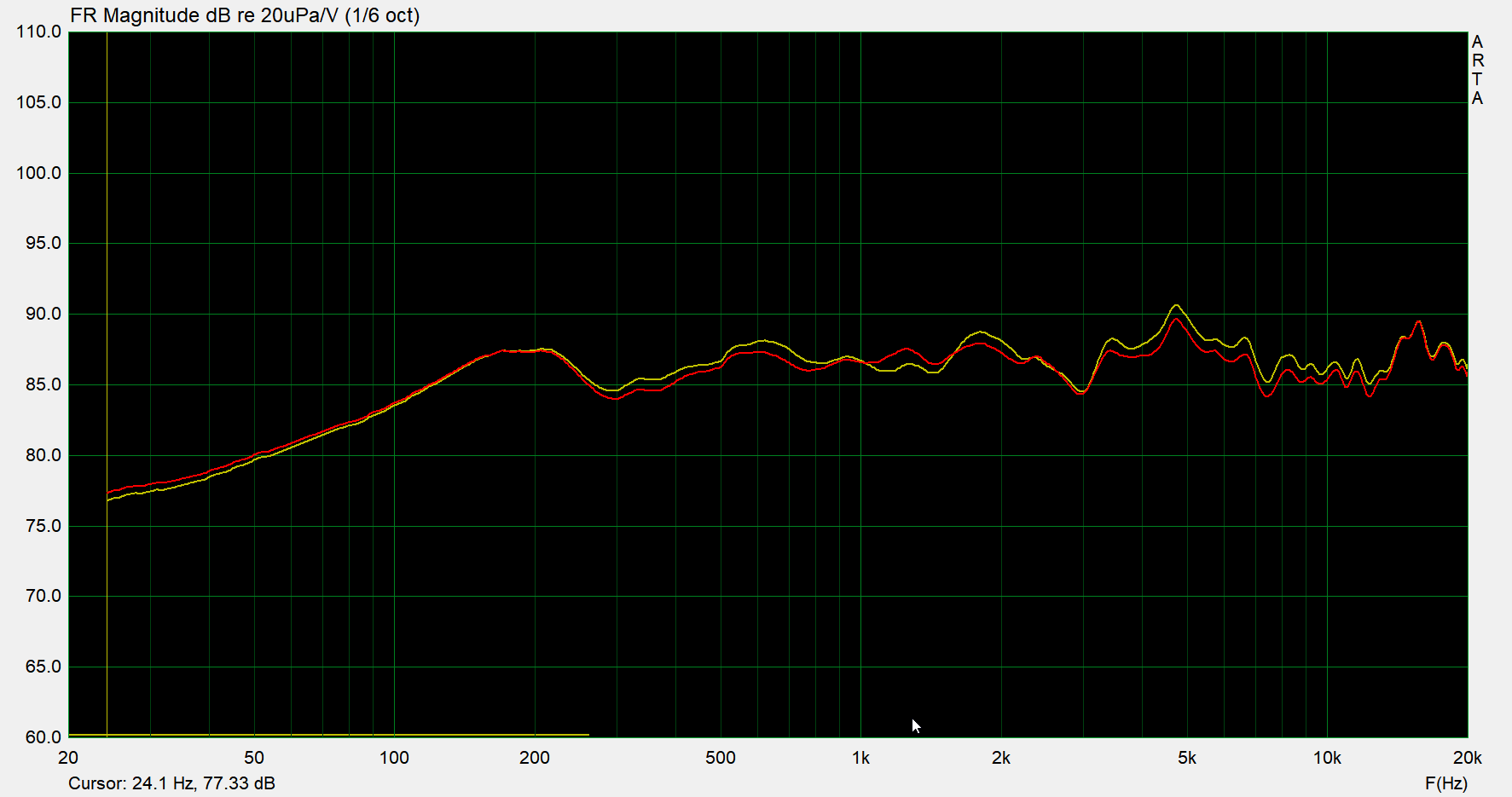

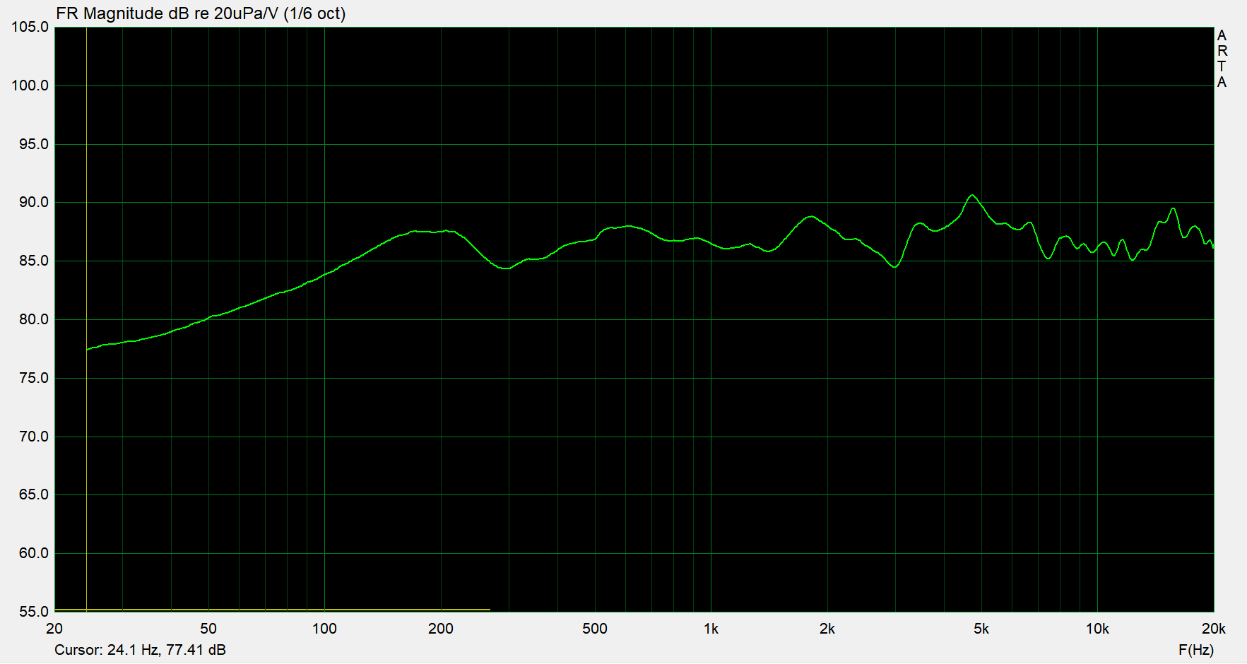

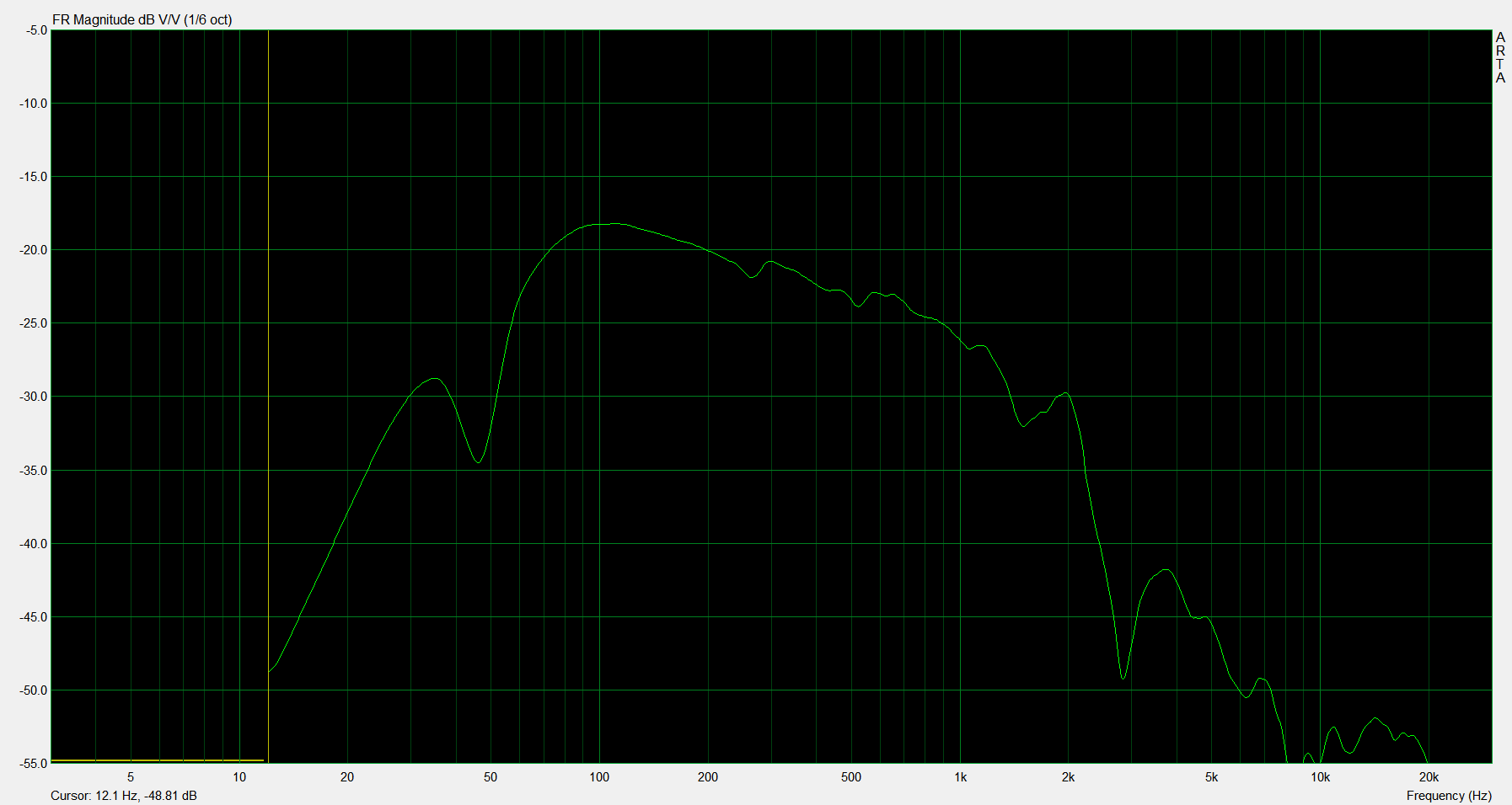

Further impedance measurements done with power amp and Arta measuring box show the one attached below.
I've also added a near field measurement, microphone ~7mm from woofer cone.
Something is still not quite OK.
The box volume is around 39L, without bracing and woofer. I'd expect that these occupy around 2L, therefore I calculate with 37L.
The reflex tube is a flared 7cm piece, cut to 9cm length. This should yield ~37Hz box tuning.
However, the dip on the impedance measurement is at 46Hz...
I've checked the box for leaks, and cannot detect any major issue. Check was done with the BR port tightly closed, the speaker driven at higher volume on 20Hz, and a flame of a lighter driven around the fittings, speaker cutout.
What am I doing wrong here?

Al 170 does not meet manufacturer specs. It will not lower to Fs=38 Hz, not now, not ever. At least the units I used to have sure did not. That is your issue.
Then why are they advertising it like that in the first place?
My W170S's seem to perform a bit better, however, they are like almost 10 years old, and the AL170s are brand new.
Anyway, I have followed UweG's advice, and sent an inquiry to Visaton technical department. I'm curious what they are going to answer...
There was a suggestion, that the level on the speaker influences the Fs quite much. Therefore I took a venerable old Tesla ARN567, and did two measurements, one with quite low level, another one with the amp cranked up higher.
60Hz with low volume vs. 43Hz with higher volume! I'll do the same with the AL170 tomorrow, as it is getting late over here...

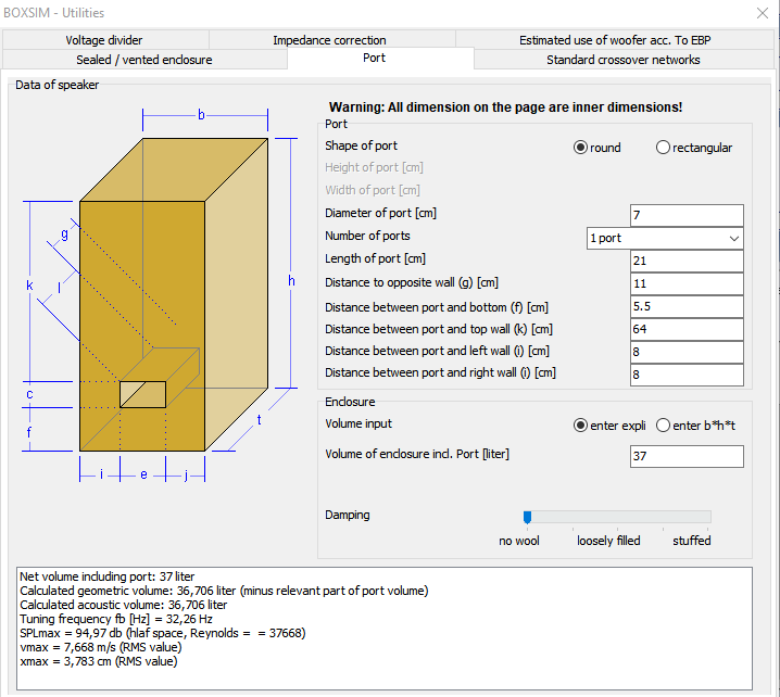

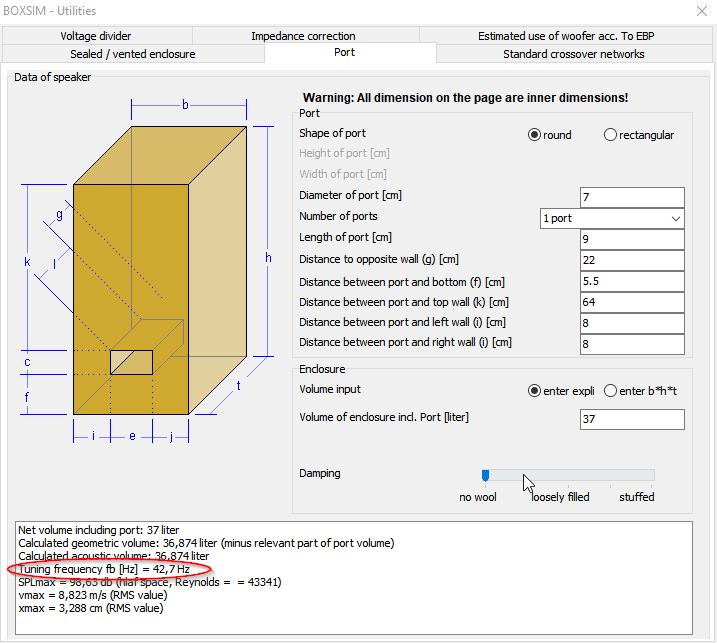

I don't know how you arrived on that output, but Unibox tells me that to have a 46Hz tuning in a 37-38L box with walls covered you can use a 7cm flared vent 9cm long. Your measure is pretty consistent with that.The box volume is around 39L, without bracing and woofer. I'd expect that these occupy around 2L, therefore I calculate with 37L.
The box tuning depends only on the box and tube, how this tuning is effective however depends on the driver.

It was Boxsim. However, I now realized I made several mistakes.
The port position was not set correctly. Distance from sides, bottom and top was not filled in, therefore it used the default values.
With the right values I get 43Hz!
OK... The issue was wrong Boxsim values.

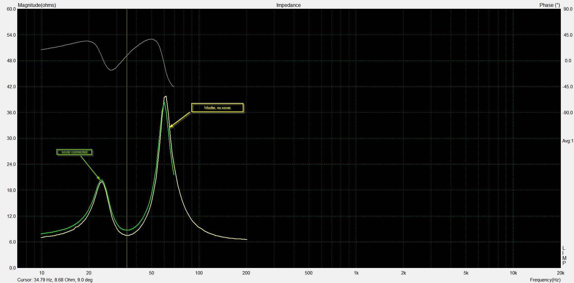

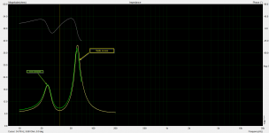

Now I put in the right values, used a 21cm port, and measured it again.
I get 35Hz from impedance measurement, sim says 32Hz -- therefore it's more or less on the spot.
Boxsim simulated impedance curve also matches the measured ones.

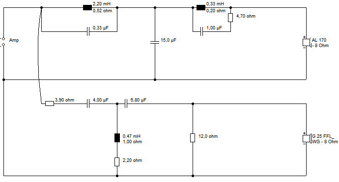

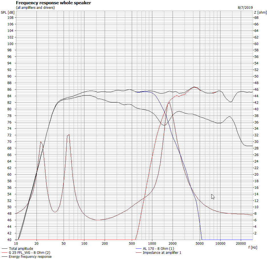

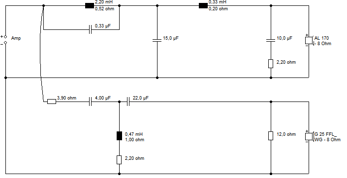

It's now 4th order on the woofer.
Ok so you have the parallel LC at the input end, which is a notch of sorts (I guess)
I usually do this with a inductor in parallel with the first capacitor shunt (15uF in your schematic)
Without seeing the sim as a whole and individual filter responses, if guess you would do better with a 4th order HPF too.
But without individual driver responses, it's just conjecture
My apologies, I didn't see the attachment text on my phone.
Actually the plot with the black background (,measured?) Shows a good correlation with the Boxsim simulation.
Ignore my previous comments (I also didn't realise the other plot was 5dB/div), it looks like a fairly good end result. You may be able to tweak it some more but it isnt half bad at all.
My first instinct would be to try a 4th order HPF (if it were my speaker), I find it awkward getting phase sounding right with odd order filters

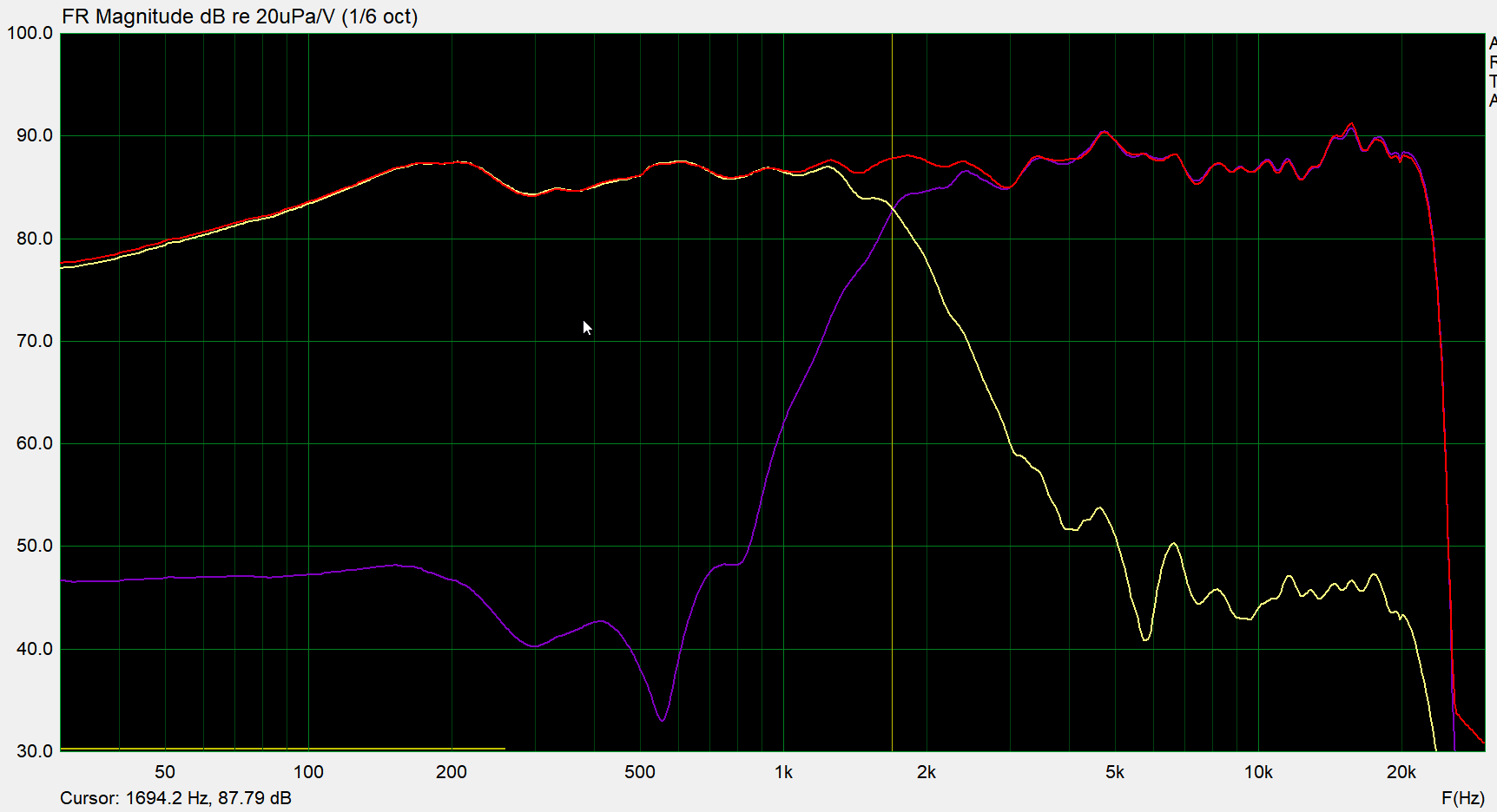

Yes, the plot with the black back is the measured one!
However, I've done now a 3rd order woofer filter, and some tweaks on the HPF.
Find attached. The new crossover is the red line on the measurement, the original one is the yellowish.
Can't understand the dip at 3kHz though... I guess it's from the mike placement, it's from 96cm , centered between the woofer and the tweeter.
