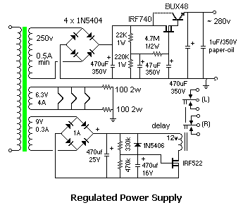

Has anybody used this type of regulated PS & how good is it? I've searched under "virtual battery" but can't find anything on DIYA. Here's a short description:
The supply is regulated with a Darlington hybrid (an IRF power MOSFET and a Motorola BUX48 power transistor) to implement a virtual battery (the circuit is based on a Technics design). The MOSFET/NPN pair can conduct up to 400V at 15A and will easily handle the surge currents of large power supply capacitors. The BUX48 should be heatsinked to dissipate about 6W.
I'm thinking of it for a lower voltage of up to 50V. Can it be made variable voltage output?

Here's another version under the name Power Follower from here: http://www.audiodesignguide.com/PowerFollower/
So, this circuit adopt a little capacitor after the bridge (only 3300uF for an amplifier working with 3A bias).
This capacitor is followed by a MOSFET voltage regulator, featuring a very low frequency CR filter (220uF/100Kohm) which is based on the Virtual Battery Operation, invented by Technics (something good can be found in the consumer world, too).

the "virtual battery" (what baloney) tracks input voltage as changed by variations in line voltage and load, and takes out some AC. That may be useful under some special circumstances. In the tube days, this was done using a large choke, that's in a way what this circuit simulates.
A proper regulator gives you a known output voltage, low source resistance (as it regulates out changes due to both load and line changes), and better AC filtering, too.
