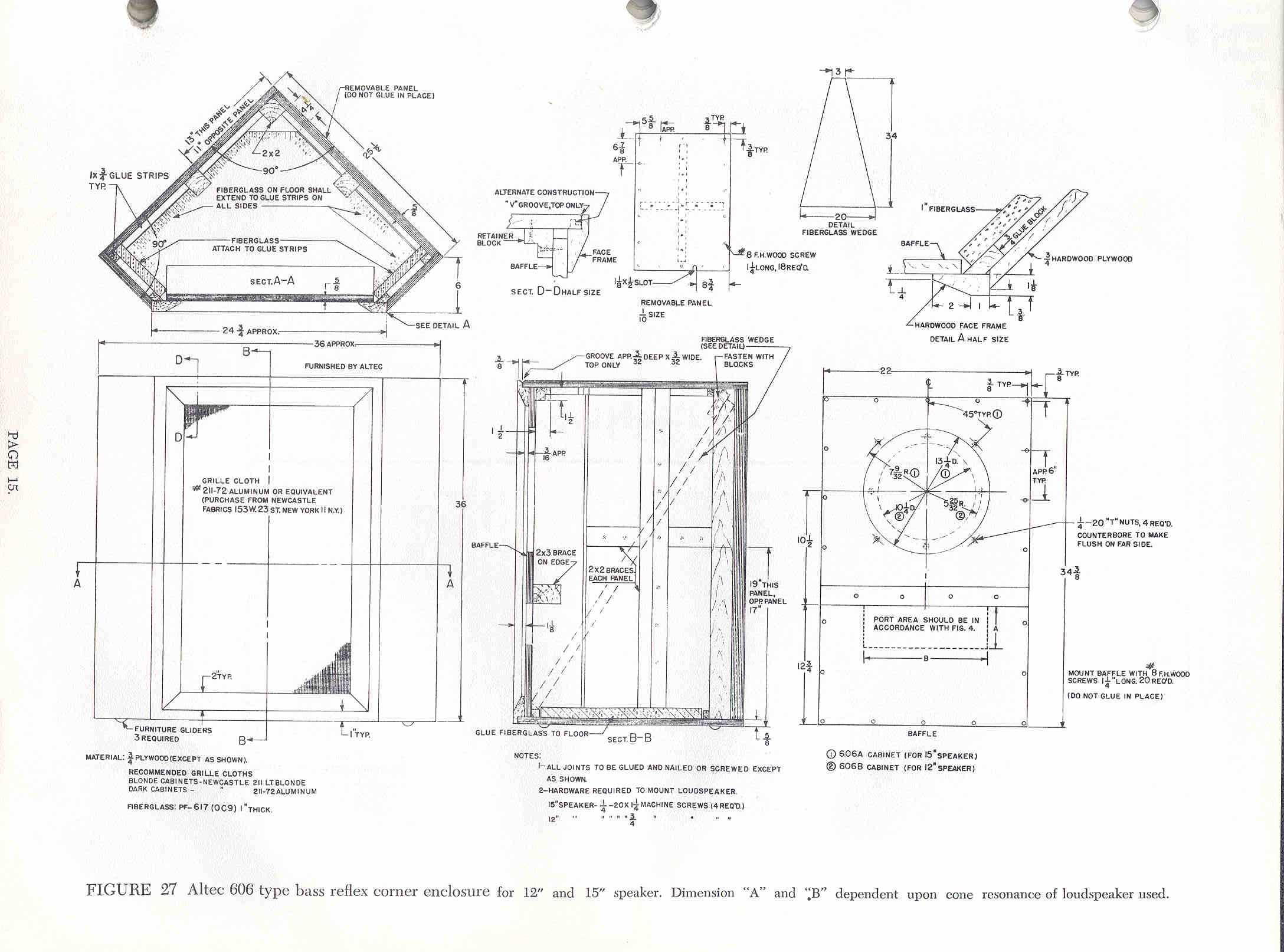

My plan is to build cabinets for these in a corner bass reflex design. I am limited to 22" on each side so to get the required minimum amount of cabinet volume (8 cu ft)for the woofer as per University recommendation I will need to make them about 3.75' tall minimum, obviously ported. They will then crossover at 350hz to the full range driver which will cover mid and and up frequencies. According to what I have read, these will have to be 100% separated from the woofer enclosures due to the paper cones with a minimum of 1 cu ft of volume so the plan would be a sealed enclosure above which will bring the speakers to about 5-5.5' tall. Big boys! I can upload my plans today, but does this seem to jive? My concern is whether the design will make them too tall and narrow for the woofers for proper bass response. I would consider it a modified Altec 606 cabinet.
May be easier if I upload some drawings.
I have in my possession 2 University 15" C15W woofers and 2 University 6303 Diffaxial Full Range drivers, and a pair of University N2A crossovers.

A true corner cab's baffle goes from wall to wall, creating a crude conical horn baffle, so acoustically much wider.
Anyway, at this height, best performance is with the driver, vent at some odd harmonic of the cab's TL length, so around 0.33-0.349*L [internal height] with the vent around 0.8-0.86*L. This high aspect ratio cab alignment nowadays is referred to as a MLTL, so plenty of variants can be found on-line and superior performing to a BR, i.e. think TL-like transient response except with more gain.
Note that if you sim it as a BR, then the vent will be too long due to the pipe's 1/4 WL pipe action can add significant damping to vent, so if you start with a baffle thickness reflex vent, then it will need to be larger for a given tuning. Best then to use a TL/horn design program that allows offset driver, vent such as AkAbak or similar or just tune it empirically like we did way back then. 😉
With a 350 Hz point, the driver above ideally needs to be within ~3390/350 = ~9.69" c-t-c, but many folks are fine with up to 1 WL apart [~38.75"] depending on the listening distance [LP], so your call as to what to use, otherwise just mount the woofer at the extreme top and the vent at the extreme bottom.

In any event, as I mentioned in my first post I was thinking about a "pentagon" shaped cabinet drawing on the plans for the Altec 606 corner BR cabinet housing the woofer only and some type of sub-enclosure or separate chamber for the 3-way speaker on top. Perhaps those plans should not be changed as I mentioned I wanted to make the sides shorter and I think they spec at 25.5" and I would like to go to 22" if possible and make up for the volume loss in height. I'll attach those plans.
The MLTL may be a preferred design based on your comments. I wouldn't know where to start and I am not sure the best way to enclose the 3-way speaker. I saw one fellow built them with the 604 speakers, that was the only design I saw with vintage drivers.
