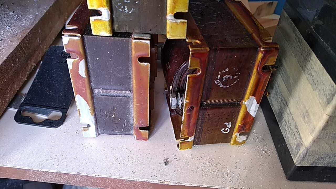

Hi, I have a few old transformers like these probably Partridge ones where the varnish has chipped. It would be nice to patch them up, for aesthetic reasons, but what old varnish is it, and even available in the 21st century.

JMO, no rust = no bother. If you have rust, gently brush it away with a soft bristle toothbrush. Follow with a rust converter. The laminations are insulated from each other by either varnish or some sort of adherent oxide. Electrical contact between laminations is bad, as eddy current losses will increase.
Thanks, I think the transformers work OK. For the amp I am building, they will be visible and it would be nice to smarten them up a bit, I like that old school dipped varnish look. I have found insulating varnish, but I am particularly interested in the rich dark colour of these above. I wonder if it is aging, or always like that?
This old varnish no longer is being made, its probably 70 years old.

You could take it up to an automotive paint store like PPG or even Napa auto parts store as they have automotive paint mixing machines there. They could possibly color match that for you and you could just touch it up , to keep the same color scheme that you were looking for. Just an idea and trying to think outside the box. But it does look like you won’t be able to match that color with a new type of insulating varnish or enamel or whatever they call it . because as they age they start getting that darker bronze copper looking color. Which , like you I like that color as well
As it needed to withstand elevated temps, do not use modern varnish, shellac etc. The real value if it was to prevent vibrations inside.

It's shellac. Itäs solvabel with spirits, a brush moistered in alcohol will patchup

That would be very exciting, I have some Shellac, but it seems to be thinner, and more shiney. I was wondering if I could mix it with talcum powder to make it a bit thicker, but the Mrs says it is carcinogenic....

If it’s phenolic resin, it can still be obtained under the trade name Waterlox. It’s still used as a wood finish and it’s the only one of its type (phenolic) that I’m aware of. I refinished a coffee table with it a few years ago. Deep amber hue to it.
That's right. The trade name was Bakelite. Chemically it is phenol-formaldehyde co-polymer. Uncured resin is liqud. Transformers and other stuff were soaked in it, and then cured at high temperature to solidify the resin. This highly toxic industrial process was superseeded by epoxy impregnation.

The old shellac is dark first because it was not highly purified for industrial use, second because they didn't clean the pot, third because it darkens over the decades. If you have not been chiseling on it, just use thin brown polish and work up to the tint.

Thanks, being daft it took me a while to get what you mean. The problem I have is that over the decades the metal has become a bit bent and some of the varnish has fallen off. I have a cunning plan however. I am going to attempt to make some varnish, fools rush in, I found some phenolic resin on ebay, and I have various oils and solvents. I suspect the making process would be dangerous and liable to catch fire, and be toxic, but hey, it didn't kill off all our ancestors. If that doesn't work I'll give the shellac shoe polish a go. 🙂
I think it is shellac. Test with concentrated alcohol on a brush.
If it is shellac it will slowly solve the varnish and you could spread

I have some shellac, and iirc it dissolves any shellac it is put on to, it doesn't touch the varnish on that particular transformer. It is a promising colour match though. Be interesting to see what it looks like when it dries.
Not shellac AT ALL.
It is NOT re-soluble into anything.
Shellac belongs in furniture, musical instruments, etc, this is Industrial stuff.
Old style was either some kind of phenolic varnish, which was later oven cured, or oil based thick varnish, which first dried , then cured by slow oxidation.
The key word being **cured** , which is an irreversible hardening process.
Commercially making transformers for over 50 years now, and that impregnation varnish was already old when I started, do the Math.
Two kinds: oven cure, which is the best, and a few years after I started doing it in the late 60´s, the fancy new kid in the block was "air cure".
A mixed blessing: oven cure could be used down to the last drop, while with air cured sometimes you were left with half or third of a can gelified , useless for anything else.
