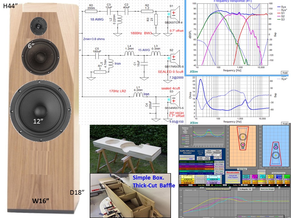

YOU CRAVE: Deep bass with superior transient low Qts response from sealed woofers
With high efficiency Class-D woofer amplifiers, deep bass with superior transient low Qts response from a sealed woofer is easy to deliver. A floor standing 3-way with a 12" woofer would support a low edge diffraction distortion "Avalon-Style" cabinet. Instead of bevels, you could use a 1.5" - 3" radius quarter round on the baffle edges above the woofer.
Run a sealed simulation of the SB_Acoustics 12" SB34NRX75-6 wth your max box volume goal.'
Study a few threads on edge diffraction DISTORTION.
