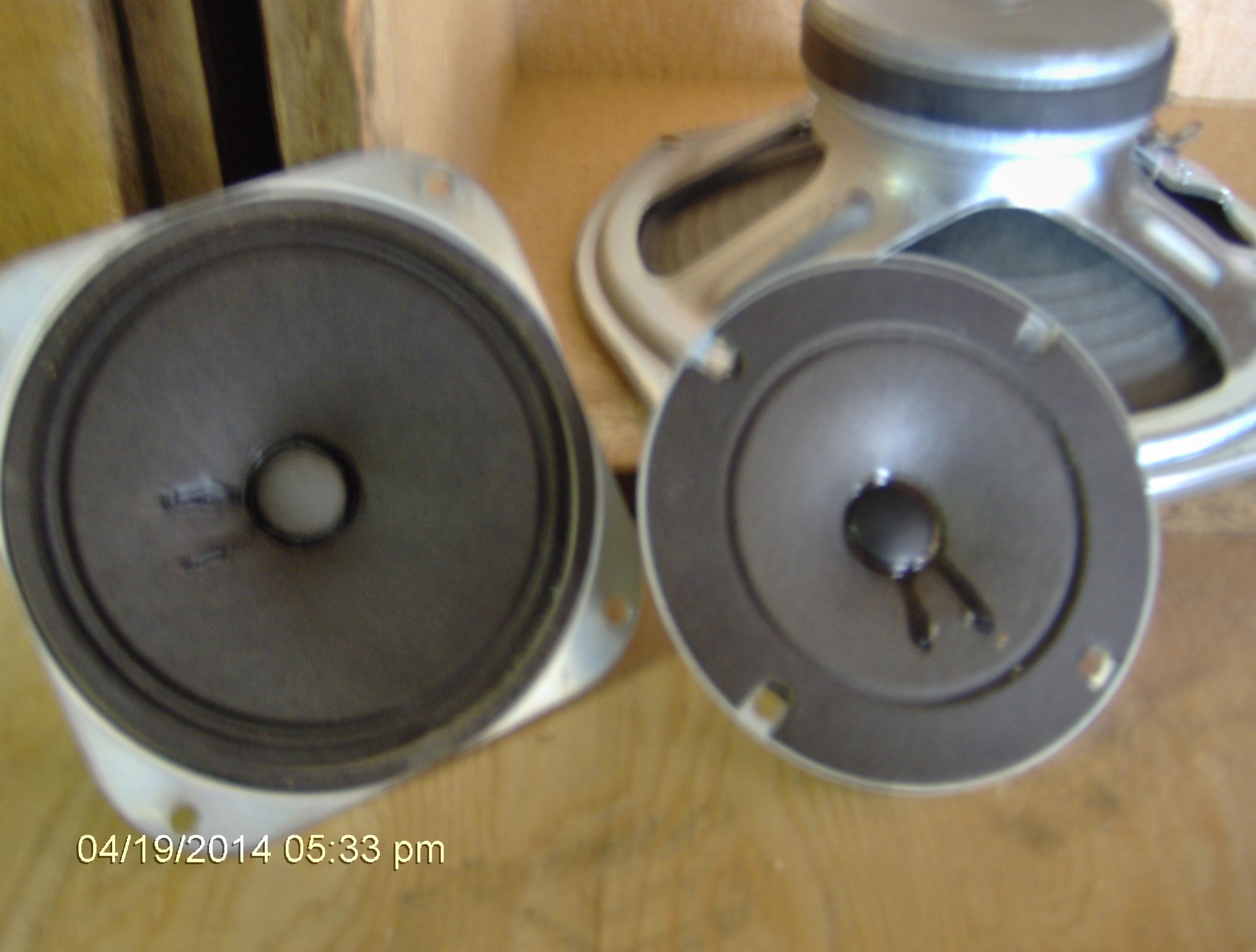

All Sony speakers made in Canada used Japanese drivers from companies like Foster or Pioneer. Drivers were shipped from Japan, but the enclosures were Canadian made.
Bass driver looks like some made by RSC (Radio Speakers Canada), these all look like North American drivers, not Japanese.

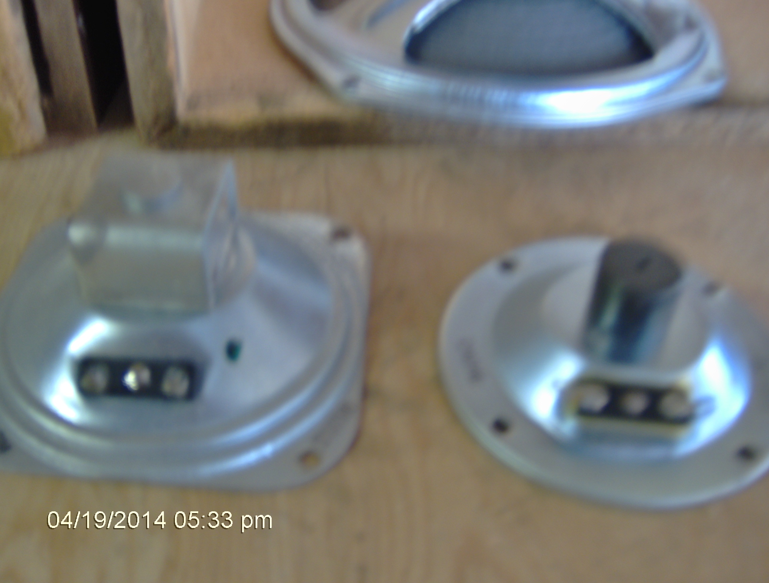

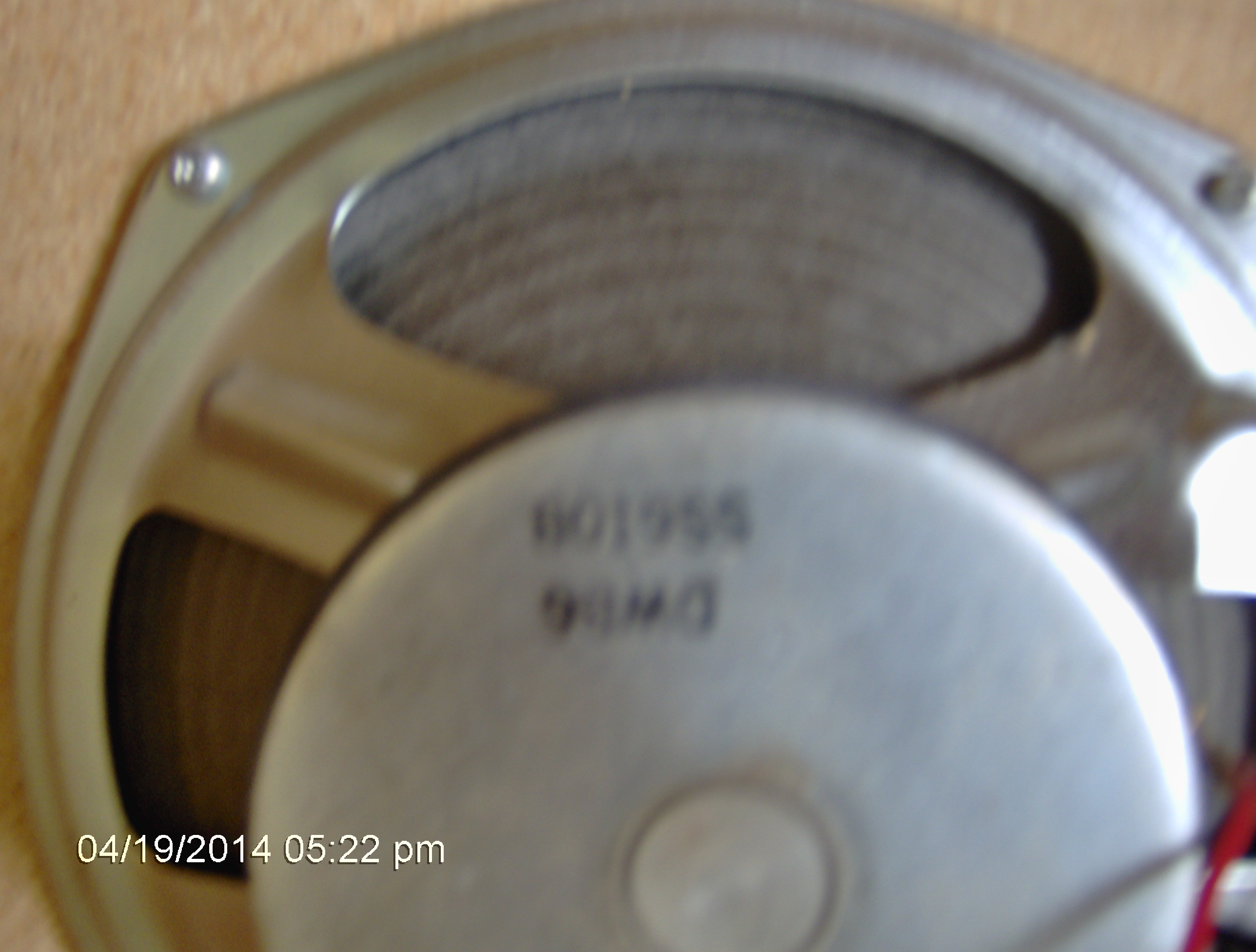

Not the ones in the boxes pictured. The 4 character code strating with D is a Canadian OEM code. Built to Sony specifications likely.

planet10 i think your speaker sleuthing abilities are amazing is this RSC stuff or does it come from the old Cambridge Speaker plant in Waterloo the frame reminds me of other stuff like Electrohome,Viking etc. or is this early McBride stuff (the hint there comes in the form of the frame being pre stamped for 70v x-former mounting).
it appears the numbering on the drivers is a packaged set:
dwe7 pack : woofer-DWB6 SS610B
mid-DWH6 SS610M
tweeter-DWH6 SS610T

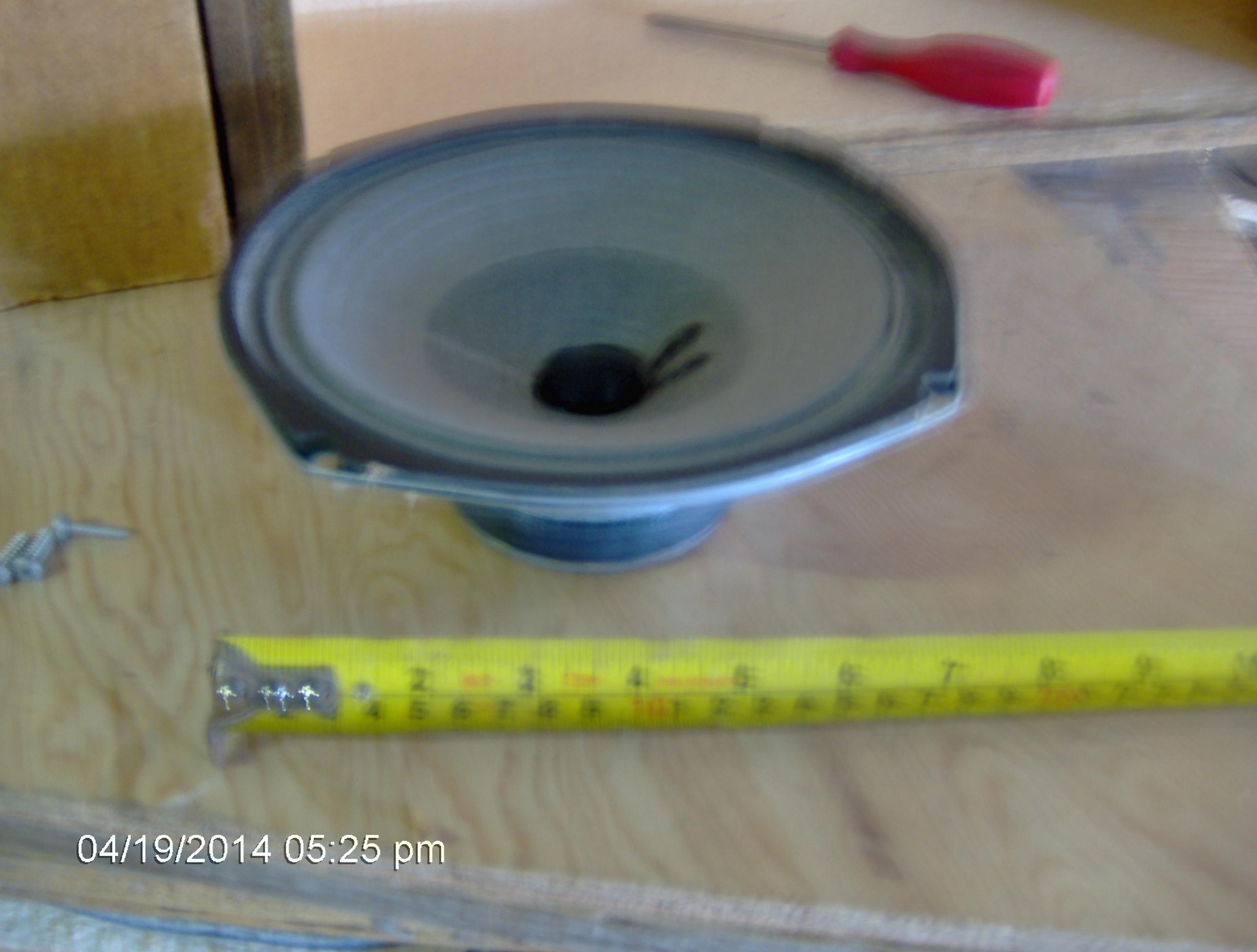

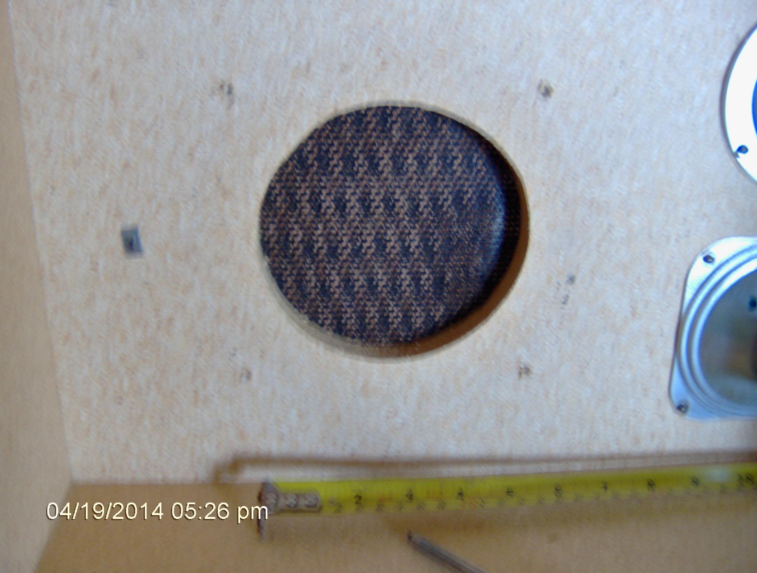

so the last thumbnail shot is of a 5 inch hole, on which a 6 inch(eff. cone dia) 7.25(frame) bass driver was mounted (baffle thickness 5/8) not to mention a layer of perforated plastic and a grillcloth.

I doubt it. But it looks like a child of its time.
The bass will be high efficiency with a rigid surround I expect. It probably has good natural rolloff around 3kHz. It looks like lowish inductance from the small voicecoil, probably Le around 0.6mH, but I could be wrong on that. The 3" and 2" cone tweeters get 2.2uF and 1uF probably.
The bass won't take more than about 20 watts I expect. It's closed box, isn't it. And quite big at that. But I don't suppose it goes very deep with a cloth surround.
I have had a lot of fun giving this sort of speaker a proper crossover for a two way. It then sounds incredibly good. Efficient too. 🙂
That bass/mid mounting is distinctly odd. FWIW it would probably
work better as a two way with the mid omitted than it does as
a 3 way, the x/o is too crude and has too much driver overlap.

The cabinet should be pretty similar to the original I'd think. It's odd that they glued it all together with the drivers mounted on the inside. You'd want some to get some access normally for maintenance, without having to smash the box up...😕

i think the smaller cut out on the bass driver was intentional cheap/crude method of changing tone and level on the bass driver.
without driver specs it will be hard to do anything other than reproduce the box.

well i made an attempt at measuring T/S parameters i think i'm in the ballpark (my antique test gear and hasty/sloppy methodology made for large differences in results)
ss610b: Fs:69hz Qts:0.7 Vas:30.9 liters
