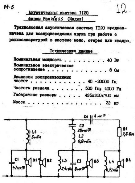

I was just curious why you are interested in this. I found a design called a KIT 1120, which seems to be the name of the Peerless twin 8-10" paper 1120 woofers involved. All looks a bit familiar. 4" Peerless midrange. Almost a Gale GS401. Tandberg used this mid too.

Thanks, 1120 I know I'm looking for just a 2 way crossover for kit 1060. I wonder what was the split on tweeter at 1.6 Khz?

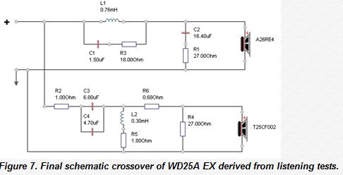

I also found it interesting SEAS A26 kit and Dynaco A25.

I do not understand. I just want to try the SEAS A26 or 2-way with Peerlees tweeter, but we need to share in the area of 1600 Hz

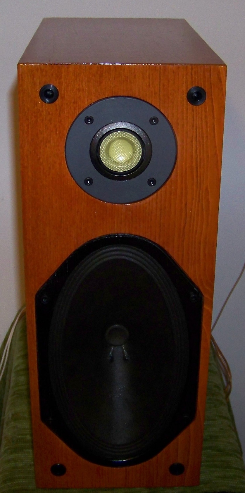

Vintage (Saba) and modern (Focal) speaker set

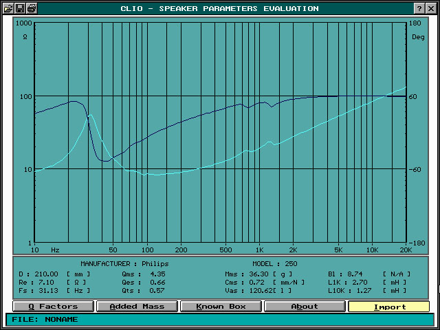

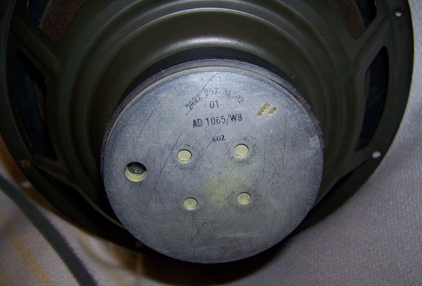

I was really unsure of the Saba model but otoh I wasn't too much interested in make and model numbers, only in numbers I get from measurements. So it turned out that this midrange unit had an interesting sound quality that I'd describe as natural. After awhile, the second half of the speaker was built and it was a sealed cabinet of Philips AD 1065 W8. Photos of the woofer cabinet is gone. Anyway the idea was to build as much from scrap materials. My newest philosophy and joy in respect to speaker building is to use junk parts (meaning not having to pay serious amounts) to prove that application is almost everything.

Another variation on the SEAS A26 idea was the Peter Comeau design. That bass filter doesn't do much.
