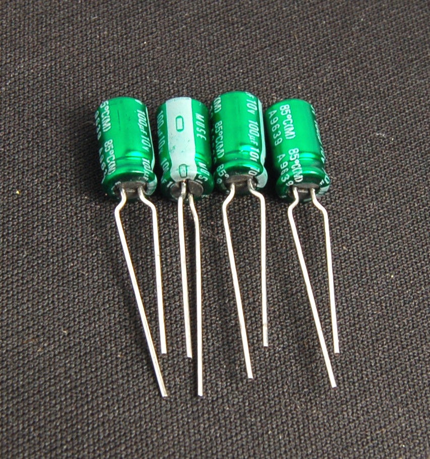

I can't find successor for the polarized caps shown in the attachment. Mine are marked Muse A9428 (10uF /50VDC) and Muse A9430 (47uF /16VDC).
Please tell me if you know or know a Panasonic equivalent.
Many thanks.
Successor will be Nichicon Muse KZ.
https://products.nichicon.co.jp/en/pdf/XJA043/e-kz.pdf
Many thanks for your kind help.🙂
