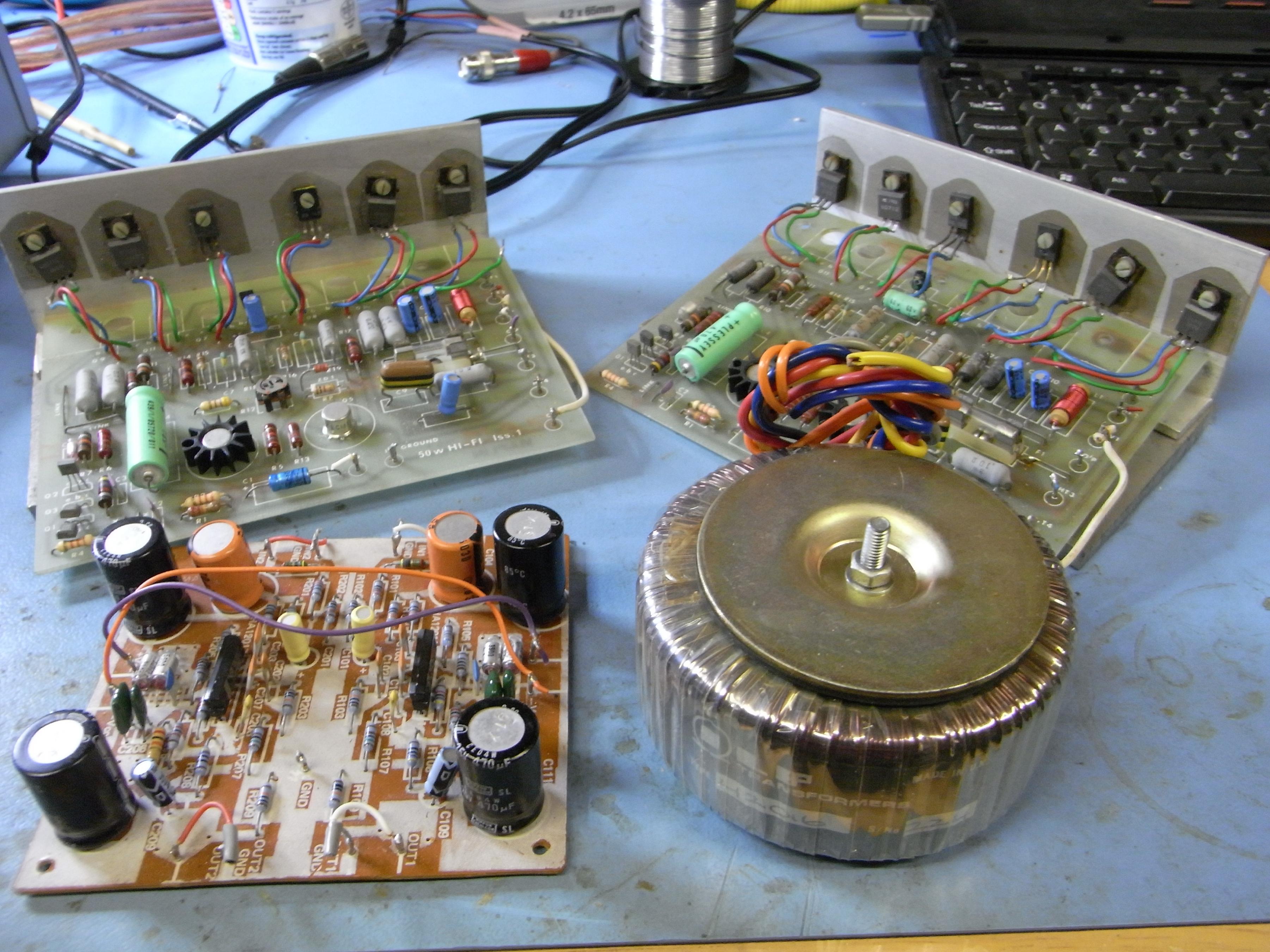

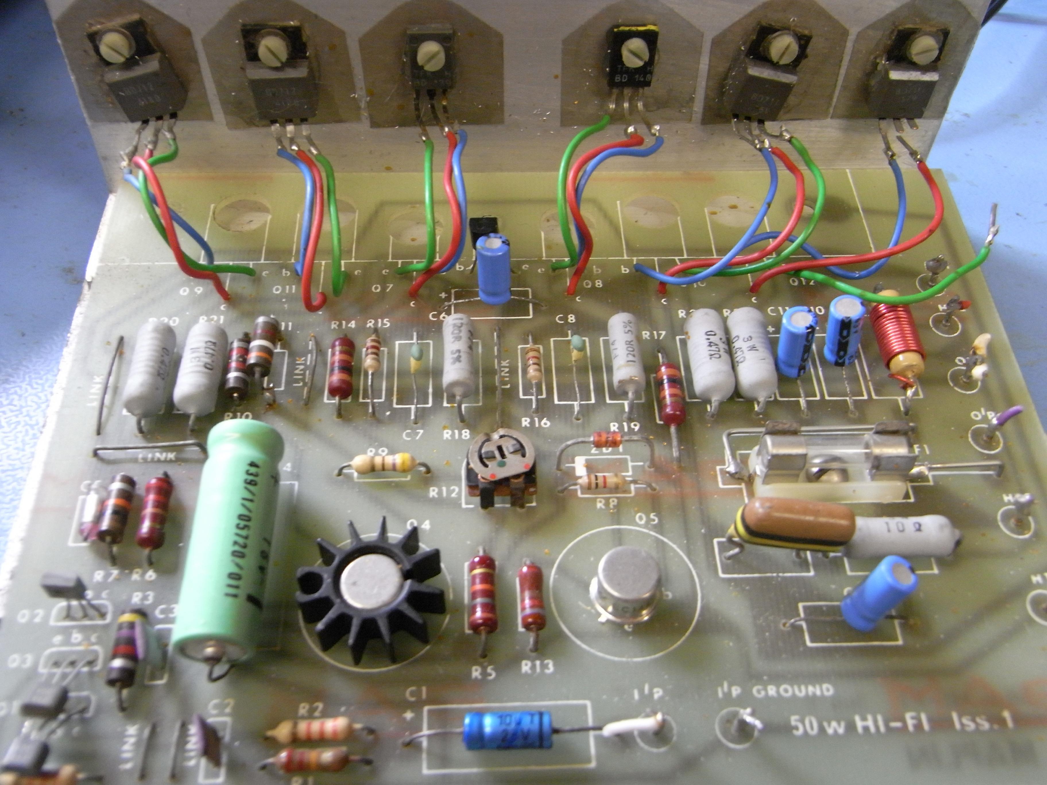

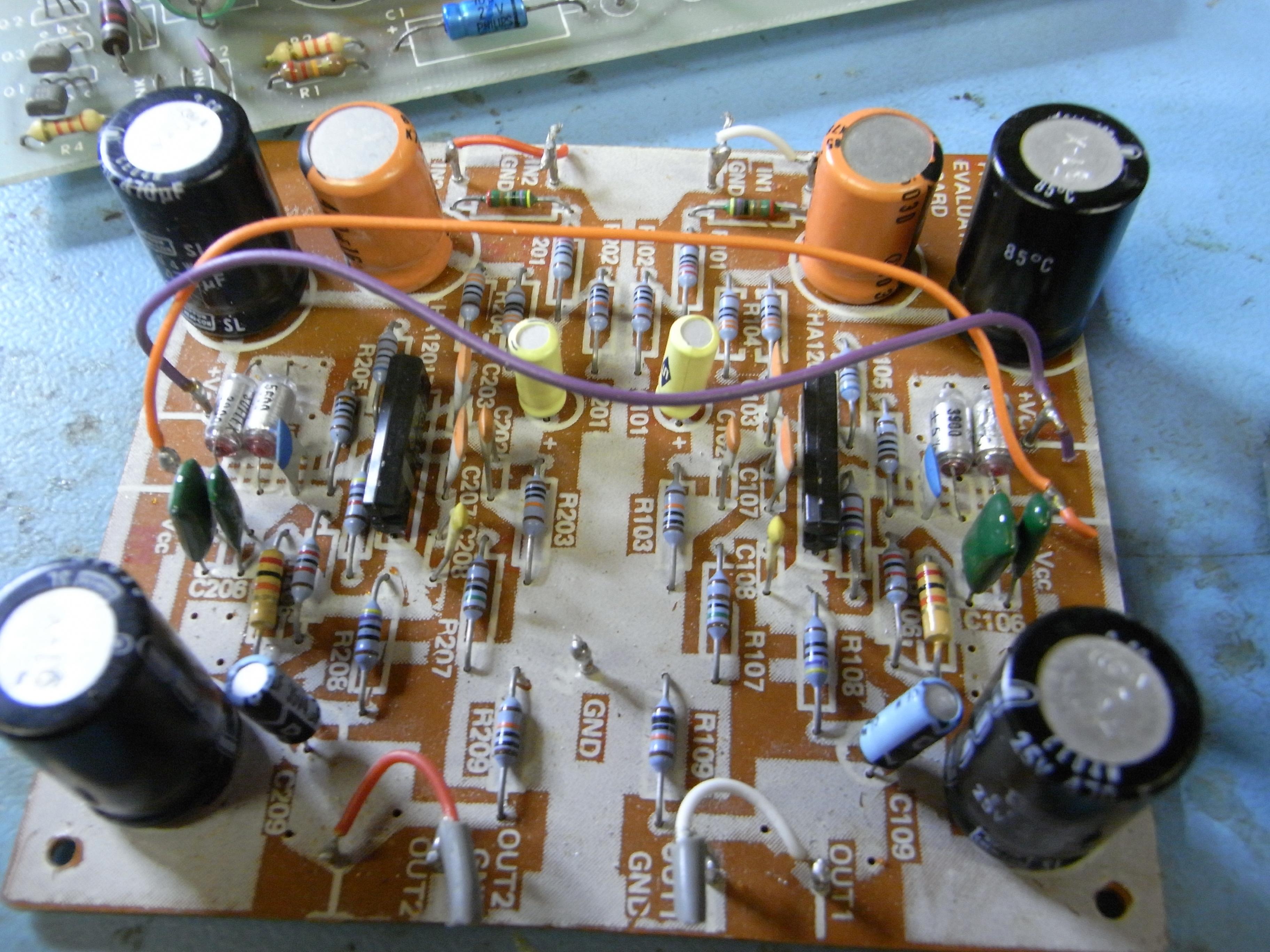

I just couldn't resist rescuing this assembled Maplin 50W amplifier kit on eBay, harking back to the good old days when Maplins were educational and before they started to sell crate-loads of Chinese junk😀. The seller had stripped the boards and transformer out of a poorly-built amplifier chassis and looking at the boards, you can probably understand why. I don't think the original constructor had too much idea and the amplifier boards are assembled badly with a mish-mash of different components e.g carbon, carbon film and metal film, vintage 1978 capacitors and flying-lead transistors. Clearly, his electronics scrap box was raided as the component source. The pre-amp board is not too bad and can be used as is but I will completely strip down the amplifier boards and start again with new components, taking the opportunity to use lower noise transistors and improve the capacitor decoupling. I have all the other components required already so lets hope I can get this amplifier up and running soon before I get too teary-eyed with nostalgia🙂

Remove those plastic bolts and replace with insulating "tophats" and steel bolts/screws/studs.

The reason why it was known as 'horrible' was down to the power transistor fixings coming loose. Just a poor finish but as you say, quite advanced for the 80s.Not sure horrible is the right word tbh. It was quite an advanced (for diy) design back in the day.
Andrew T, thanks for the steer on similar threads. I want to completely re-build as per the original design but substitute better rated transistors/resistors and avoid instability problems. My nostalgia doesn't extend as far as trashing my JBL speakers.

Ugh, connecting those transistors with wires like that has probably caused a load of problems... not to mention that Q6 is not in contact with the heatsink at all, so the amplifier was probably going into thermal runaway.
The correct output transistors are BD711/BD712 which are now obsolete, but you can still get them if you look around. Failing that, it looks like D44H11/D45H11 from OnSemi should work very well.

I don't think the boards were ever powered up and the components are definitely vintage and obsolete. The flying-lead transistor madness was probably because the constructor didn't have skills to mount the pcb and output stage transistors onto the heatsink, as per the designers intention. Speaker protection circuit definitely a good idea. At least I can test the re-built boards on the bench first with 8 ohm test load, to check performance and stability.
