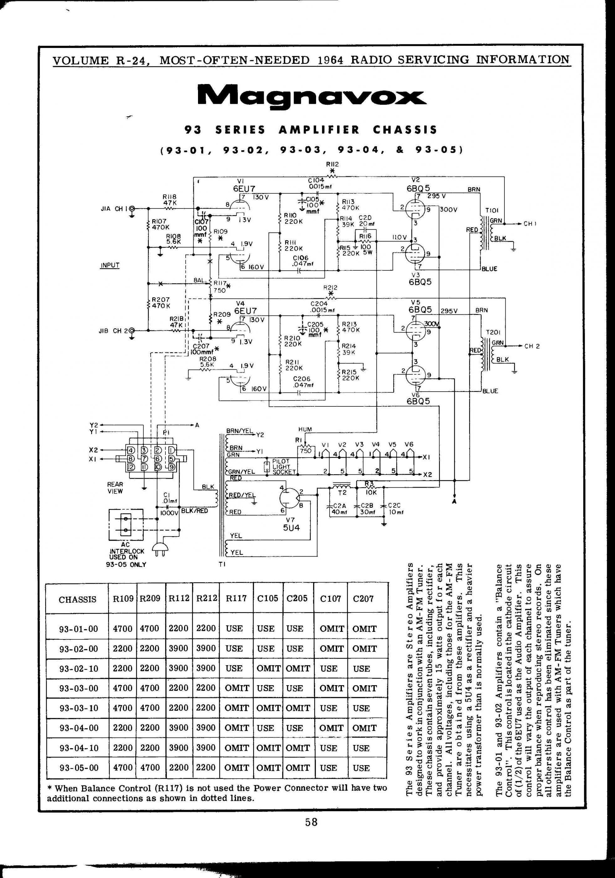

THANKS for the schematic, "Gimpy".
C20, which is undoubtedly electrolytic, and R116 form a cathode bias network that's shared by all 4 O/P tubes. That means a quad of tubes that have been tightly matched for both cathode current and transconductance (gm) is necessary.
The aluminum can is a triple section 'lytic shown as C2A, C2B, and C2C on the schematic. You might have to use a 2X 40 μF. part in that opening and a separate 10 μF. part under the chassis, as replacements.
C104, C106, C204, and C206 are the interstage coupling capacitors.

Does anyone care to comment about the asymmetries in the paraphase setup Magnavox used? I don't get a warm and fuzzy feeling.

My guess is because of the pick-off point after the coupling cap for the return of the signal to the inverter there has to be gain and frequency response realignment for the bottom half.

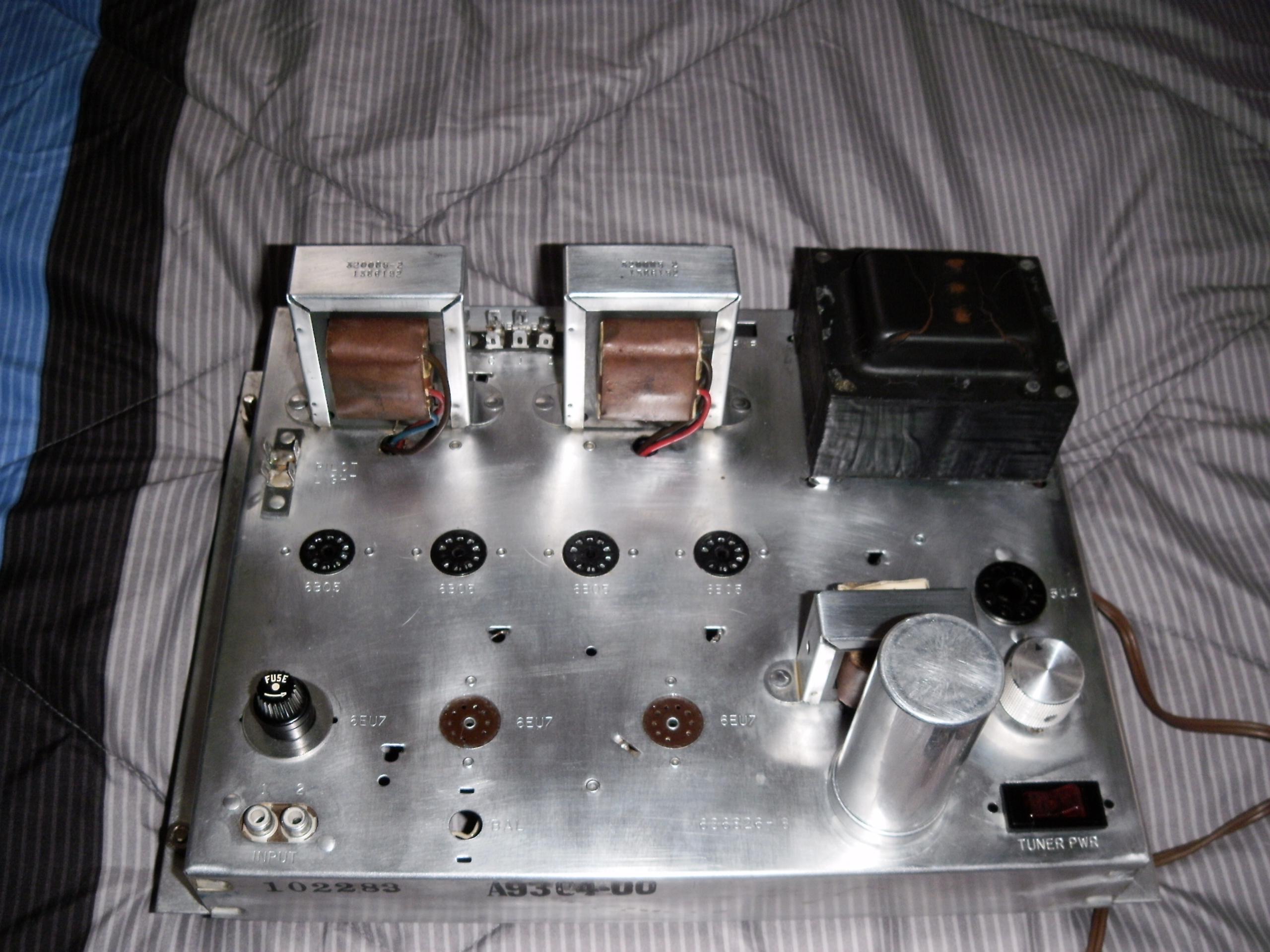

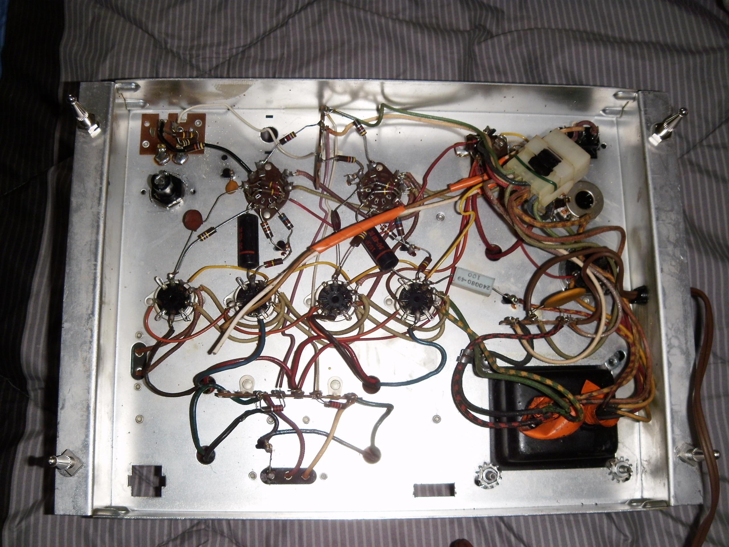

Thanks for all the help! Here are some pics of the amp. Im very new to this and have no shops n my area . Someone said rewire for 12ax7 how hard is that ?

Ok I hope this helps.. As you can see i have put in a main fuse for the power and power switch. Now the cap that i was talking about is the tall silver one, should that be replaced and under the hood I hope I dont have to replace all that? I do see two back looking cap should I replace them? The knob on there is one that I just put on for looks but there is a pot there and it says hum. I do have the top for the transformer and I was wondering if I should put two more fuses one for each output transformers?

You could possibly put an IEC power connector in the back left where the cutout is in back of the output transformer. However this requires you to run power up to the front left, across to the right and all the way back to the power transformer diagonal to the cutout.
The disadvantage of the fuse location is that you will route the power across the majority of the circuitry exposing it to potential hum.
I would recommend pulling the fuse from the current location and moving it to the right side where power comes in and you have the power switch. Change to a three prong power cord and tie earth to chassis through a 10R 2W resistor with anti-parallel 5A Schottky diodes in parallel with the resistor to minimize hum.
Your amp doesn't have the balance control shown on the schematic, so you should install two 390 Ohm resistors to ground to replace it (OR you could try to find a 750 Ohm pot that would fit...). They can go on the terminal strip at the top center of your picture. Gain will go up and your oscillation will probably not be heard from again.
The Sprague black caps with red letting are almost always good. The ones with yellow lettering (or multiple color stripes) are always bad. As far as rewiring for 12AX7, yes, it's more common, but 6EU7s cost less... _I_ wouldn't do it, and I have a few hundred 12AX7s in my basement...
