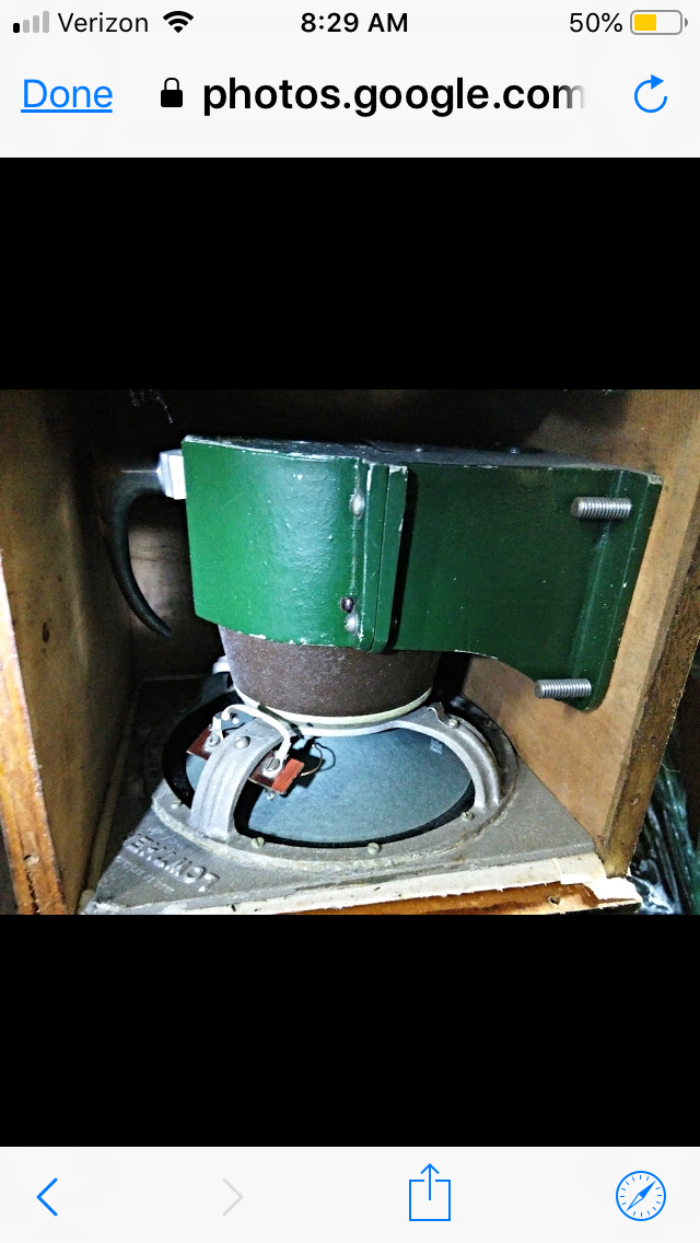

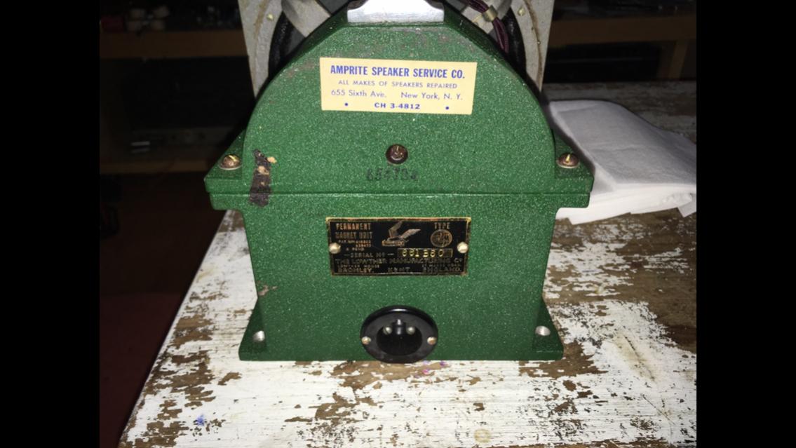

Saved this gem from the garbage collectors.
Looks like it was re-coned at some point. Have not tested DCR yet.
Came out of a Brociner corner horn. Hope to use as a mono
or better yet find it’s twin some day. Not bloody likely! The owner’s
eighty year old eyes lit up as he recalled buying the speaker and building a Heathkit Tube
amp to go with it. He then told be that all could bettered by a
a pair of Bose speakers. I smiled in apparent agreement and thought to
myself how rough it is to get old.

Wow, what a find.

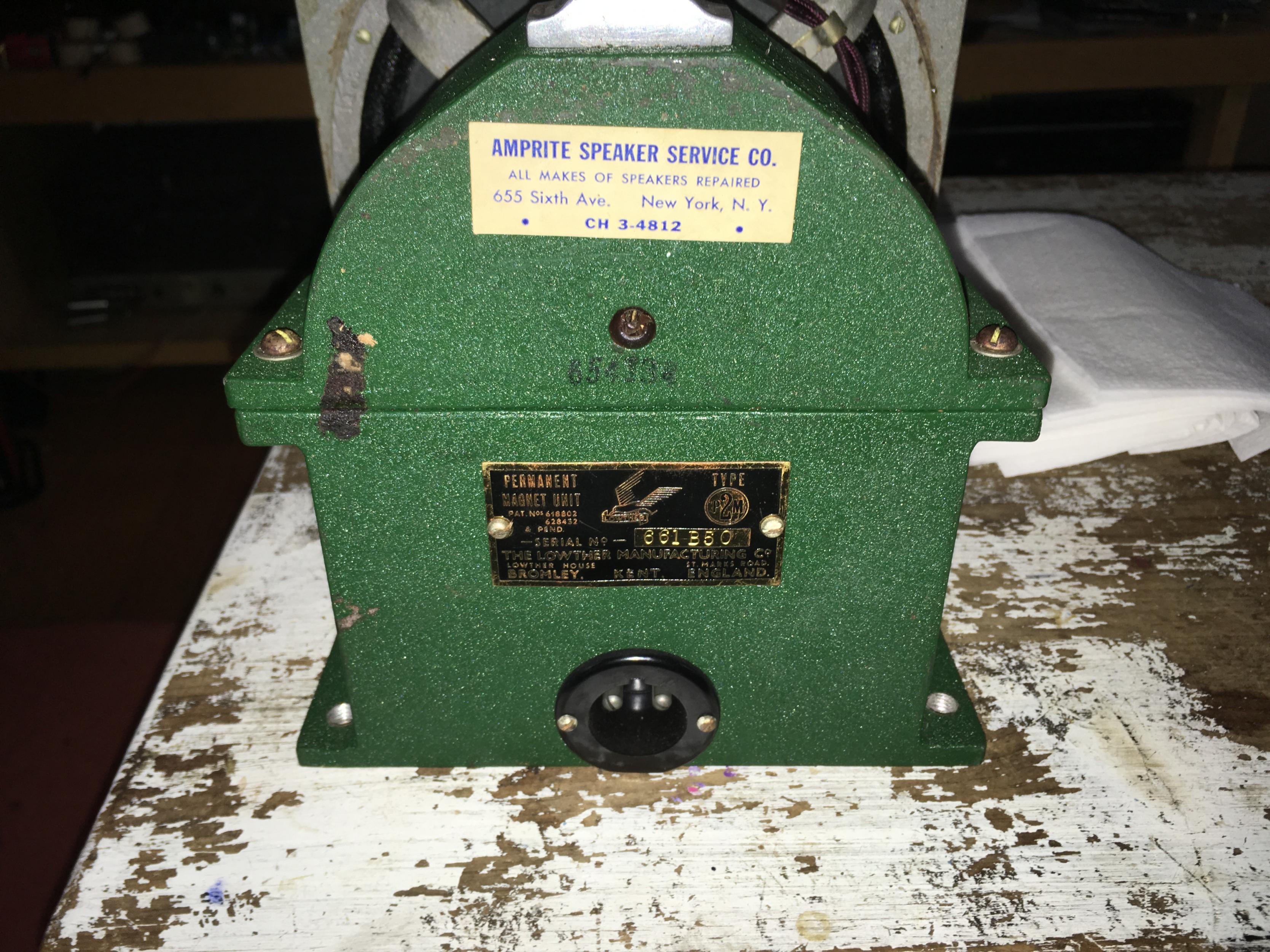

I cannot make out the writing on the back. Are you sure it is a PM2. Is that a power socket at the back, which would mean it is a field magnet. (If it has PM in the inscription then it will not be a field coil) If you want to find out more about it I suggest taking good photos and contacting John Howes at the Lowther Museum. He knows more than anyone about historic Lowther and Voigt drivers.
It certainly looks like a dogs breakfast of a recone. I would get it done properly.
Thanks for the feedback. I will contact John ASAP.

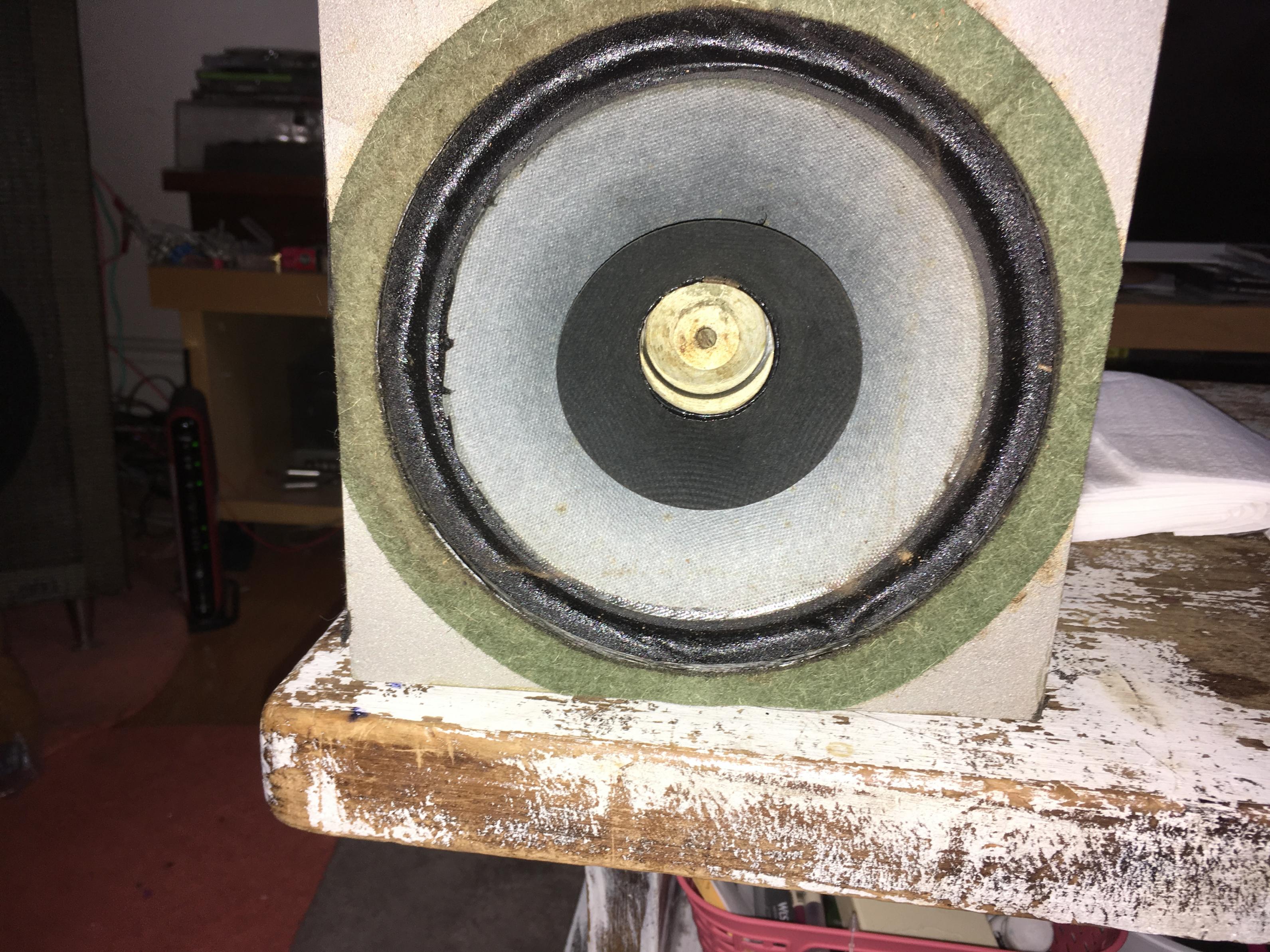

I’m including some higher resolution images. The badge says both
PM2 as well as “Permanent Magnet”. While inexperienced with field coils, I was hoping

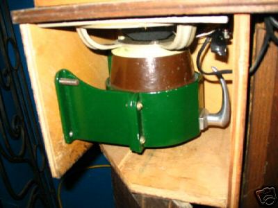

That I would find one inside. Over the moon to have a Lowther of any stripe however. I located images of other Brociner 4’s. They surprisingly show a similar cone,(dark blue grey) not the characteristic white. In fact the photo in the ad suggests the same. Should prove to be an interesting mystery. Thanks again.
I bought a pair of Lowther-based speakers from a guy in New Jersey that had the same cones. They were definitely not the correct cones for my speakers. And mine were also serviced by Amprite.
So either one of two things is true:
1.) Your speakers were also reconed, like mine, and the blue-grey cones we both ended up with are the type Amprite happened to think were best for Lowthers
2.) The blue-grey cones are appropriate for your Lowthers, so Amprite decided they would probably work in mine.

Thanks for the additional info. Check out the picture of the
Driver in this ad. The whizzer is definitely not white. I would argue that the
Main cone is in fact gray. That does not mean that our cones are original, only that they closely resemble the original cones.

Concerning post #9 the cones pictured at the bottom of the post look original but old. The paper Lowther used was thin and hard, and went "old paper brown" over time, not grey.

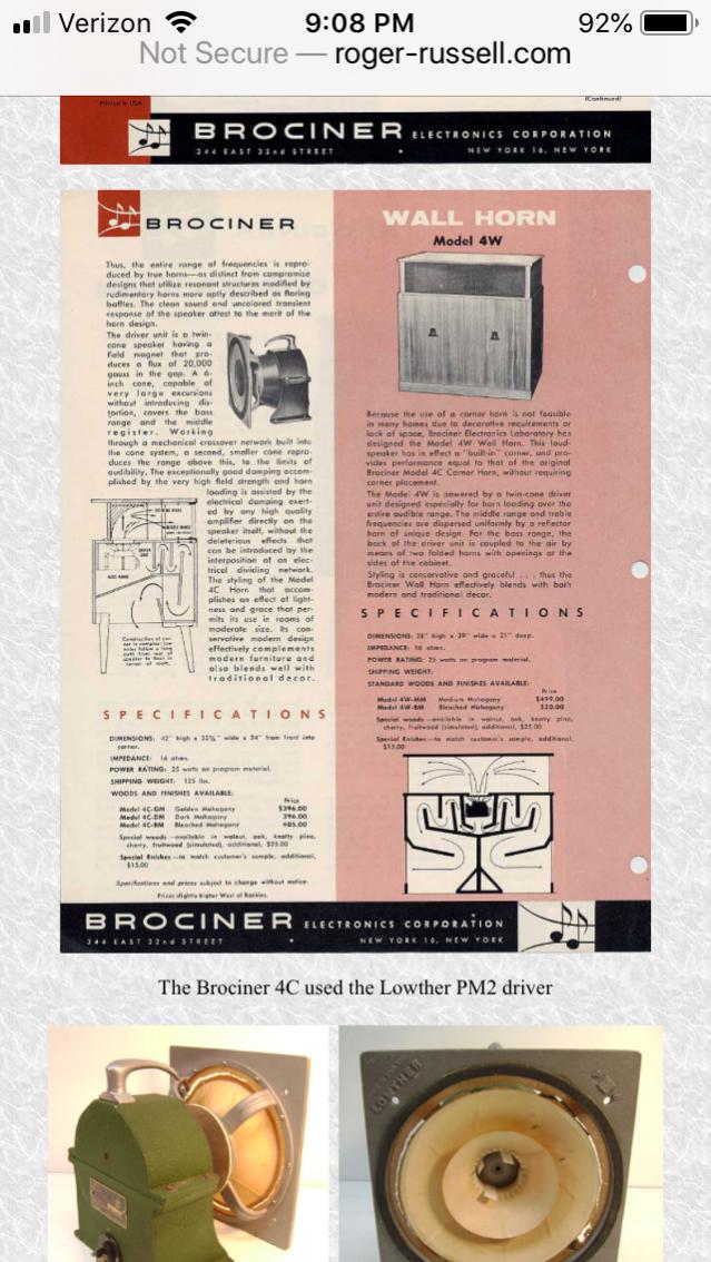

That said, because it's still quite possible your cones are original (they do match the photo, assuming it is not retouched) it would be prudent to leave them as-is until you know for sure. Your can get new Lowther-standard cones any day. But if it turns out your cone is an original cone, you will never find an OEM replacement.
I'm changing my tune a bit, by the way, because I came across another photo of a Brociner 4C with your cone (see attached).
What are the chances that these 3 different specimens of this driver were all re-coned the same, and with cones that match the sales literature?
