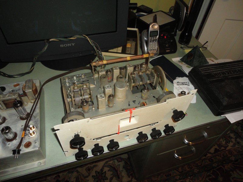

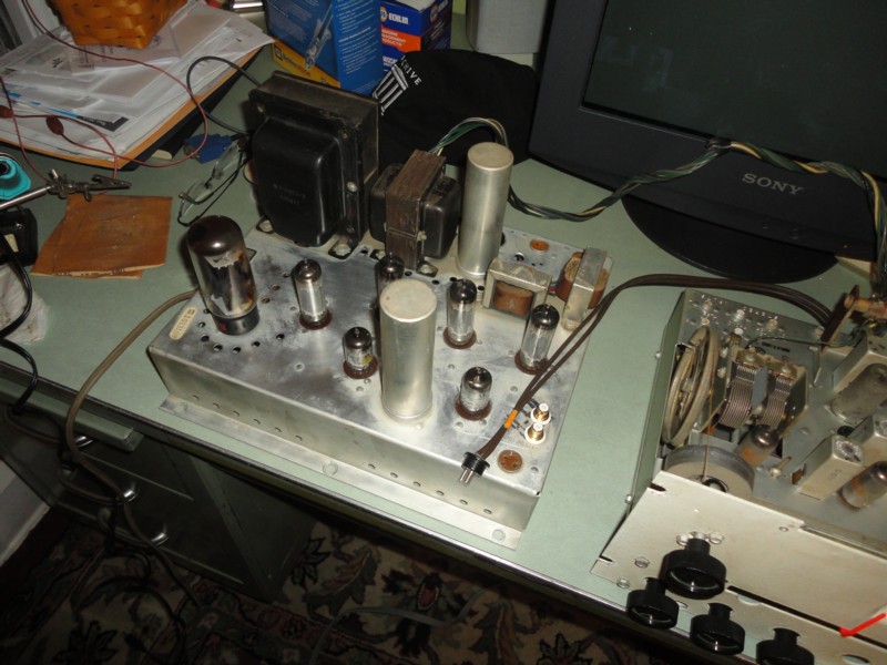

I recently acquired an early 60's Hoffman tube based console stereo. I'd like to retrofit the amp to use it my NAD receiver; preamp out to the Hoffman amp.
Problem: I've added chassis mounted RCA plugs and wired them to replace the original 3 pin DIN audio input. When I use the RCA's I get a loud fump, fump fump sound. If I run the NAD as line-input into the Hoffman preamp and use the preamp-to-amp DIN connection it works fine.
Can anyone offer suggestions on how to track down the problem?

No proper chassis ground. 2 prong non-polarized cord by the looks of it.
By the looks of the left unit (which appears to have the PS for the right unit and ac out for phono) it has a power transformer and choke. In which case it is relatively safe but still needs a fuse and 3 prong power cord properly installed.
Once that is done, proceed with isolating the fault. The proper three prong grounded power cord may actually solve your problem.

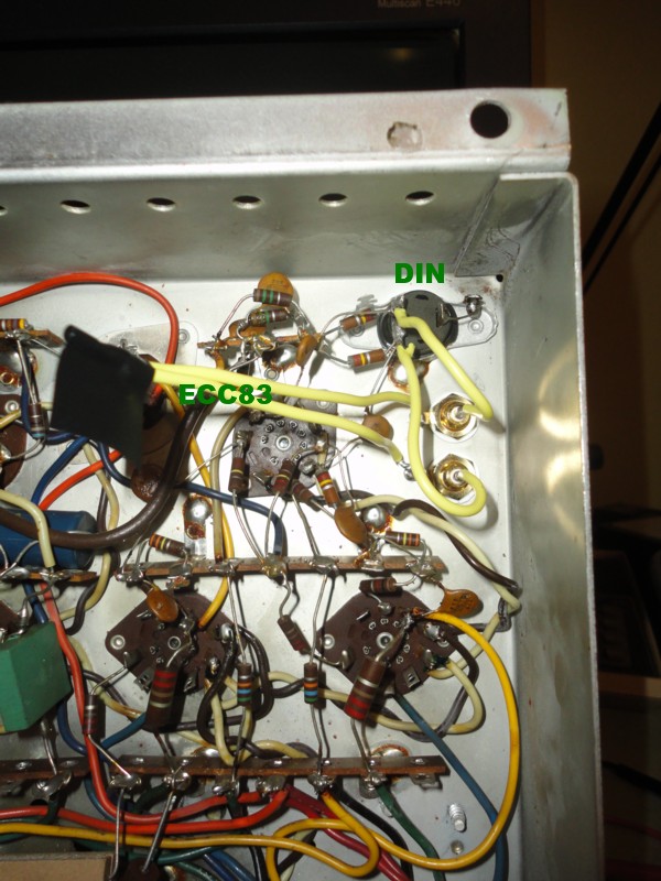

Here's what time would permit me to try:
1) Disconnected the ground from the RCA's at the Hoffman Amp Chassis. Noise is still there.
2) Verified no short in the RCA plugs with chassis ground
This weekend I'll try installing a 3 pronged power cord. Also, there is already a fuse, but wasn't shown in pics.
Attached is a pic of the underside showing RCA w/ground disconnected and a cheesy schematic of the input.
Thanks for the replies, it gives me something to move ahead with,
John

Just dropping in here (late to the conversation).
The amp was working fine using the DIN inputs from the preamp?
The working theory is that adding the RCA connections caused the 'thump-thump' to start?
Perhaps it is just a coincidence, and another problem is surfacing here? Or you have disturbed a connection while wiring in the RCAs?
Disconnect the remaining RCA yellow (signal) wires from the DIN jack...ie go back to the 'before RCA' stage.
Does the amp work properly now?
If 'Yes' then the amp is looking for 2 signal wires with common ground tied to chassis at the DIN jack. And the DIN cable should be connecting back to the preamp the same way the RCAs would.......
Start adding back the RCAs- ground first (tie the two RCA lugs together then to DIN gnd with the shortest wire possible.). Test with input on DIN.
The add short jumpers from the RCA signal connectors to the DIN.
Test.
Short the RCA inputs to ground. (RCA shorting plugs are handy and can be made in a minute from an old/cheap interconnect.)
Test
Connect RCA cables to preamp- preamp power off.
Test
