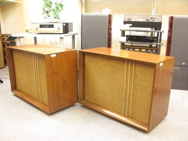

I don't know very much about these speakers except for what I've been able to learn from their user's manual that I found online. They seem to have been produced in the early 1960s and feature a 3-way design with an 18" woofer(!), an 8" midbass, and a horn tweeter. They can be bi-amped and the power handling for the mid and tweeter section seems rather low, thus I am surmising that they are relatively high sensitivity, but I don't know this for sure. I think the original price as $250 each. I attached a random image of them that I found online.
Are these speakers any good? I don't really have a place to put them (they are really large boxes) and I'm wondering if I'm making a mistake by passing them up. Any input would be appreciated.

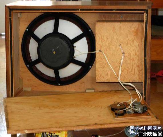

It doesn't seem that there are many high-resolution images of these speakers posted anywhere. Here is an image of an open speaker that I found online. This is pretty much what I saw yesterday when I went to look at them. The surround on the woofer is cloth and the crossovers are clearly period pieces. The coils are hand wound, looks like a wax cap and a 1w or 2w carbon comp resistor.

... The surround on the woofer is cloth and the crossovers are clearly period pieces. The coils are hand wound, looks like a wax cap and a 1w or 2w carbon comp resistor.
That picture looks so shoddy by today's standards. Handfull of screws holding the large back panel. Only the coils will not need to be replaced. 6dB XO?

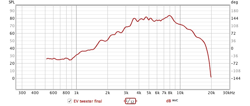

Freddi reminded me of my tests not long ago of an ancient T35 EV tweeter I had sitting around for decades and which was highly regarded in 1960: moderate amount of distortion (about 1%) but not a lot of high-end. The lines are 2dB apart.
