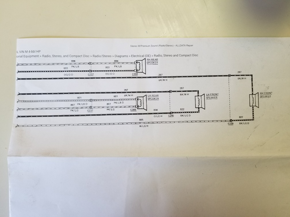

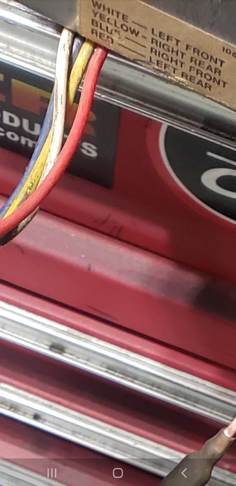

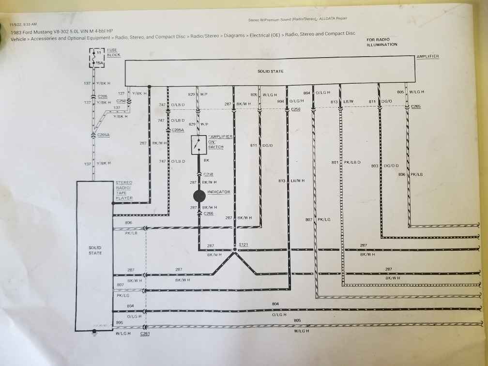

I understand that part. But the head unit doesn't have the negative side for each speaker channel. So what do I do with the left over negative speaker input wires of the LOC, do the just get connected to the head unit case ground? Here is a few pictures for clarity regarding what I have. The Head unit has 3 other wires not pictured for Bat+ GND and Illum.

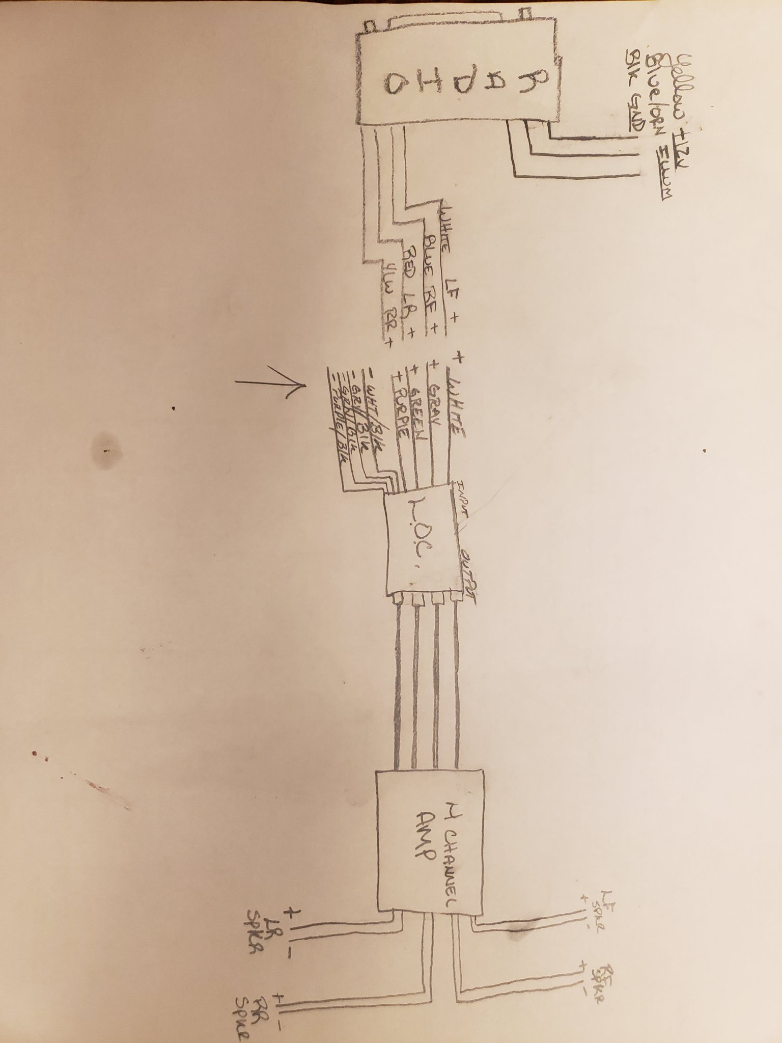

I would have "left over" wires on the input side of the LOC if i eliminated the factory amp. The negative side of the speaker wire is only between the factory amp and speaker... That is the whole basis of my question. I made a quick drawing of my idea or thought with the factory amp removed, is it a possibility?

The only way I could do what you are suggesting is to leave the factory amp in place and working. Is that what your suggesting will work.
Radio to factory amp to LOC to new amp to speakers?
It appears that the head unit has a common ground for the speakers. That would mean that the four negative input wires to the LOC would go to the speaker ground.
Before you make this connection, confirm that all speaker wires are at 0v DC with the head unit on and that the negative speaker wire reads 0 ohms to ground (head unit off).

You can "piggy back"as you say the LOC to provide INPUT signal for your aftermarket amplifier and retain the stock amplifier system as is. REMEMBER you will also need a switched REMOTE wire for the aftermarket amp and take note, the RADIO 12 volt Electric ANTENNA trigger wire in many OLDER stereos will DEACTIVATE upon CASSETTE use. Antenna goes down when you are using the TAPE player section. How it WAS... still is. As the LOC goes you are just tapping into the speaker + for signal L&R... and ground for the negatives on the LOC BUT check to see if grounding HELPS or HURTS things. Because your radio is still attached to the stock amp it will send a signal + through the LOC likely regardless of them negatives being hooked up. In fact they can sometimes add ENGINE NOISE where there was none. EXPERIMENT with them.... Have fun.... Such can be the "Piggy Back" mentality of Autosound.... WHATEVER WORKS.... works. Good Luck with your experiment and FUSE at the BATTERY for your after market amp.... always. NJOY/BDBD/2023.
