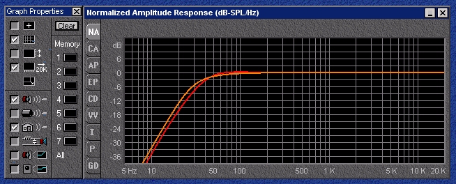

I could go on, ad nauseum, but below are the Theile/Small parameters for a perfectly good working W15CS. The vents have been normalised for 0.75 inch, the thickness of the front panel. While small by some standards, this will apply the brakes, so to speak, to the diaphragm at large excursions. In the unit I still use, diaphragm excursions approaching 2mm will rattle anything that isn't nailed down. I used the 9.25 ft^3 alignment because I still have and use the Briggs' three way a half brother built in 1957 anong with the EICO HF60 preamp and HF-30 power amp, both restored.
Assuming a power input of 30 watts, the maximum acoustic power at 1m with a 4mm excursion is 113 dB. From there, it falls to a minimum of 105 dB at 34 hz. That's assuming a 4mm excursion. With a 2mm excursion, those figures are decreased by 6 dB. A corner placement is recommended as is internal bracing. The W15 doesn't lend itself to front loading very easily so I would recommend moving the front baffle back an extra 0.75 inch and rear mount the speaker onto a removable plate. Use T-nuts. As for the internal bracing, three pieces of wood (NOT plywood or MDF) about 1.5 inches square, glued and screwed to the inside panels and mutually perpendicular, so all 3 can be glued and/or bolted together at the intersection.
Here's the numbers and the alignments for both cabinet volumes.
Driver PropertiesName: W15CSD
Type: Standard one-way driver
Company: Wharfedale
Comment: Yasumasa
No. of Drivers = 1
Fs = 24.02 Hz
Qms = 5.998
Vas = 551.6 liters
Cms = 879.6 µm/N
Mms = 49.92 g
Rms = 2.769 lb/s
Xmax = 4 mm
Xmech = 0.236 in
P-Dia = 11.45 in
Sd = 0.0665 sq.m
P-Vd = 0.00939 cu.ft
Qes = 0.334
Re = 9.8 ohms
Z = 11.76 ohms
BL = 14.88 Tm
Pe = 50 watts
Qts = 0.316
no = 2.188 %
1-W SPL = 95.6 dB
2.83-V SPL = 94.72 dB
Box Properties
Name:
Type: Vented Box
Shape: Prism, square (optimum)
Vb = 6 cu.ft
Fb = 29.6 Hz
QL = 5.696
F3 = 40.73 Hz
Fill = minimal
No. of Vents = 1
Vent shape = round
Vent ends = one flush
Dv = 2.973 in (3")
Lv = 0.75 in
Driver Properties
Company: Wharfedale
Comment: Yasumasa
No. of Drivers = 1
Fs = 24.02 Hz
Qms = 5.998
Vas = 551.6 liters
Cms = 879.6 µm/N
Mms = 49.92 g
Rms = 2.769 lb/s
Xmax = 4 mm
Xmech = 0.236 in
P-Dia = 11.45 in
Sd = 0.0665 sq.m
Qes = 0.334
Re = 9.8 ohms
Z = 11.76 ohms
BL = 14.88 Tm
Pe = 50 watts
Qts = 0.316
no = 2.188 %
1-W SPL = 95.6 dB
Box Properties
Name:
Type: Vented Box
Vb = 9.25 cu.ft
Fb = 26.42 Hz
QL = 5.696
F3 = 37.73 Hz
Fill = normal
No. of Vents = 1
Vent shape = round
Dv = 3.651 in (3 5/8")
Lv = 0.75 in
