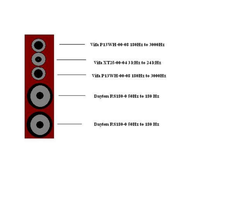

Vifa Xt25 + P13wh + Dayton RS180-8 your thoughts?
Guys need your input on this planned 3-Way.
I have been going back and forth on driver selection. I ditched the Dayton 2" dome in favor of the P13WH that many on the forum like.
Objectives are having a versatile system that is capable of hi-end sound as well as ability to take abuse from my big SS amps without "poofing" up or blaring. I am ok with F3 of 50Hz at -3db.
So far I have come up with a rudimentary design with MTM with the Vifa and XT25. 2 Vifa's in Parallel will give me 4 ohms same as the Xt25. Crossover will be at 3kHz .
Two Dayton RS180-8's will be paralleled for again 4 ohms and crossed over at 180Hz. Rudimentary box design pic is attached.
Any ideas /thoughts/ comments are appreciated.
K-
Thanks Dave,
Speakerbuilder noob here so please share your thoughts on the following:
1) What do you think about the driver selection/ interaction?
2) Putting a mid on the rear would reduce output on the front, it would also lose the D-appolito configuration... obviously you think it does not matter hence your stance... can u explain?
3) Baffle step... for time alignment?
4) Why put woofer on the rear?
5) What is push push? Isnt that the way it is? or Is that where one driver is installed on the rear but cones of both are oriented towards the listener.
Thanksa again!!

K-amps said:
Thanks Dave,
The P13 has such a nice extended response and smooth roll off, it should work well with most tweeters, and be an excellent match w/the XT25.
Bipole is an interesting design approach, but, not used nearly as commonly as MTM, TM, etc... We can guess that there must be a reason for that? Though I do advocate placing a tweeter on the rear for more even "power distribution".
No, he's not refering to a physically stepped baffle, "baffle step" is something different... Look up "baffle step compensation" or "BSC" - the on axis response will be made uneven by the boost of radiating into "2PI" vs "4PI" space, this boost varies as the frequency changes due to the change in the wavelength of sound corresponding to the size of the baffle affecting directionality of the output.
To make a bipole configuration, it affects the BSC, you'd probably want to google "bipole" for more info on that.
Huh? If one cone was on the rear, then it couldn't be pointed at the listener, but perhaps you mean mounted so that the back of the cone is sticking out? That is one way of doing it. "push push" with one mounted on the rear means that both drivers are in phase, both have their cones "pushing" out or in at the same time. If one cone was mounted with it's front face expose and the other with it's backside exposed, then they would be wired out of phase, but they would still be in phase, because one is reversed. Some people would say that some of the distortion coming from the back of the cone will be different from that coming from the front, and setting them up that way could be slightly superior due to that.
If one cone was mounted on the front and one in the back, except in a "push-pull" configuration then that would be called dipole (I think, is there a more specific term when using two woofers vs open baffle dipole?) though the more common way to do dipole is "open baffle".
Not too sure why you'd put the P13s in parallel. Or have two at all. Why not just build a nice 3-way with one P13?
In a 3-way, there's midrange gain to consider. Any crossover software will show you this. Therefore it's not necessary to match the impedance of the mid to the tweeter--the gain will cover it. In fact, you may end up doing things to damp the mid. If you use two mids to get a lower impedance, they'll dominate for sure.
Mos
You could put two P13s wired in series if you wanted greater power handling, or, if you wanted to crossover lower than you would otherwise want to with one of them.
Personally, I think one P13 crossed over to a quality woofer or two should be able to play plenty loud.
Say, one P13 crossed over to a couple RS225s at somewhere around 200 - 300 Hz, then matched with a good tweeter, could make a very good sounding system capable of high output for something not based on pro-sound drivers. (or, do the RS225s in a 2.5 configuration to cover (part of?) the BSC)
I'm not aware of a crossover where the top part of the BSC is done on the mid but the bulk/lower portion of the BSC done on 1 of 2 woofers?
Another interesting configuration would be one P13WH, and four Tang Band W6-1139SI 6-1/2" Subwoofers wired series/parallel for the same net impedance as one but greater sensitivity, and a healthy amount of output below 30Hz. All on a narrow front baffle.

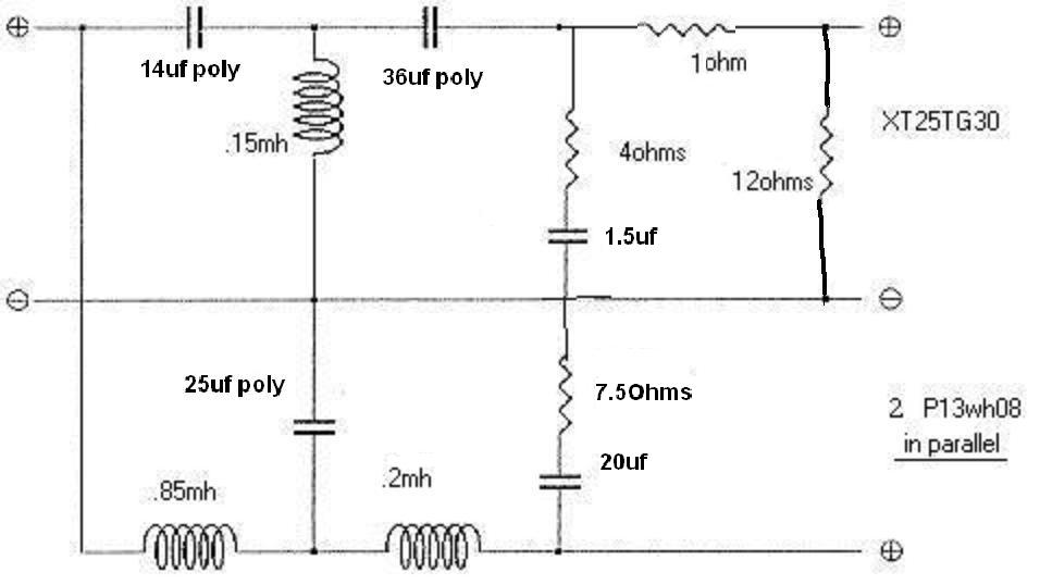

Crossover for P13's and Xt25
I've been using these drivers in an MTM for a couple years now with a 3rd order X/O at 3kHz and recently upgraded the tweeter caps to film & foil.
Great sound and nice, flat response in a vented enclosure (f3 is arount 70Hz).
Here is my crossover if you care to try it; the Lpad resistors can be adjusted/omitted, depending on your taste.
-chas
sreten said:
The RS180-8 at 85dB each mean the mid range will be ~ 85dB
will full BSC and 88dB with 3dB of BSC, basically you do not
need 2 P13's, one will be fine, unless your planning no BSC.
sreten: funny you should mention that, I was just thinking of using two RS225S-8 and one P13WH. After taking a second look, and thinking I don't want a larger cabinet than 2 cu feet, perhaps a pair of the RS225-4 in series would be better?
