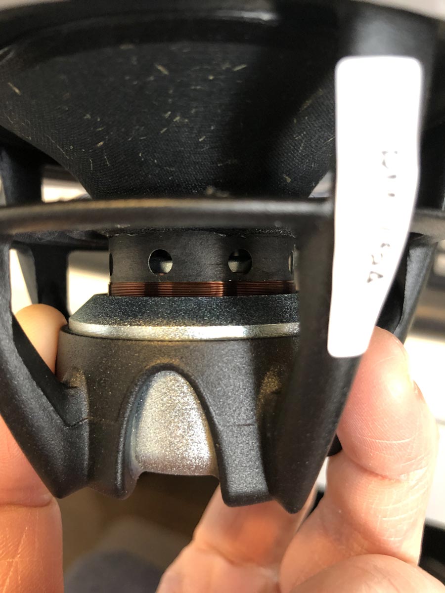

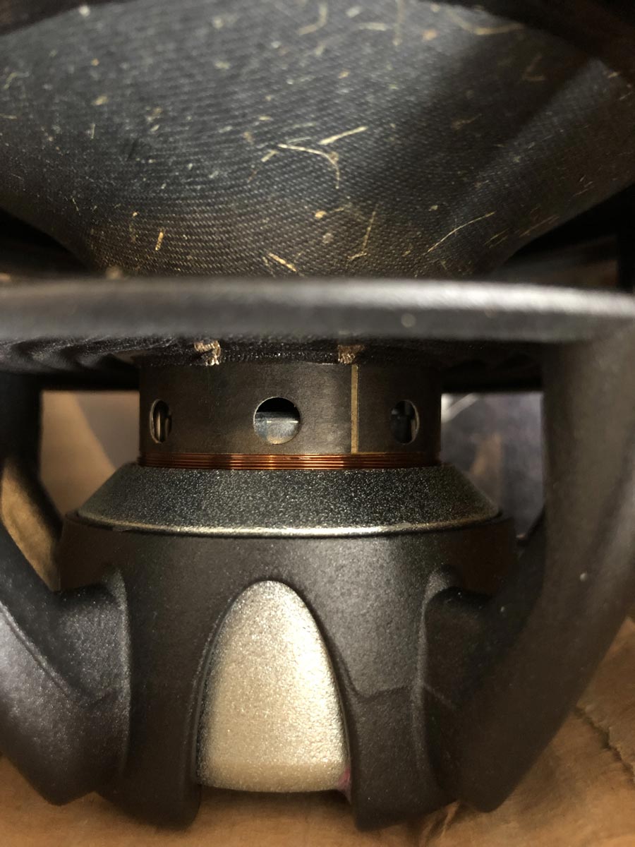

Here's mine. Honestly these drivers are never very consistent. Some of my early NE149s makes mechanical noises in suspension.
NE149:
NE123(have label RM VIFA 4'' or something like that)
NE149:
