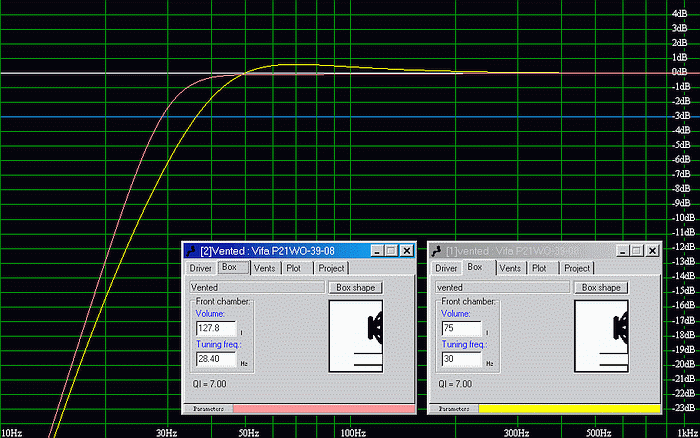

Below is the WinISD gain chart for my chosen response.
The default volume was 127 litres - too big! So I simply pulled it back to 75 litres and upped the Fb to 30hz. F3 of 36hz.
Things look pretty good. That small <1dB bump above the line shouldn't be a problem. Right?
I'm crossing to a P13 at approx 300hz. Anyone see a problem with this config? Could it be better, keeping in mind my desire to keep the box volume at sub-refrigerator size. Any feedback?
Thanks.
Mos
