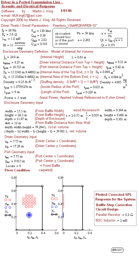

Fantastic. Thanks 🙂 Funny, my calculations were not too far from that. I worked out a box of 2.13cf (vented) and a tuning of 27Hz (which is the same as the FS roughly...not sure if thats bad or not).

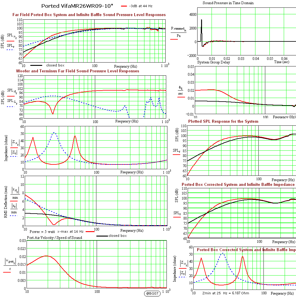

Submitting a new simulation, close to a ported Bessel alignment in a 59 L (2.084 cu. feet) box or with a closed port, a Qtc very near a second order Bessel is achieved, in my opinion both very good choices for use as ‘musical subs’ and stands for your bookshelf speakers.
