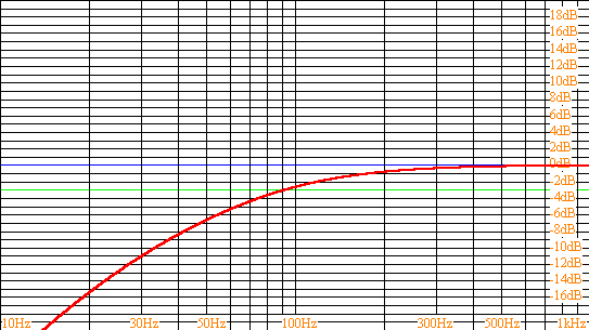

I simulated unenclosed response on WinISD by calling for a closed box of 20 cubic feet. That is so large that for this woofer, it is the same as unenclosed.
It seems to be an 88 dB @ 1W/1M speaker. Both of the plots seem to agree with each other at beginning of rolloff, and at 50 Hz, 30 Hz and 20 Hz.
With no simulations for a specific box, this was the best I could do.

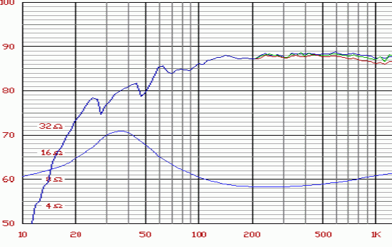

I will put Vifa's free air response chart and WinISD's equivalent here and see what you think.
Don't forget on Vifa's real-life version, there are some peaks in the response so you have to sort of average those out when you compare them to the WinISD chart. When you do that, there seems to be reasonably good agreement between the two charts.
Here is Vifa's chart.
Those are some pretty dramatic peaks & dips in the response -- i guess those must be room artifacts, since they say that 100 Hz is the anechoic limit of their test room.

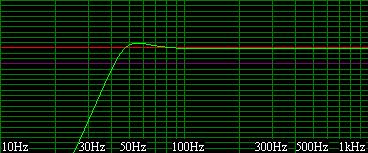

I was checking the graph on the second page of http://www.partsexpress.com/pdf/297-305.pdf under the applications part, bass reflex synthesis. If you take a look at it, I was looking at 30l with 45Hz tuning (5cmx4xm port).
The WinISD one (seen below) with the same box specs shows a 1dB peak for a while before the rolloff (I know if just 1dB, but I'm curious why the two graphs aren't identical) while vifas graph doesn't show any peaks at all.

If anything, I am surprised the hump isn't bigger.
The Vifa has a Qts of .4.
Ideal for a Vb equal to Vas.
Here, Vb is 60% of Vas.
When a speaker goes into a box smaller than it's ideal match, you generally get a hump in the response.
If anything, Parts Express would seem to be off.

Here is another anomaly. According t WinISD, a 5cm dia tube of 4 cm length tunes a 30 liter enclosure to 50 Hz. This gives a much bigger hump.
However, the response will be 6 dB down at 40 Hz, which agrees with the graph at Parts Express.
Here is the WinISD simulation with the port made to be 5 cm diameter times 4 cm long.
Go figure!

The Java based "Port Designer" at Steve Ekblad's site says that a 5 cm dia vent of 4 cm length tunes a 30 liter box to 51 Hz-close enough to WinISD's 50 Hz.
The Port Designer uses cubic feet and inches.
30 liter = 1.06 cu ft.
5 cm = 2 in
4 cm = 1.6 in
http://www.wssh.net/~wattsup/audio/
I'll bet most programs agree with WinISD. I think Vifa made a mistake, or did the chart when the Thiele-Small parameters were different from now and never changed the chart.
