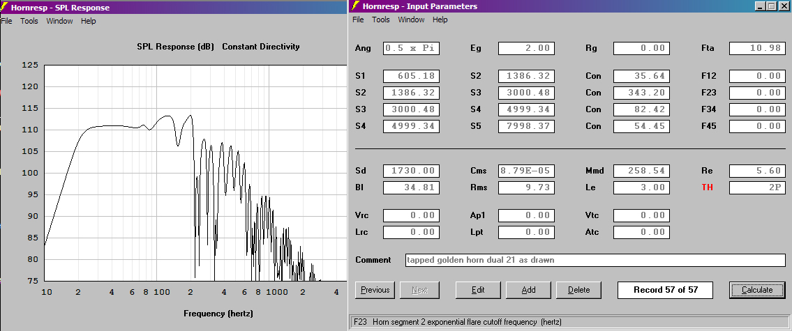

This is what I've come up with using two RCF LF21N451 drivers:

The sim looks good. Is that 1 watt though? 5.6 ohms per driver and 2 Volts...

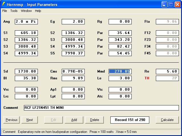

RCF calls the driver an 8 ohm device, so with two in parallel I set Hornresp to 1W at 4 ohm. In the club in question, the plan is to drive the sub with their existing QSC RMX 2450.

The cabinet minimum impedance is near the DCR, the cabinet is 2.8 ohms, not 4.
The 1/8 space response (.5 Pi in Hornresp) is generally unrealistic in most rooms, and exaggerates the LF response.
When modeled in half space (2pi in Hornresp) the Victor hits Xmax at 69 volts (about 2070 watts) and can do about 132 dB at 80 Hz, 130 dB at 27 Hz, an F3 of about 21 Hz.

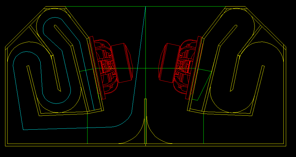

Any chance of some dimensions on you drawing?
Even basic dimensions will help to calculate if the volume is close to the sim volume.
The folding looks quite complicated. For instance the third 180 deg bend looks to be smaller on the way out, than it does on the way in.😉
With a bit of work it is possible to plot out the horn path from the folded drawing and get a more accurate representation of the actual horn shape.
Looks like Akabak might be required, there are lots of differing horn taper angles in your set out.

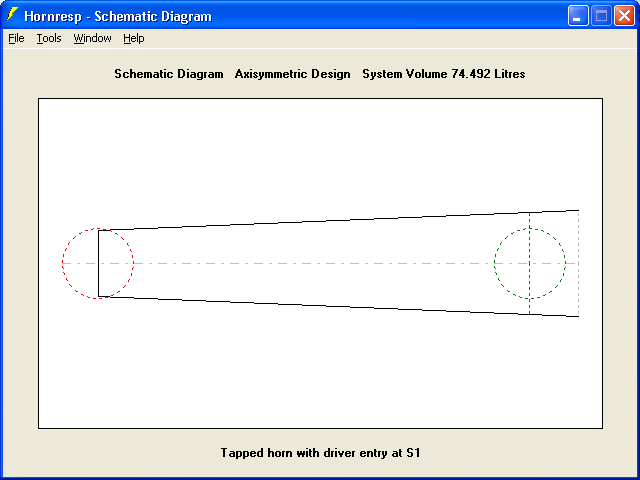

As far as Neo Dan's suggestion about using "Parabolic", which better simulates the expansion of horns built with parallel top and bottom sections, I was going to mention it, but having tried your sim with both conical and parabolic and getting basically the same result I thought I'd let it slide 😉.
I made the same mistake myself, took a while before I realized a conical expansion looks like a pyramid rather than a wedge of cheese, and a wedge of cheese has a parabolic expansion even though the sides are straight...

hi trackzilla
i can see there are some mistakes in your drawing.
if you post the dwg file here ,i might be able to correct them.
also i would strongly suggest to split the cabs in 2 ,if you want to make it mobile at some point and to support the mouth section.

The basic plan has always been to split the cab own the middle creating two cabs for mobile use, but for the installed one I had planned to make the big dog.
Weltersys: I was already aware of the con/par difference, but as you said, in this case the difference is quite nominal so I just left it.
This drawing is obviously just the fold and no bracing, I had planned to add bracing between many of the panels, and to keep them as 4-6" slabs so I didn't 'compartmentize' the horn path unnecessarily.
The drawing there is a 4'x8' rectangle and the cabinet is 2' tall (internal dim 22.5" after a 3/4" ply on each face)
Xoc1: thanks, looks like when I folded that corner I forgot to compensate for the ply and then compounded that error when I slapped the external piece on the drawing.

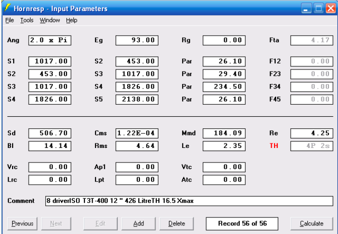

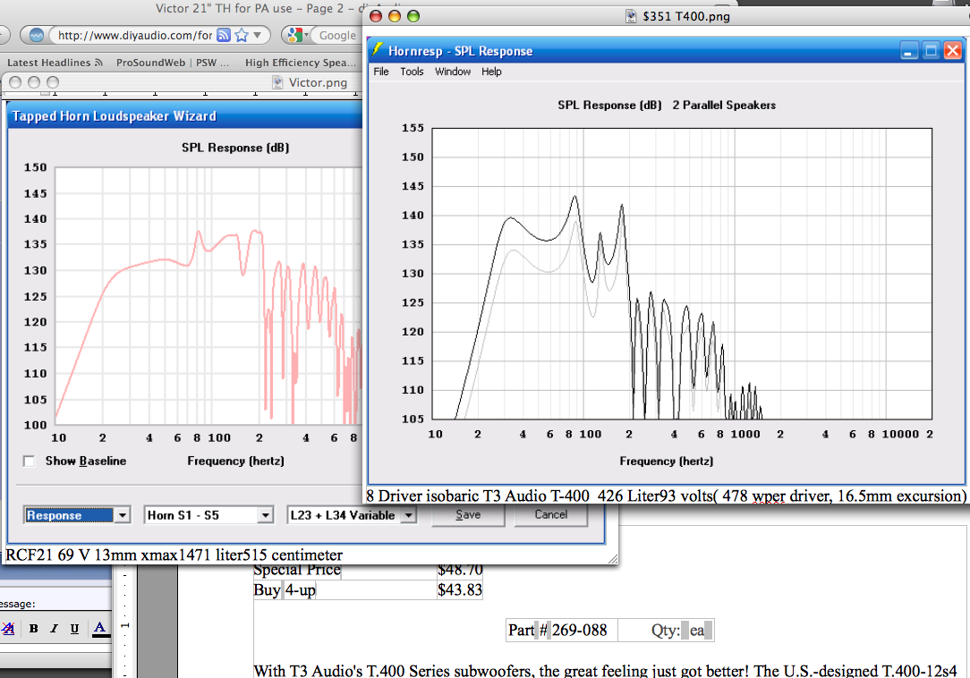

Below is the RCF 21" "Victor" compared to some Parts express buyout speakers, the T3 Audio T400-12S4 12" 400 Watt 4 Ohm (PN269-088) for $43.83 apiece, looks like using two cabinets each with 8 speakers in isobaric pairs each in a 426 liter box.
The 16 cheapo buyout drivers cost half as much as a pair of RCF 21", and have almost 10 dB more output at 30 Hz (5 dB less output at 20 Hz), in a pair of boxes a that only take up 58% of the space as the Victor.
The face to face iso loading would cancel even order harmonics, just tried some other $5 buyout drivers in an iso reverse taper TH, even at well above Xmax, the even order harmonics were almost gone, though the ugly sounding odd order harmonics were there...
http://www.diyaudio.com/forums/subwoofers/206955-10-plus-wood-18hz-isot-tqwp-sub.html

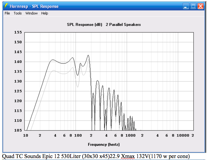

A pair of quad TC Epic 12" would do almost 10 dB more level than the Victor in about 2/3s the space, but cost a bit more for the drivers.
The Dayton Titanic III were similar to the TC Epic 12" sims.
Anyway, there seems to be some low cost options to make some low bass.
