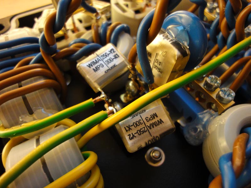

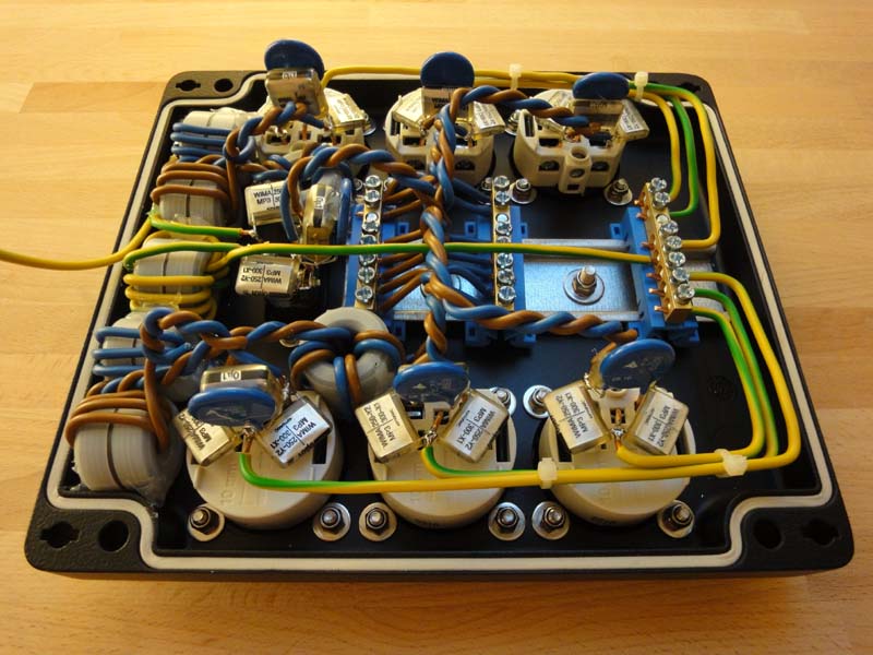

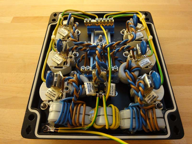

I based my filtered power strip on the following designs which have been discussed here already and altered them for my needs:
Jon Risch
Lampizator

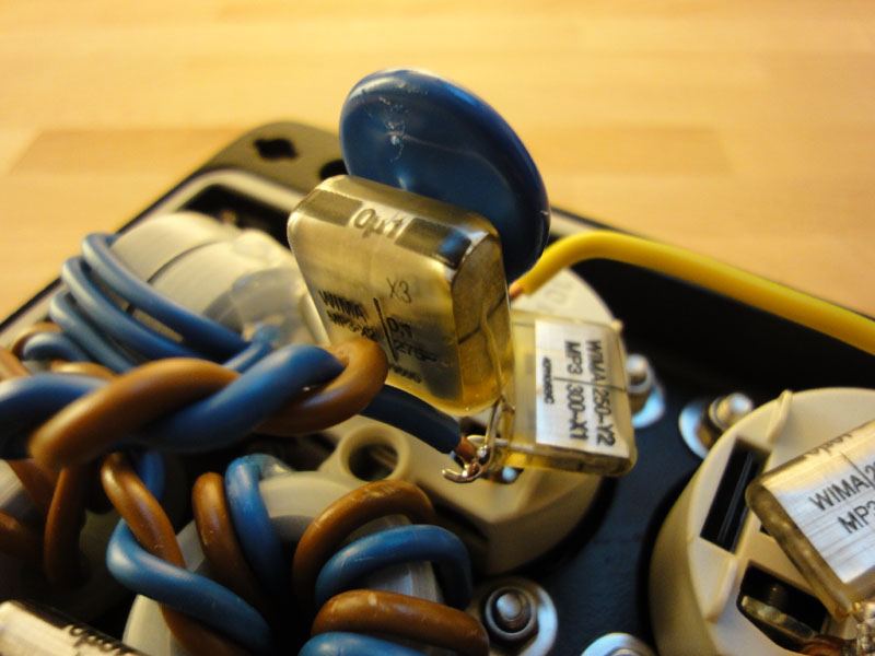

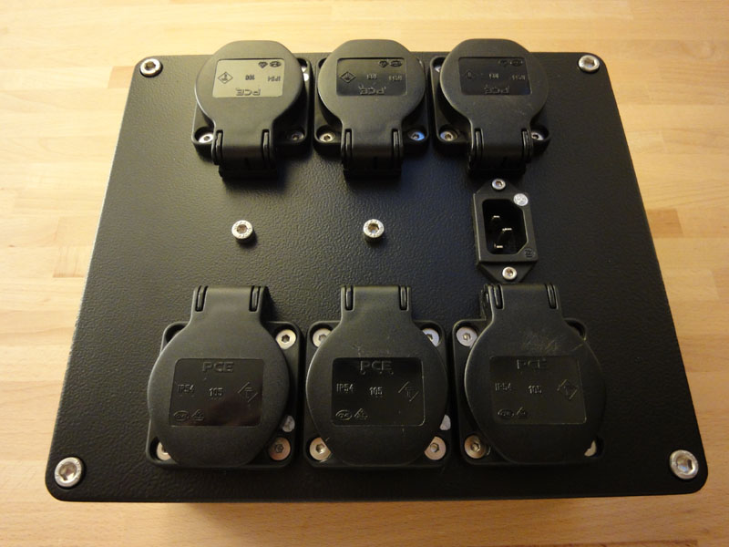

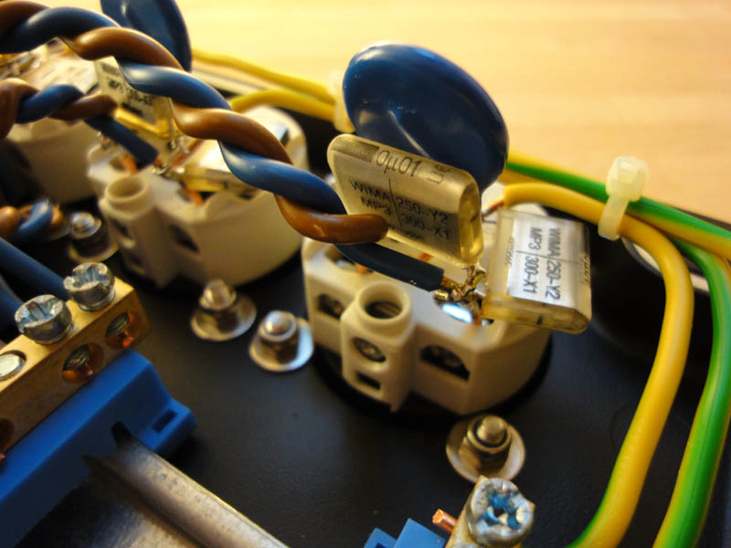

For the filtering caps, I used 100nF Wima MP3 X2 rated and 10nF Wima MP3 Y2 rated – theses are the best for this application. The varistors are Epcos S20K300, the chokes are wire wound with iron powder cores and the wire is 2,5mm² solid core copper. As casing, I used an IP65 cast aluminium block which I filled with sand – the total weight of the filtered power strip is about 8kg.
My system consists of a choice of CD players (Philips CD304, Philips CD304 MKII, both no oversampling and heavily modified, T+A DVD1210R), TMR CMA1 amplifier (from a German High End manufacturer) and Dynaudio Contour 1.3 stand mount speakers. I use a variety of cables, either commercial or DIY types.
