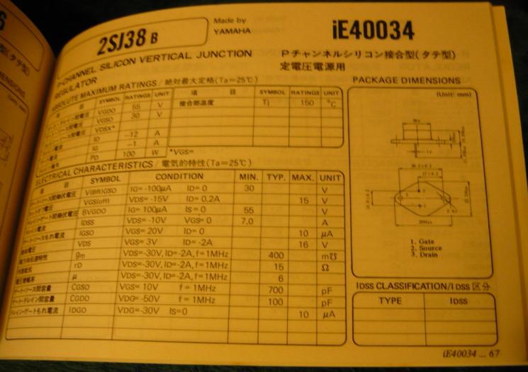

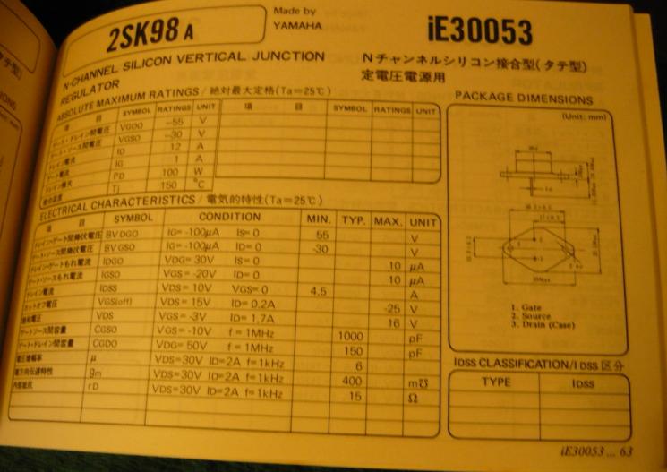

Just in case someone would find these handy...

Nice! Thanks. Do you have datahseets for 2SK70/2SJ20?
Sorry, no NEC data sheets in my collection. FWIW, I found the Yamaha ones here, and I do have a (printed) Sony data book that has J18, K60, K63 & K79.
