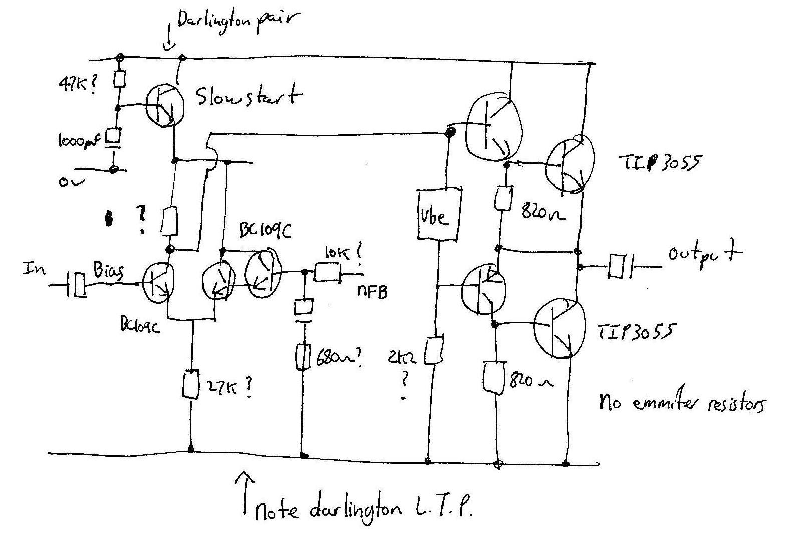

This amplifier appeared in Practical Wireless in 1978 ? and was designed by a B.C. Toms ? It went under the name of the "Europa" and the power amp I have drawn in outline from memory... the preamp was awful, used an LM381AN that was spectacularly bad on all fronts.
I built this at the time, the first "proper" amp I made from scratch and always remember the wonderful musical sound it seemed to have (without the preamp). It was AC coupled and ran on a 56 volt rail.
Aside from it being a quasi design look at the input stage and the darlington arrangement on the "inverting" input to the amp. At the time I didn't think it particularly odd, but of course it is. I have never seen this done before, the "balance" of the stage must be awful, but how would that arrangement affect the distribution of harmonics etc. It sounded good though.

hello Mooly,
don't you think that the NPN transistor that you sketched in the power amplifier as darlington on the inverting input, was in reality a PNP transistor connected as voltage gain stage, with the emitter connected to the positive suppy rail, the base connected to the collector of the inverting input, and the collector connected to the upper side of the bias generator ?
Also, there may have been a bootstrap capacitor, for increasing the open-loop gain of the PNP voltage gain stage.

Hi Mooly, Steph may be right about the circuit of the inverting input. It certainly doesn't seem warranted there. If it comes from a schematic, there may be an error there. It would not be the first time draughting and PCB designs disagreed.
This is unashamedly a 2 stage design and difficult to analyse owing to the dual roles of the driver transistor. However it is often good to read the background to a design in order to understand why and how these crazy topologies arose.
Access to JLH's 2-stage design details might shed some light on this design. It may well just be Toms' take it. Although the Doctor may be unimpressed with the type, he is probably well aware and may care to comment on the background issues.
My efforts with a 2 stage design in the late 70s were not really succesful either. The DC offset was unstable and even harmonics gushed from the speakers. I think it had a 200 ohm balance pot. between the input stage emitters to help. That may well be the genesis of the "niceness" control! Many today like a small measure of low order, even harmonic distortion in music reproduction and pay very high ticket prices for it.

Hi steph_tsf,
Actually you have spotted an ommision on my part... yes I have indeed missed the VAS stage out, just as you say a PNP device. That's going to confuse everyone.
The 2 BC109C transistors were as shown though in that darlington arrangement.

Ian,
🙂 As you'll see above I made an ommision on the circuit (didn't show the VAS).
Device types... I think it was a BFY51 and BC461 for the drivers and another 461 for the VAS. The vbe multiplyer was TIP31 ?
The tail resistor was high... I'm going from memory 30 years ago. Could it be 6K8 ? Now if someone had a copy of the mag, that would be great.

You are spot on Ian
A 3BP1, and running at around 800 volts I seem to remember. Zener stabilised HT.
I got the proper case for it, but made all my own boards to the designs in the mag. It used point to point wiring on the main X and Y amps on a large ground plane PCB. 6mhz bandwidth... it was great. I had just started college at the time... radio and TV course 🙂
The Europa... clip on heatsinks for the drivers and VAS. The VBE multiplier was a flat pack to mount next to the outputs on the chassis. At the time of course I was much less sure of my abilities and substituting and tweaking. I remember the dreaded preamp 🙂 and realising it sounded better with the inputs reduced in level, but then it wasn't quite loud enough, so I tried rigging a 741 as a simple x3 or whatever gain stage. It was weeks later I came to understand that altering the feedback on the main could alter the gain... and that you could actually calculate such things.

I assume you did eventually get the 381 to behave but I'll bet that there were DC offset problems arising from coupling electros and whatnot. Was it really the only source of amplification in the preamp? If so it probably followed National's AN64 pretty closely as this has a complete MM RIAA, vol, and Baxandall tone control circuit. It would have been quite a feat to get that to also accomodate a further MC gain stage and line buffer. Optimally, the 381 suits input impedances of the order of only 200 ohms and there must have been an additional line level discrete or single rail biased opamp in the Europa somewhere.

The main advantage here is the fact, that I can choise higher values for the NFB resistors and thus a smaller value for the capacitor. This means, it is more realistic to replace the present electrolytic version against a foil version, because the needed space is still sufficient (only helpful in amp versions, where the supply voltage is symmetric and thus the electrolytic capacitor actually must be an unipolar version).This amplifier appeared in Practical Wireless in 1978 ? and was designed by a B.C. Toms ? It went under the name of the "Europa" and the power amp I have drawn in outline from memory... the preamp was awful, used an LM381AN that was spectacularly bad on all fronts.
- Very unusual old quasi complementary design... which sounded great at the time.
