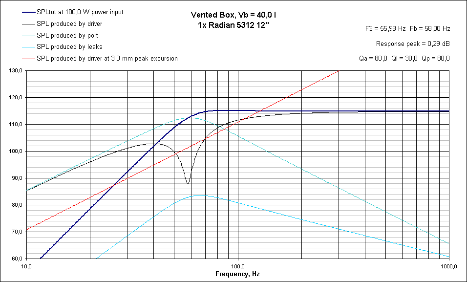

I am trying to design a monitor cabinet similar to the Microwedge (www.microwedge.com). This is a ported wedge shaped cabinet which is intended to be used by musicians as a vocal monitor. My plan is to power these guys with www.speakerpower.net 2 channel amps using the built in DSP crossover.
I already have the Radian Audio 5312 12" coax driver and am starting to get familiar with Thiele-Small parameters and the various box calculator packages out there, WinISD and http://www.diysubwoofers.org/ amongst others.
The trouble I'm having is some very strange results with all of the utilities I've tried that show near zero response below 200hz, yet I know that can not be right. I have tried different net volumes, port tunings and everything in between, and I still get general weirdness.

Hi Simon,
you happen to live very close to me.....
The numbers you supplied make perfect sense, so I plugged them into the Unibox spreadsheet by Kristian Ougaard.
Looking at the vented box output we have a box volume of 40 l, Fb=58Hz and a nice response curve down to 56Hz (-3dB). Did you take care of putting the metric equivalent of Sd into your programs? I just assumed 440cm2...

Hi Folks,
I finally had some time to play with this design again and figured out that I had entered the Qts wrong. I had 0.036 instead of 0.365. Made a huge difference. (It's always the dumb things that trip you up) Now it is behaving more like I would expect.
After some fiddling around with various alignments and box volumes I have arrived at a modified SC4 alignment, 36.7 liter net volume, with 2 3"x5.44" ports tuned to 62 hz. This gives me flat response with a -3db point at 65hz. Perfect for my needs.
At full power (500 watts) it looks like I'm going to exceed my Xmax at 90hz, but I tend to HighPass at 100hz for this application and will probably never drive them that hard, so that should not be a problem.
