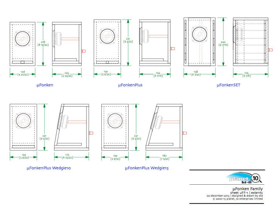

I use the Fostex PM0.3dH monitors paired with the PM-SUBmini2. They are very small (100x185x130mm) and easy to place at monitor sides. A few months ago I've bypassed the internal amplifier of the monitors and now I use them as passive speakers driven by a low power class-A external amplifier. I noticed a improvement of the sound, and the setup is working better because I don't need to reach the controls at the speaker's back anymore. The internal crossover is very simple and I am planning to duplicate this setup by sourcing the drivers only and build a custom enclosoure. I wonder if a documented project with comparable size and Fostex drivers is already available, or if I will need to open the monitors again to check the driver's model numbers.
Those are tiny. These are the dims of our smallest set (for FF85wk, Alpair 5.2/3). Add a woofer (plans for some included) and they make really good hifi, both are quite articulate, they might do the job (of which i am not all that familar in practice).
