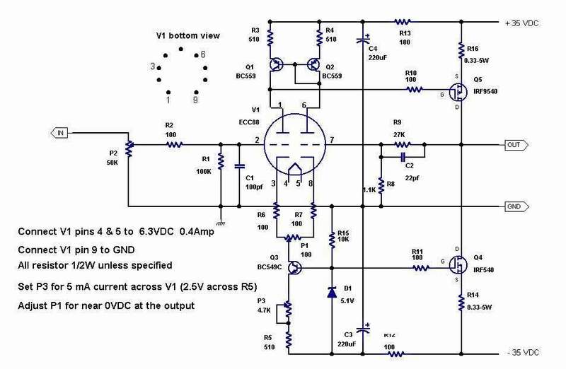

3. I also submit 1 design, quite low voltage. I havent tried it yet.
So there are 3 designs. Which one is the best according to you, elders? I'm not looking for designs that is excellent in lab figures, I'm looking for a design that is nice to listen to.
What do you think about these 3 designs? Are they give certain inferiorities compared to 250V designs?
Other question. Can I use 12AU7 in design no.2? Can I use +/15V in design no.3? I havent built anything yet.

Geez, you got all those transistors in there, what's the point of the tube? Better performance with all transistors at this point. ( 🙄 )

This circuit looks familiar. I think I've run across it on the web somewhere before.
I also vaguely recall that John Broskie (I may have misspelled his name, if so, I apologize) did an analysis of the circuit at www.tubecad.com. A wonderful site, by the way. Everyone, even solid state fans, should take a look at his site. At any rate, look through back issues of his webzine, looking for a letter from a reader about this circuit, or one similar.
In the meantime, my take is that this is one of those things that, while it can be done, you have to ask whether it should be done. There's little or no benefit to be had in treating a tube as though it were a transistor or vice versa.
The operating point for a tube is so constrained at low voltages that it's going to take a zillion dB of feedback to get anything like a decent waveform out of the circuit. Even a relatively high gain tube like the 12AX7 (mu=100...quoting from memory, so don't take that number as gospel) will not give you enough gain to do a good job when operated like that. Besides, why design a tube circuit, only to turn around and run it with gobs of feedback? Ugh. So you're left between a rock and a hard place. If you choose to run a tube at low plate voltages you're going to have horrendously high distortion figures--it'll be a sort of harmonic generator. The only way out of it is to run more feedback than the law allows, which will also ruin the sound, though in a different way. The circuit is not exactly what you'd call a good ambassador for tubes, which are capable of some of the most transcendent sound available in the realm of reproduced music.
Given the rail voltages in the circuit, I'd suggest using something like a pair of MPSA18's (a nice, low-noise bipolar transistor) instead of the tube. Maybe MPSA42's. Otherwise, I'd pass on it.

> lumanauw has attached this image:
Tubes are working at nearly 35V. The plate swing needed to drive Q5 may be less than one volt (depends a lot on the FETs and the load). The two tubes work as push-pull through the Q1 Q2 current mirror, doubling the output. At 35V supply, I would call this "borderline" between high-volt and low-volt operation. I would expect it to have some "Tube Sound", however the MOSFET Gate characteristics will add distortion and roll-off the treble feedback so it won't sound quite like any other tube amp.

Thanks Mr. PRR for such a detailed answer about my original questions. Maybe some people like pictures better, so they do not pay attention to the design #1 and #2 (as I only described on words), and only focus on #3, as it has picture.
For your knowledge, I'm not familiar with tube designs. I actually dont know exactly how tubes works. My background in audio electronics is Transistor based.
The argument that you say is very intersting to me. If I'm catching you right, tubes can work to low voltages (12VDC) in clean distortion, only we dont have enough swing. Is this true? Why some people told me that in such low voltages,the distortion will be huge? I've tested the commercial unit with design of #1 and #2, and I dont hear excessive noise, hiss, distortion (that is why in my first post, I asked wheter this "excessive distortion" is audible or not? Because I dont hear it in the existing unit.
So your explenation make the most sense to me.
The reason why I want to built tube based preamp (or have tube in its path), is to get the "tube sound". I also not sure is the term "tube sound" is the same for you and me. For me the designs #1 and #2 have already gives the "tube sound", which is warm, and nice to listen to in a long time of listening to music. Transistors cannot do this. But from your answers, you said that in such voltages, I wont have that "tube sound". So is it the same "tube sound" that we are talking about?
You are right. #1 and #2 designs are not intended to have voltage gain on it. The complete design has other device before and after them that works the voltage gain. So I agree with you that those designs are only "passed thru" to give the "tube sound?"

Mr. PRR, what do you think of my design above? Will it give the tube sound that I like? If I built it without tubes, I only make an ordinary op-amp based preamp, without tube sound.
Since I will use 2 of the buffers, will the hiss sound be excessive? If you say it will be excessive I will only use 1 tube buffer (I will design only 1 tube for stereo). But if you say the hiss sound wont be a problem using 2 tube buffers, I will make the pcb 1 double triode for 1 ch (2 tubes for stereo)
But back to your experties. Which tube buffer will be the most suitable for the planning that I tell you? Will it be #1 or #2 design. Please tell me how do you choice between #1 and #2 for the planning that I make above.
When I hear the units available, I somehow hear the #1 sounds a little nicer than #2. But I maybe bias here, and moreover maybe the nicer design is not suitalble to my plan-design. So please comment on this, Mr. PRR.
