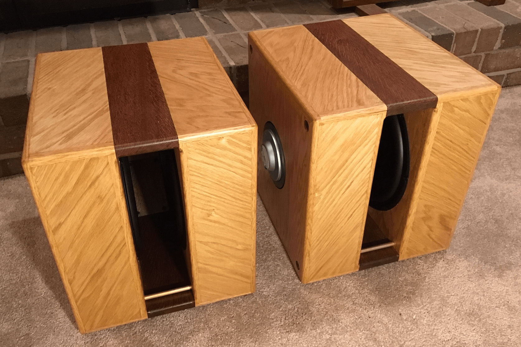

Pair of RSS210HO-8 would do quite well.
I have four RSS210HO-8 drivers, two in each cabinet wired for 4 ohm stereo. In my room they go to 18 hz -3db.
How about such a ripol beauty?
Its jazzman's and he made a more plain, easier version with same sound.
http://jazzman-esl-page.blogspot.com/2011/01/ripole-subs-are-underway.html

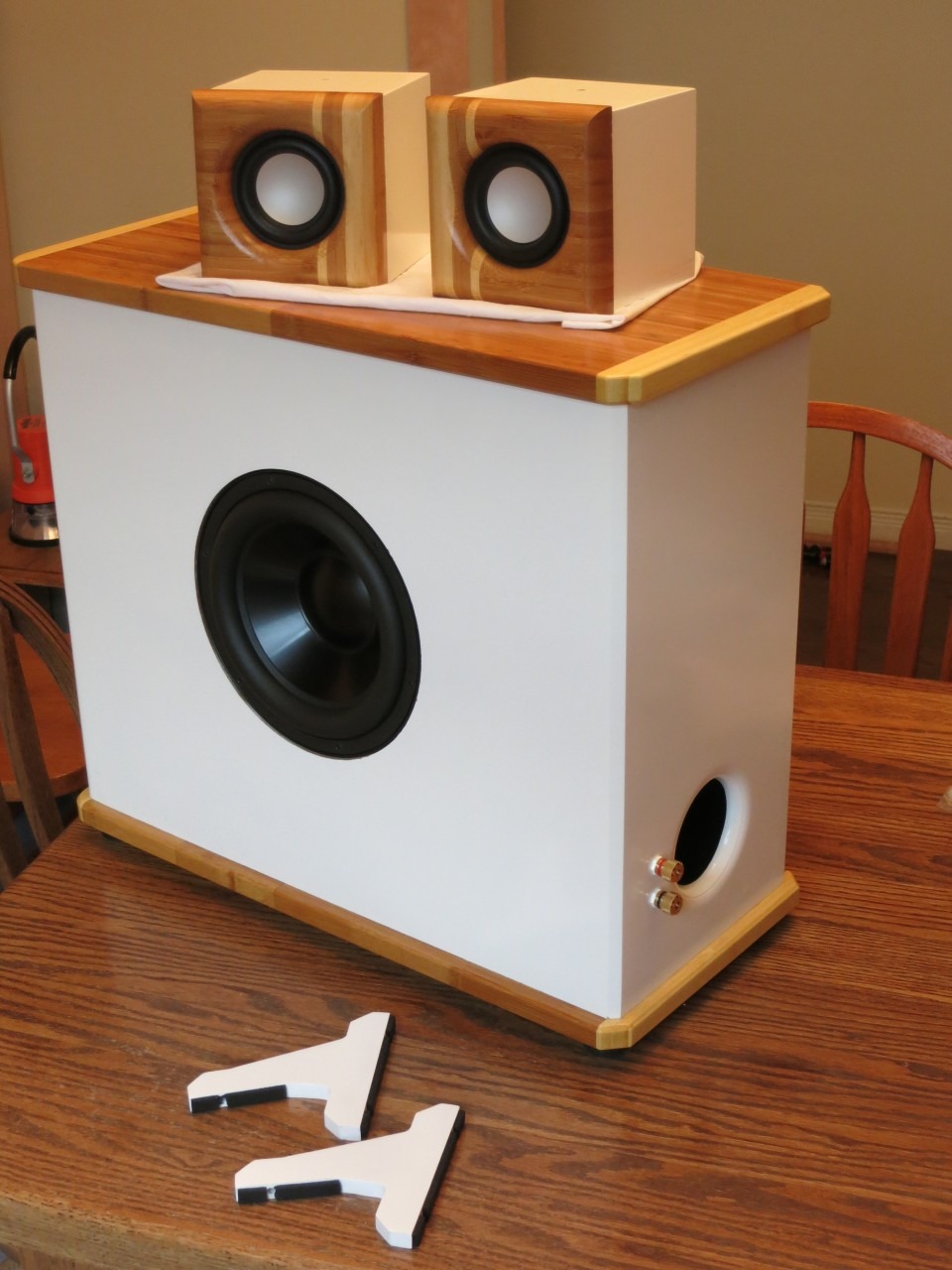

Another vote for Dayton. In my case essentially the "Burro" design linked below, RSS210HF-4 in ~30L/25Hz with 70W originally built for a 2.1 music system. Low and clean at sensible levels... It got repurposed to temporary HT duty after we moved, but still going strong for 10 years now.
https://techtalk.parts-express.com/...ncha-sub-designs-for-the-rss210hf-4#post40208

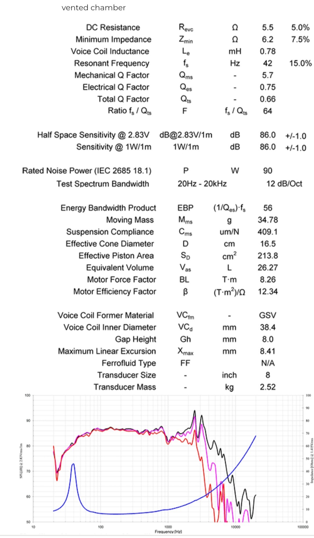

I don't know how low the distortion is with the Peerless driver but, with the RSS210s I have, I am getting below 3% from 23 hz up and below 1% from 31 hz up at 95 db from 9 ft ( 3 m ) away.
I am using two in a 1.3 cubic ft box with two 12" passive radiators. I believe they are the Dayton DSA PRs.

With push-push reaction cancelling opposed pairs, the 8 ohm versions are more suitable for parallel operation. Works a charm.
https://sbacoustics.com/product/8in-sb23mfcl45-8/

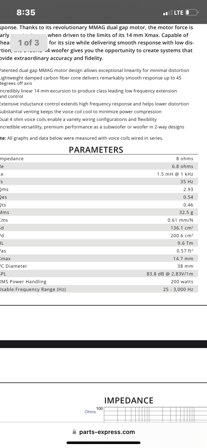

Could you share some info on these? Thanks! I have the same drivers to work with, and I'm wondering how to configure themI have four RSS210HO-8 drivers, two in each cabinet wired for 4 ohm stereo. In my room they go to 18 hz -3db.
It leaks air right through the cone so you’ll never be able to achieve a sealed alignment
