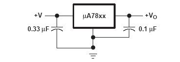

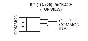

I would use an LM7812 (or LM340T12) as it is simpler to use and much cheaper than the LM338. The motorized pot does not draw very much current.
http://www.national.com/pf/LM/LM140.html
Yes, the question is how much current is drawn by the entire circuit (including the pot and relays). If it's not too much, paulb has a point.
Milan

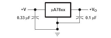

Ok I think I got it. Please check if i got the resistor values right.
As I see you are from Croatia, LM338 is expensive could you suggest a replacement from Chipoteka 😀
Is LM350T ok ?
The resistors are OK.
You may replace the LM338 with 7812CT TO3 or 7815CT TO3 (2 EUR in Chipoteka) if you wish BUT then you would have to use a different schematic!
Milan
EDIT: Yes, LM350T is also fine.
