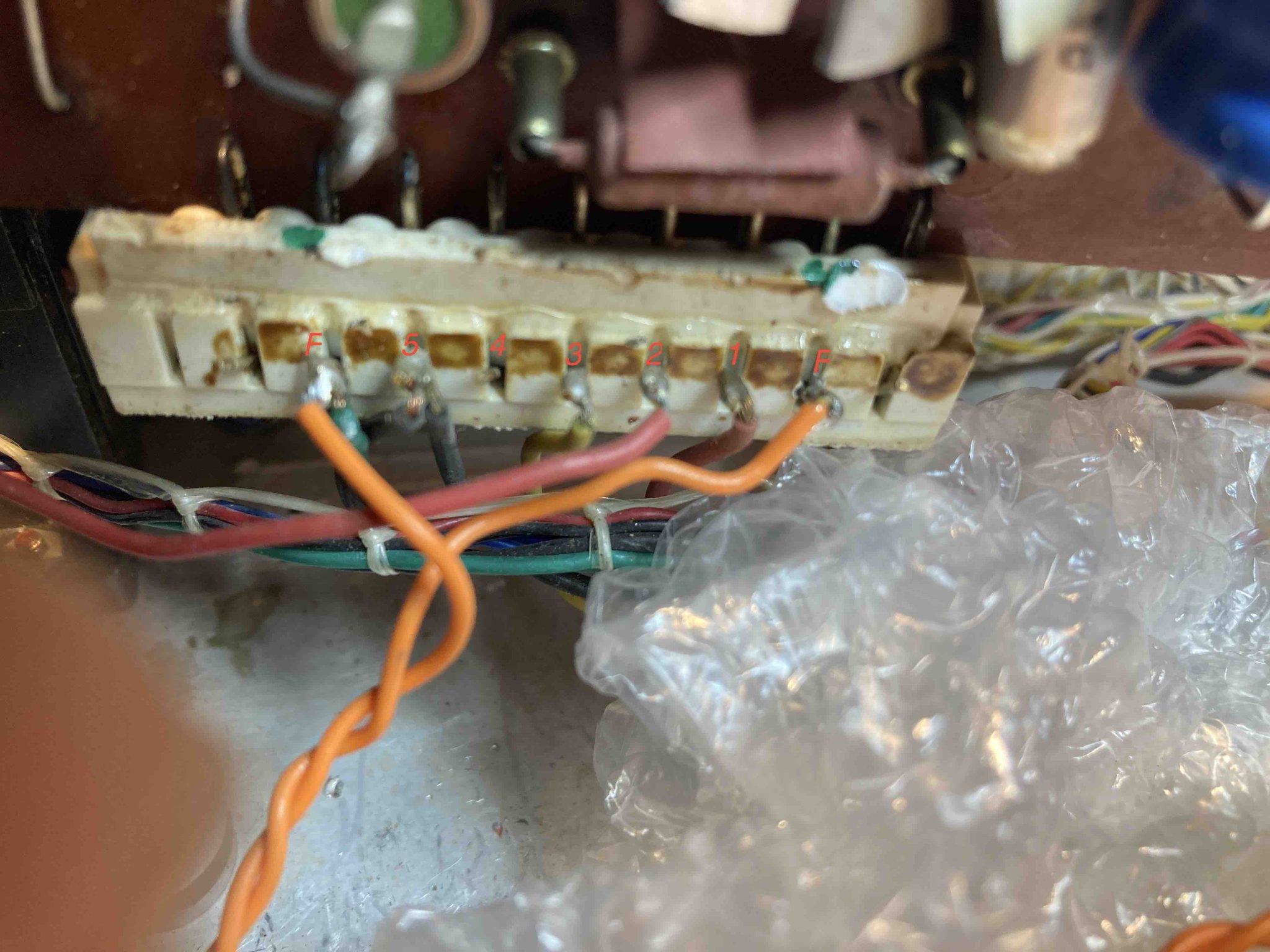

The wires are as follow: Wires from left to right
Orange from transformer, green???
Black
NC
Yellow
Red
Brown

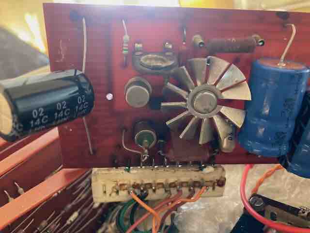

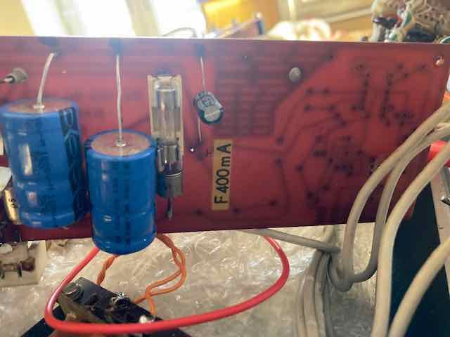

Apologies for delay, been preoccupied with other stuff. Here are some pics of the PSU. I thinking I'll make a new one using perf board. A new bridge rectifier and some voltage regulators. Any thoughts? The exisiting board has some interesting componants which I've never seen before!

First measure voltages. Exactly the advice by Tarzan. First if AC is at the board and then the rectified DC voltage. If you have AC but no DC it may be a defective rectifier etc. If you have rectified and filtered DC but no voltage after the regulating transistor then that one may be defective.
Not familiar with electronic musical instruments but I have heard a few times that changing/modernizing devices may lead to it measuring better but with different sound. It maybe is essential to repair the original PSU.
Wel, disconnect the power supply board from the connector.
Switch the unit on. Is there AC on the connector?
If yes; voltages are ...
Switch the unit off.
If they are as expected, connect the AC with some wires to the power supply board when it's still disconnected from the connector.
Switch the unit on.
Do you have any DC voltages?
If not repair the board as explained by Jean-Paul.
Let us know...

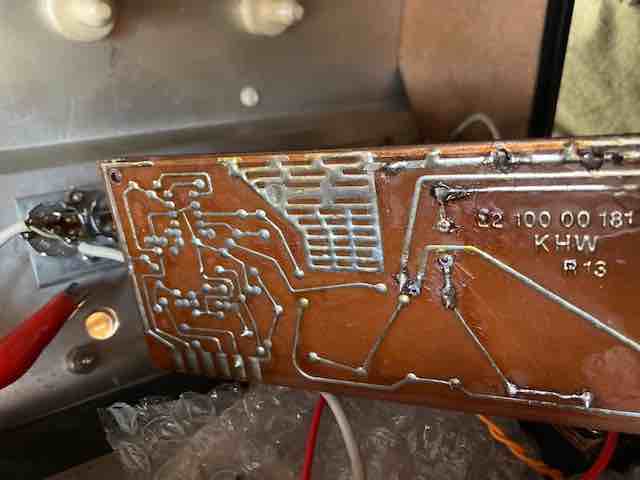

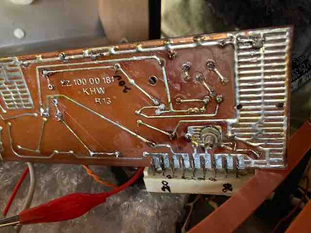

I have voltages. Basically, its a 220 to 20 volt AC/AC then rectified to +20, +12 and +5. The tempo light and tempo control seem to work. No sound comming our of jack so will start with drum cards and see which if any are woring then move on to amp. My gess since there's globally no sound it's the amp. I'll keep yuou posted.
So the psu board is ok.
Now, test each board, one by one, and make sure it's ok.
Allways connect one board at the time and test it.
Then remove it from the connector and use another board.
Do this until all boards are tested and found ok.
Reassemble everything and it should work.
Unless some wires are disconnected.
