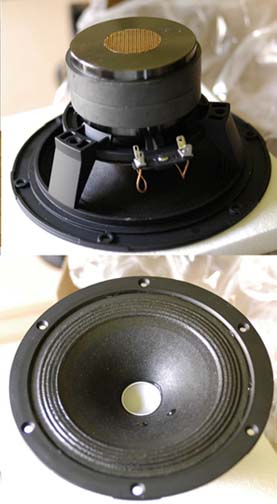

I wanted to put a little info together on the Veravox 7x I received. In a nutshell, I’m impressed and glad I took the leap.
I’ve had them running in for a week and a half, but have to say that they are the first speaker I’ve had that have sounded great out of the box. A little boomy at first, but that subsided after just a couple hours.
I have them mounted OB, with an LCY-110 on top, though have to admit that a supertweeter isn’t an absolute with these.
They don’t make a lot of low bass, but plenty to get down to sub level. I think I have mine rolling in around 60 hz or so. Baffle is about 30” x 48”.

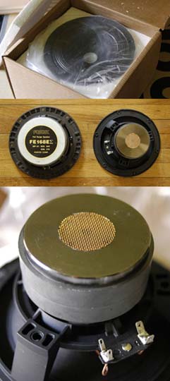

The first thing I noticed when I hooked them up was that my soundstage that had disappeared with the 168E Sigma and 166ES-R came back in spades. It was almost scary, like I had hooked a SET am back up.
I’m not sure what it is that makes them so special, but perhaps the lack of whizzer cone or vented pole piece? I’m not sure. They are well built, though the cast frame isn’t quite as beefy as the Sigmas. Compared to the Fostex, these seem to be a different line of thinking.
You’ll note that they do have a double magnet assembly. I’m not sure if it’s two magnets working together or shielded, but not sure I care too much at this point.
I took the opportunity to turn them up a little the other day, as the neighbors were out. I was blown away and how clean they sound. Really nice and undistorted. The LCY seems a tad less efficient, but when turned up, they seemed more inline. Right now, I have 1.72 uf worth of caps on the LCY and they sound pretty good. I will experiment with that more in the future.
I am posting a grouping of picts below. A pretty sharp driver that I think can hold it’s own at it’s price point pretty easily, though I’ve hardly heard everything.

A VERY nice driver.. Had I know these (and the 5S and 5X) were still available then I never would have purchased the 166 ESR's. (Hmm, perhaps I should lop-off the whizzer?)
Illusus said he took his off and found they deliver quite a bit more detail. Note that he's using the phase plugs from Dave, (planet 10) as well.
Phase plugs first. Think about cropping the whizzer later. Bit drastic, that. (Says me -a person who dislikes whizzers)
One more note, removing the whizzer removes a lot of treble. Illusus said he think it rolls off somewhere around 7k.

Dan...I'd think that with some design, the 7x would work out well. I find it very balanced on OB, so I think it would need some breathing room in a BIB. By guess is it would have to be fairly deep and the driver somewhat down in order for the magnet to fit and the vented pole to, well, vent.
However, I'm no pro here and I don't totally understand how the vented pole piece impacts the sound. Nor do I understand just how much room this requires when putting it into a box.
