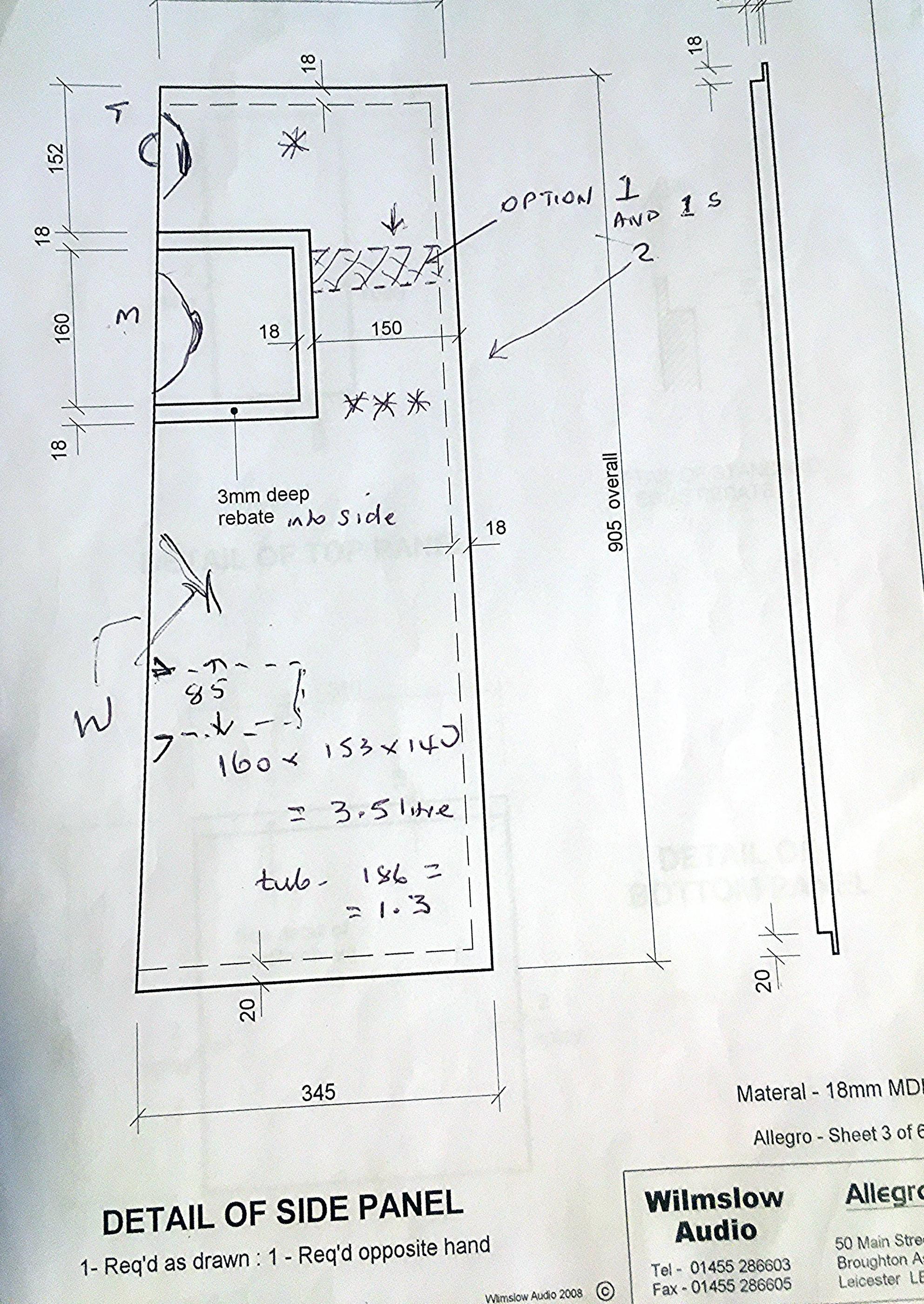

I am glad I found this thread as it may answer (or not) a problem I have run into trying to amatuerishy design my own speakers from the Wilmslow Audio Allegros and a recent aquirement the Mission M71i.
ALLEGRO
My intenton was to use the mission as midrange and possibly its tweeters to go in the Large Adagio cabinets. These have a midrange sealed enclosure of approx 7.5 litres. Slightly smaller than the Missions .
Meanwhile I have been using the Mission alone and slightly tuning the bass / treble balance along with better pp capacitors and dueland resistors, When I upted the 2.2 r to 3.3 it was a much better balance and I l know I now should be revising the xover slightly...
I could also reuse the Morel mdt31 instead..
Just NOW I tried plugging the two ports on the missions to a devastating effect. ie flat dull under dynamic vaues lost imaging etc..
It occurs that this is what may happen when I actually insert the two 5.25 midranges into the cabinet....using the same port size and length as the Missions,
I Intend? to eventually add bottom end crossover for the Volt 2208s ie 2nd order to balance out the speakers to a fuller range. ie 120hz ish.
This means I have two large cubic areas behind my (currently unconnected for now ) Volt 2208 which would be only for 150hz and below..
The question is ? Can I just port my midrange enclosure into this void ?? It is easier by far for me...? Also Would this have an effect on the existing lower port performance?

I will try to post diagrams of Allegro assembly and xover pictures and its design ? I am curious about 5.6uf and series 2.7 resistor accross the midrange in adition to its second order filter...

Its now even possible for me to transfer the input board mounted crossover into the Allegro input. (photo will make it clearer than my description.)

IMG_3107.JPG - Google Drive
OK I am beginning to see I created a nightmare for myself.
Firstly The volume of my internal box is a lot smaller that I expected...Probably about 3.5 litres. I pressume this will be too small even prior to decide on porting BUT I am now considering the only simple way to resolve this is by cutting a hole (or two) and going rearwards to back wall of the speaker either to outside or just rear wall or one of each. this will bring free space to near 6 litres. Enough ???
Ok this sounds like desperate thinking ?
From DIY point this is may be easy enough for me...30mm tubes ? This will only resolve the problems partly? Perhaps I should got this far and have a listen?..
The second choice is to take a similair hole just into the top inner rear cabinet and use
foam to create a vented path behind the tweeter .
Again slightly easy to do as I have access through the tweeter cut out.
This gives me a cubic space almost triple the existing design less the foam volume
This may indeed be the first option ?
c. Now the next alternative is to go downwards with a pipe of 30mm length 500m? into the bowels of the speaker.
not liking this but again easy access through main speaker hole.
again helllllllllllllllllllllllllp
Dave

If the Morel CAQW538, it is has a Q of less than 0.707 in a 3.5 litre box so that is certainlty a suitable volume for use as a mid, response (for the XO choice) is in th elow 90s so typically one would choose an XO a couple octaves higher, ie 350 Hz.
The shape of an enclosure that small can be an issue, best to use something like X’s dagger mid, misTweeter enclosure.
That little woofer looks nice in a 6 litre miniOnken, response to the low 40s.
