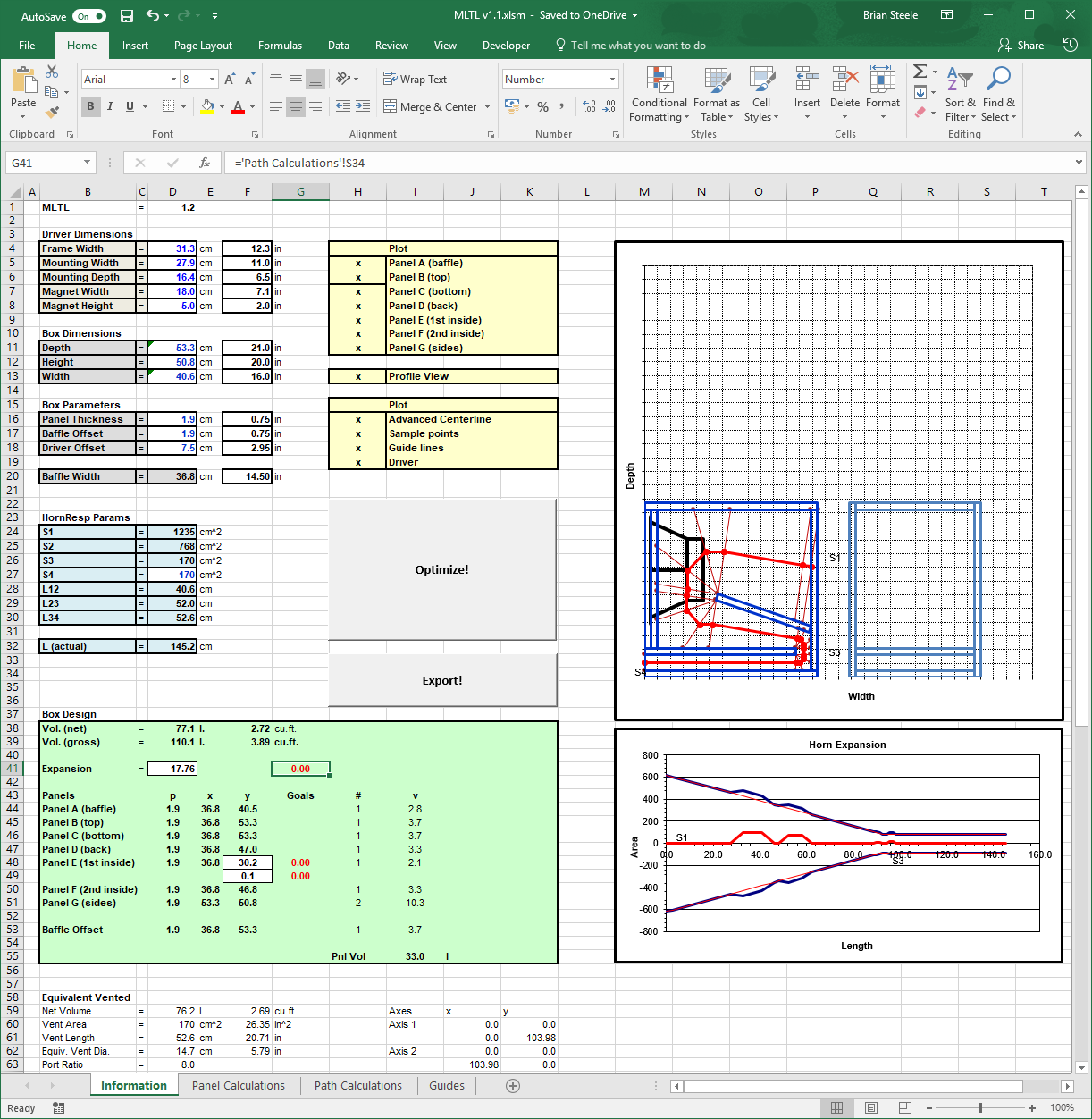

I spent a few minutes tonight having a look at what might be possible with a larger box, in this case 77 l net, 110 l gross. Fb should be around 30 Hz once the box is lightly stuffed in the large section behind the driver, and the vent has a CSA of 170 cm^2, which meets the 1/3rd Sd requirement. The aspect ratio of the vent is a bit high though at 8:1. If I have some time tomorrow, I'm going to mod the spreadsheet to include a bifurcated vent option to see if that improves things a bit.

In any case, I've gravitated towards MLTL type layouts because they offer a bit more flexibility and you can actually fold them up into a box and have the driver mounted at the distance you want it down the path without much difficulty, and you can get the driver and vent on the same panel. There's still a bit of vent geometry mismatch, but not as much as the TQWT.

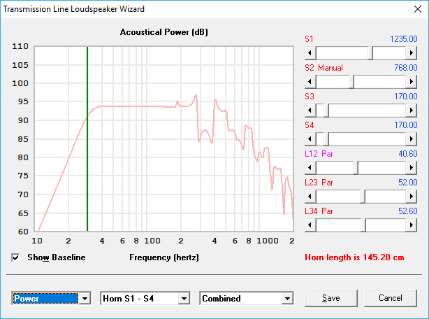

I've attached an idea that I'm playing around with at the moment that is both MLTL and attempts to deal even further with the vent geometry mismatch issue by using a "nozzle vent" that has a symmetrical entrance and exit. Is it going to make a difference, and is that difference going to make a difference? I guess there's only one way to find out... 🙂

To me, for descriptive purposes, a MLTL is a vented constant taper [pipe] TL whereas yours is a modified ML-TQWT since it has an inverse taper and expanding [horn] vent. This type vent historically was designed as/called a 1/8 WL horn.
Better overall IME to make the initial inverse expansion shorter and the vent/horn longer, though if all you're primarily interested in lowering vent mach, then never mind. 😉
